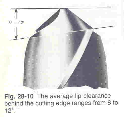

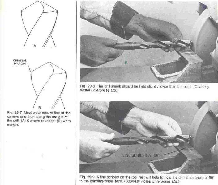

All those gimmicks are to slow. Learn to do it on a bench grinder. ;)

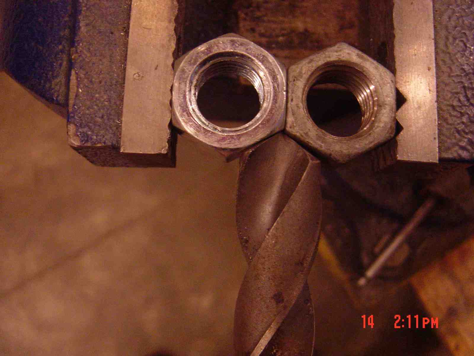

WOW! $180.00 for that, plus shipping. I think I only paid $39.00 for my bench grinder, and it'll do tungsten as well. ;)
