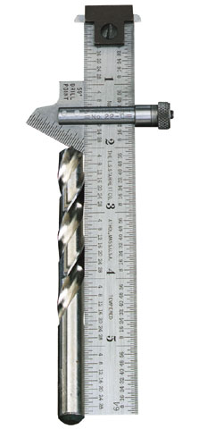

For hand sharpening a drill gauge like this can help keep your cutting edge angles correct and centered. One of my first projects in school was making one. I dont miss the filing and polishing one bit.:rolleyes:

Thankyou that was a very good read !
As an example, craftsmen assume that the 118 point is a good compromise or general purpose point for drilling a variety of different metals and this erroneous information appears in machine shop textbooks. Varying the point angle has nothing to do with cutting action. The 118 point is pure myth. In reality, a compromise between high and low lip clearance angles is the determining factor for a general purpose cutting tool, NOT the (non-cutting) point angles !
Like I said earlier, someone that has a drilled a few dozen holes in their entire lifetime, and states that a certain included angle is gospel, is pure BS IMHO !
