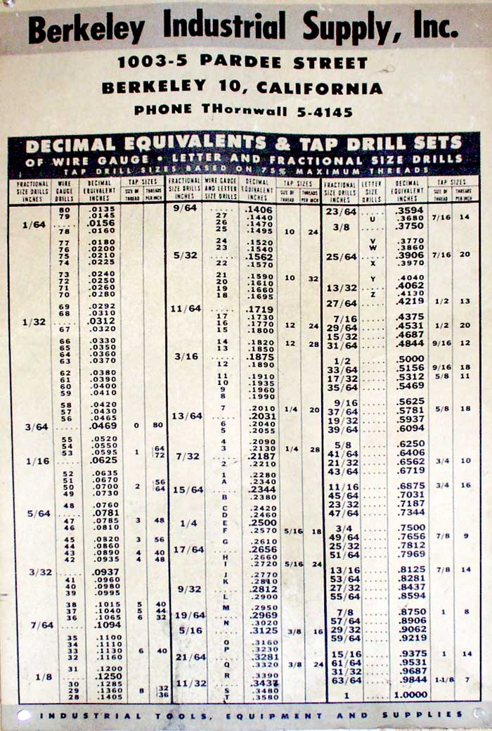

That is the same poster my neighbor has in his shop garage. He's a transplant from the LA area. Works for the remnants of Fairchild Aerospace. We used that chart a couple of weekends ago working on a project. Too cool!!

Thats an old phone #. I think those type of numbers came after, picking up the phone and saying "Margaret can you get Sams feed store please".
Doug T B1700 TLB
/ Drill Bits #23
That's not an "old" phone number. We were still using that kind of number until just recently; at least until the late '60s - or was it the early '70s?/w3tcompact/icons/wink.gif

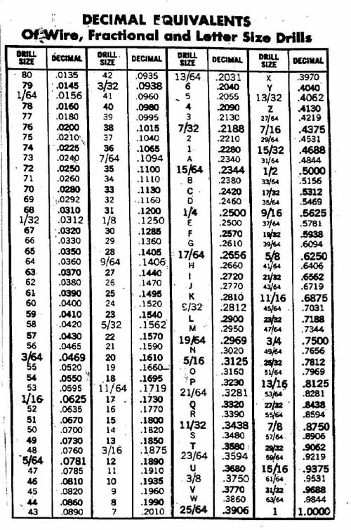

I use the same approach as Egon and like this set form TSC. $20 for a set of Titanium Nitride coated bits. I also have the 9/16 to 1" set from Karbor Freight.
To make them last, the most important think is correct cutting speed and lubrication. Cutting speed is how fast the tip of the tool travels. Units if feet per minute and I run high speed drill bits at 100 FPM. To determine RPM, divide 400 by the diameter of the drill. Most people run larger bits too fast and small bits too slow. !/8" bits I run at about 3200 rpm, 1/4" at 1600 RPM, 1/2" at 800 RPM, 1" at 400 RPM, etc. Use this. It works.
Use plenty of oil. I have a plactic cap from a paint spray can with oil in it. After I touch off on the center punch mark I put the cap up to the drill bit (with drill press offf) and it puts oil on the tip.
For bigger hols, go up in steps. Except for hole saws.
For holes larger than 1" iuse hole saws. I recently cut 1 3/4" hols in 3/4" plate with quality hole saws. I like Lennox or Starret hole saws.

Thanks for the great advice. I will print these RPMs and post them on my drill press for reference. My drill press has an oiler on it. Nothing fancy but it keeps the bit well lubricated That makes it easy and I know this helps a lot. Thanks a lot for the advice...I know I will use it!
