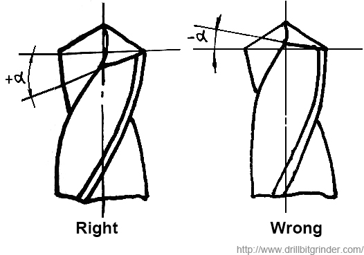

I'm the OP. I have remodeled and worked on many projects, so I have a little experience using drill bits. The drill was set to the correct speed, it was being used on pine and oak, it was set on forward, it was not in an awkward position, etc. This happened with several different sizes of the bits. These were simply the worst drill bits I have ever used.
/ Drill Bits #51
Seriously, I suspect the clearance angle was ground in the wrong direction.
The-Check-of-Standard-Twist-Drill-Bit-after-Grinding-Eyeballing-lip-relief-angle-of-the-outer-ed.jpg
