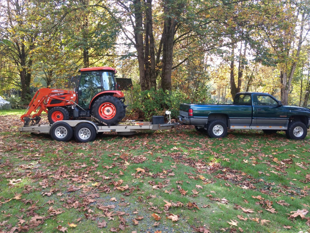

The tractor got dropped off yesterday morning for repairs to fix the "who knows whats wrong with it" issue. Friday night while loading it on a trailer I noticed that if I took my foot off the brake the engine revved up to 1600 rpm's. I put my foot on the brake and sure enough, it dropped back down to an idle. The throttle lever was partially forward when this happened and the CEL light was on. Normally the CEL light would come on and the motor would drop to an idle and the light would go off. I showed this to the mechanic and he was surprised and had never seen anything like that before. "A note on regen's." I mentioned the regen cycle to him. He stated that if the tractor is run at a higher rpm that the regen light should never come on. I told him that mine had only come on once since I bought the tractor. I told him that I normally run between 1600 and 2200 when using the tractor except when using my chipper or mowers at PTO rpm's. He said that is fine. He said that these tractors are made to run at higher rpm's to keep the exhaust clean and that I never should run it at slow rpm's. Now the waiting starts for the problem to be solved so that I can haul in some trees while the ground is frozen. The dealer was really nice and his son had just come back from Kioti training.

My local dealer found that my "hand lever accelerator" was faulty. He called Kioti about it and they agreed to cover the cost of the part under warranty. My 2 year general parts warranty had expired in September. I have to eat the diagnostic work and labor to replace it. The part is just under $500.00. The part should be in this week.
