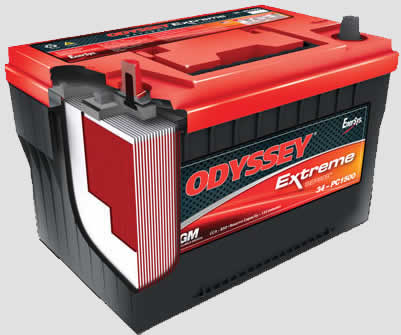

Far as I'm concerned, batteries are consumable parts. Having said that, I'd loose the OEM box and replace it with an AGM of any brand. They don't leak. Optima and Oddsey are overpriced for general use.

You could get a AGM battery, but there is no real need to do so. AGMs have their place, and higher prices than lead acid batteries, but a good quality lead acid battery will also suit your needs.

After reading this, I'm just going to start transitioning to the AGM batteries BEFORE I have a significant battery acid event.
I don't want to deal with this kind of damage and clean-up.
