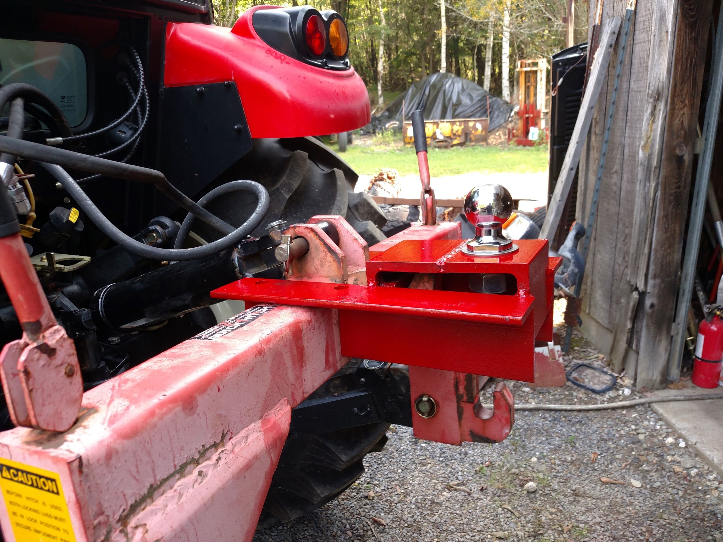

I am guessing that you are referring to this type of "drawbar"
The lower bar in this picture is the actual drawbar.
When using a pull point attached to the 3 point just be aware that there is NO hold down force in the 3 point assembly.

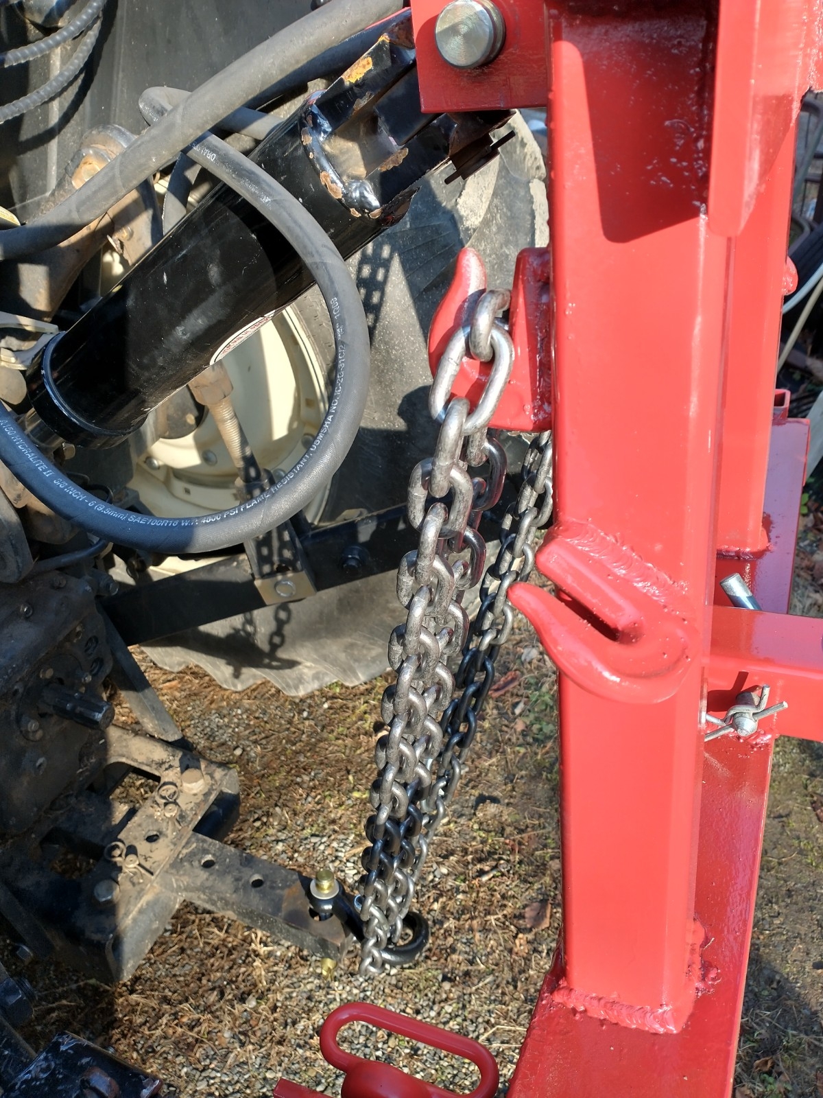

While 3 point hitches are handy and versatile they do require one step often over looked, a chain or other travel limiting device needs to be used to prevent trailer loading from lifting the drawbars and raming things into undesired locations such as fender and fuel tanks.
In this picture at the bottom of the picture you can see the clevis attached to the tractors drawbar and to hooks in the hitch to limit upward movement.
another view showing the chains getting tight at the top of the 3 point lift

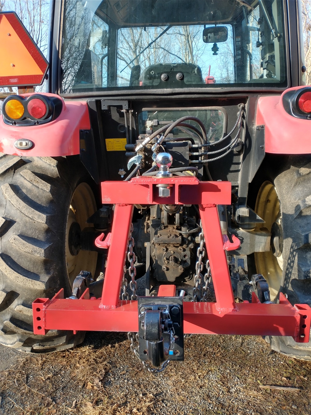

That's a good looking, useful, well-designed 3-PT 'towing accessory' as I've ever seen (much better than the old HF one I'm currently using). Any chance you have a link to where one might find more information about it?
Thanks in advance...

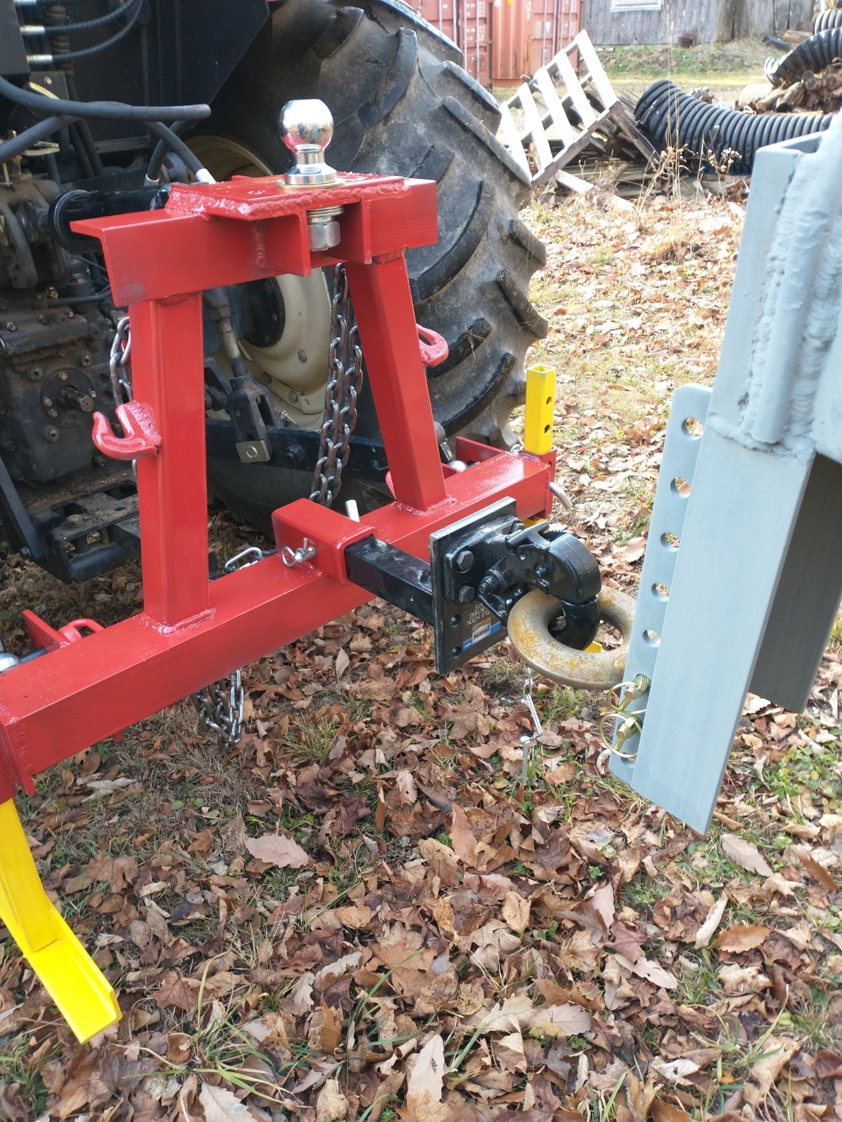

What would you like to know. It was my second design for a three point trailer hitch.
My first was just a ball for a qooseneck on a quick hitch and we would wrap a chain around and down to the drawbar for safety
This was the second build for handling most all trailers, the yellow legs are just pined so they are easy to remove or repin with the base higher in the air. They can be removed or left on as desired and they also help hold the hitch up for hooking up to the tractor with or without a trailer attached.

I pull a 30-foot gooseneck trailer that weighs 6,000lbs empty with both my L4060 and MX6000 tractors, using the simple 3-point hitch attachment pictured earlier in this thread. That attachment uses the lower arms and upper link so the hitch cannot spin around, with the GN ball on the top. Like the unit pictured, it also has the 2" receiver and the bale spear holes. Mine is extremely heavy duty and works very well. The trailer behind the tractor usually gets loaded to about 10,000 lbs. I stay off hills as the trailer brakes won't work with the tractor. There's no worry of the 3 point going up too far because using the gooseneck you are almost using all of the upward travel anyway. The nice thing with this attachment is you can back right under a trailer and lift the ball into the trailer.
There is no limiter built into the tractors 3 point to stop the arms from lifting from an external source. The hydraulics will only lift so far but the arms can usually be forced past that point easily.
My experience with 3 point moving trailer…level ground ok or back down the hill. I almost ended up dead. If it weren’t for the tail of the trailer digging in when the trailer pushed the 3 point to the top of its travel, broke the ball and started up over the tires (towards me) I wouldn’t be here to write this. It happens fast beware.
Which is why I always recommend a chain from the hitch down to a solid part of the tractor to prevent the three point from being lifted past it's design height.

I was hoping it would be an item I could order online. Nicely done!!!
A lot of you fellas (and gals?) on TBM have lots of talent, common-sense, and wisdom on full display. Thanks for sharing your ideas with us less worthy, non-welding, tractor rookies...
