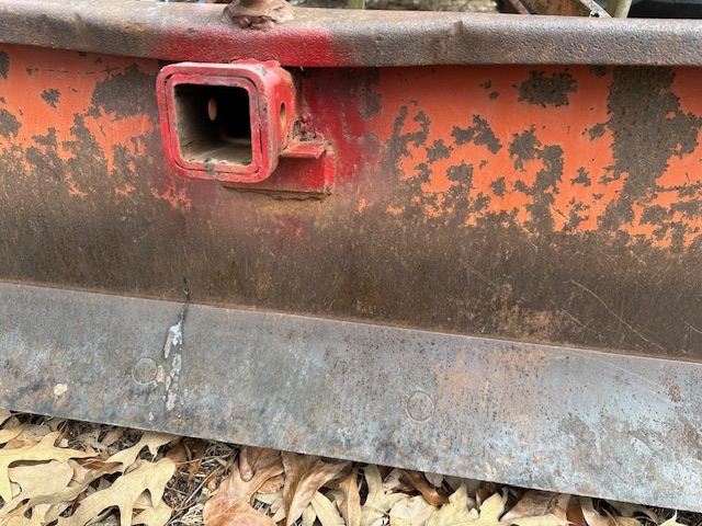

I agree a dedicated trailer mover put on the 3 point is the way to go. I made my own and I use it to move my GN trailer around.
One other reason to use an upward limiter of some type is that you can dump a dump trailer without the hitch raising up.
But since it seems like there is always a need to move a trailer around I also notched a square hole in the upper portion of my box blade and welded a tube into it so I can use a standard ball mount in it. I wouldn't use this for a heavy load, but when I'm moving the log splitter or small utility trailer its nice to do it without having to switch out 3 point implements.
r.
