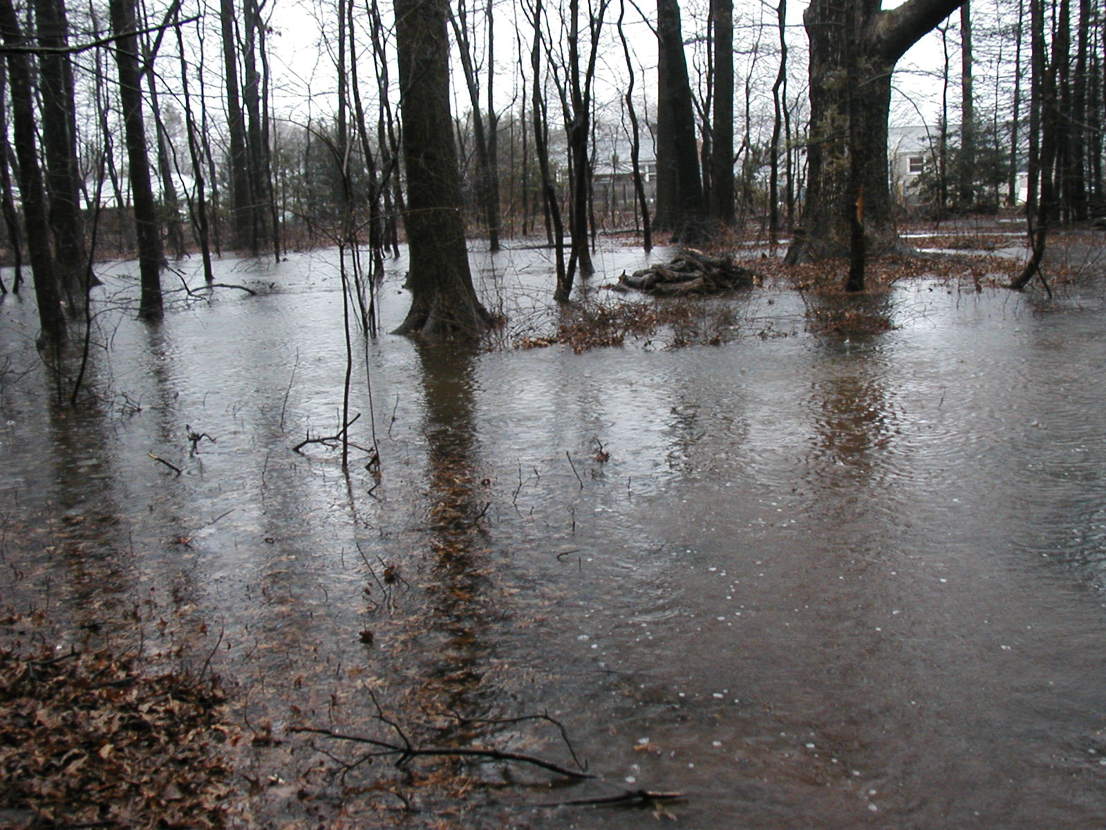

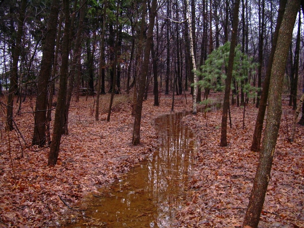

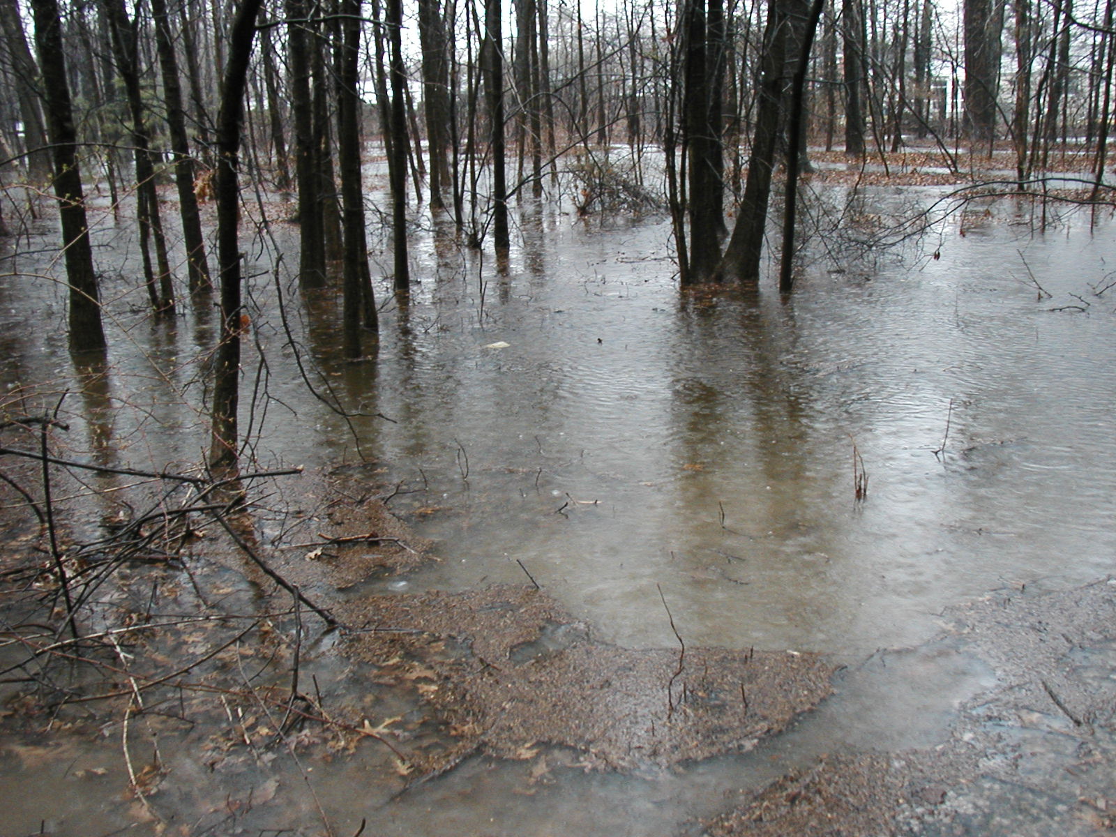

Well as far as the original problem goes, like I mentioned, I would use the water in the flooded ditch to show me exactly what to do.
Just get in there with some rubber boots and a grub ax and start cutting a channel. if it's pretty obvious what needs to be done, leave it diked in one spot so you're not always working in mud. then when you think you are close, open it up and let the water flow. it'll show you what else may need to be done.
I approach every water control situation with "the lowest common denominator" mentality. wasn't trying to complicate things :)

That's just too much common sense :thumbsup: I have done the same, depending on the soil type, saturation, working in a puddle, can make the digging easier.
