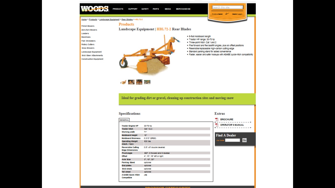

Again, weight and tail Wheels are your friend :)

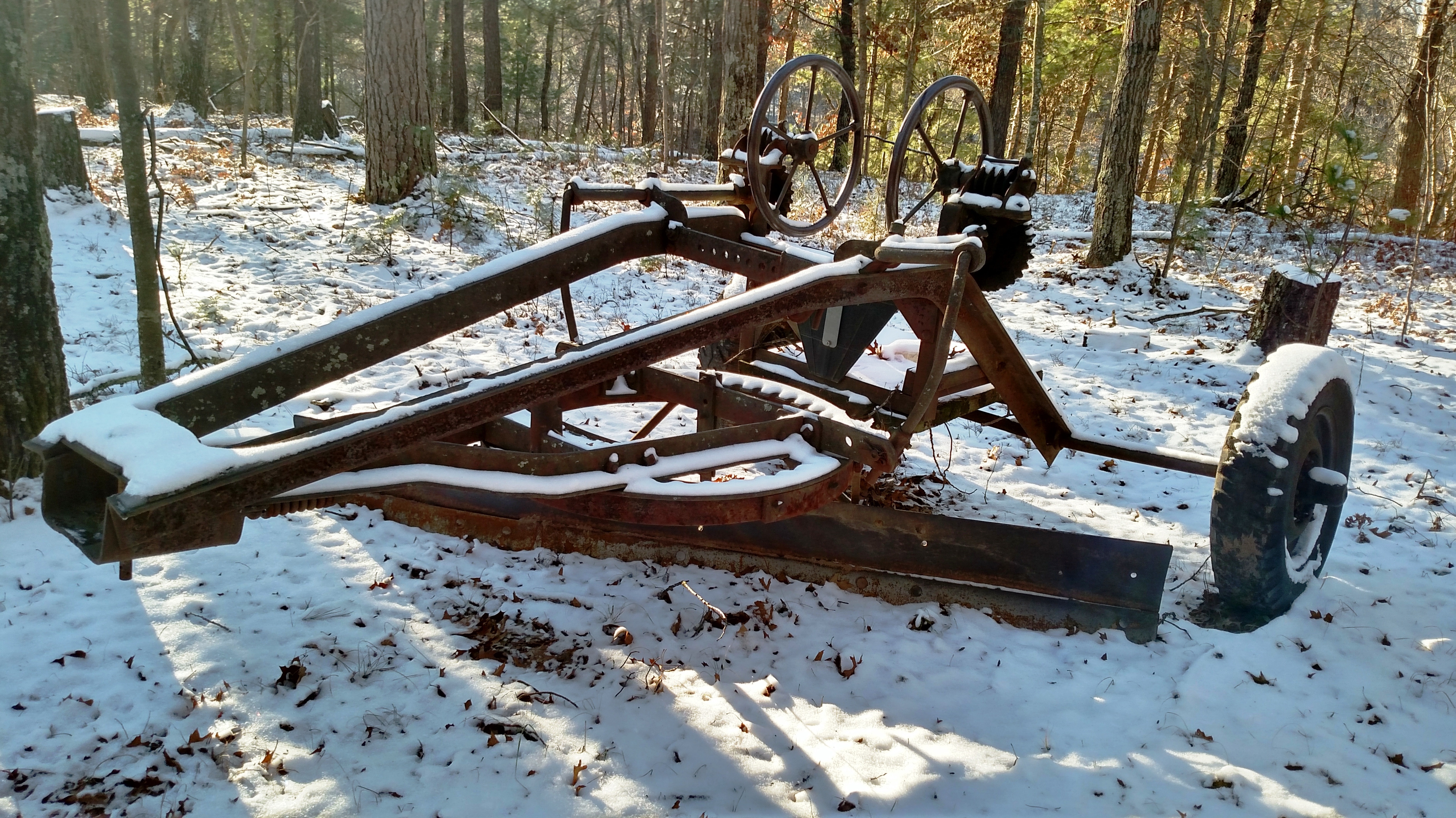

A land plane might do the trick, but a box blade or rear blade without gauge wheels takes a lot of finesse to do a good job. I built a drag that is like a land plane, but my go to implement for control and contouring is an old pony grader.
Here is the modern version...
