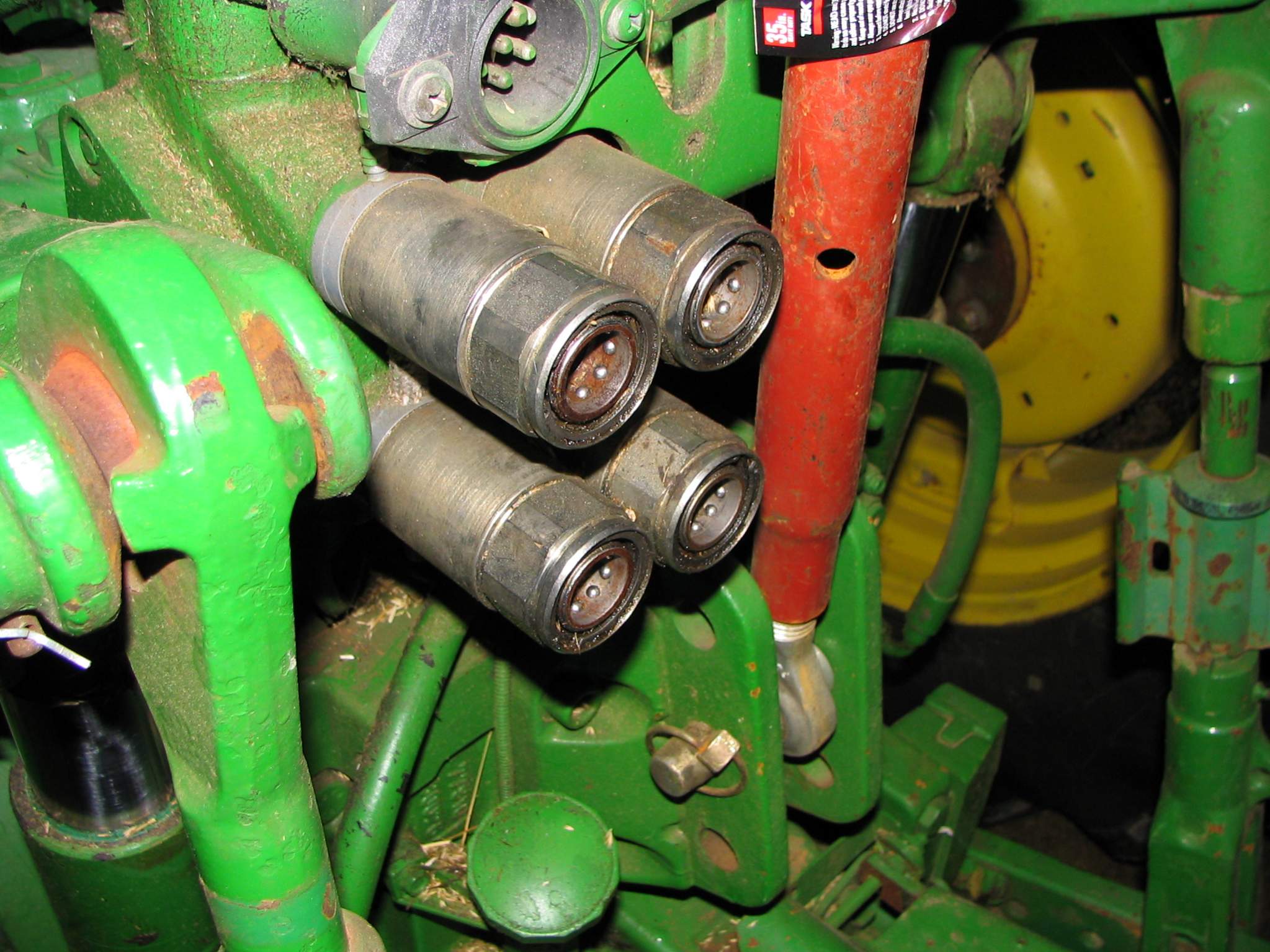

There are (4) ports on the rear, however nothing is attached. I'll check w/JD on the test port location. There was something referring to a dime?? The outside temperature does not have an effect, the same conditions exist during the summer months. You mention the 'pump'. Is this an internal or external pump. There looks like more than one pump - which one might you be referring to? What (other) functions would this pump control - what may be some other symptoms - everything else seems to work fine? I've attached a picture of the rear ports.

You can plug a gauge into on of those ports, then operate the lever that energizes that port to take the reading. You are effectively "deadheading" the pump to see the PRV is set at. You won't have to find the test port since you have those remotes.
There are a least two pumps, on is usually just for the steering, and the other is for everything else.
Maybe you should inquire about the price of a service manual, they are usually less than $100.
