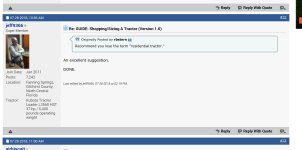

/ DPF service life #4
Agree replacement should not be required untill thousands of hours on the clock.
The residential tractor term has no reference in the tractor industry?
