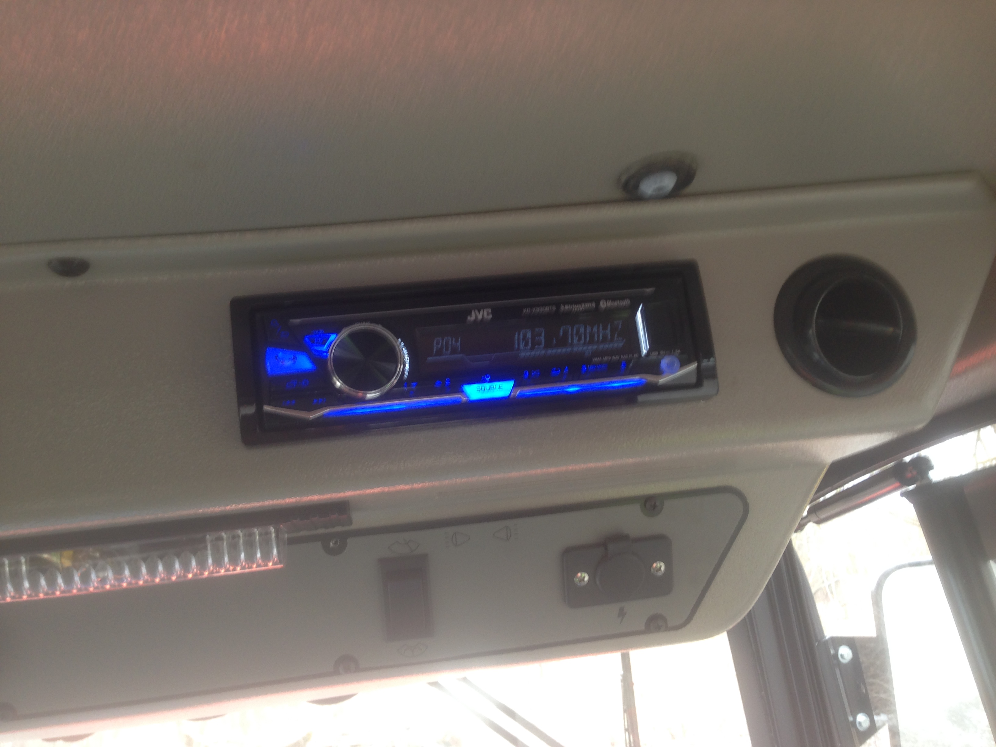

#27
Well here's the new,2017 b26 with a laurin cab..it is very nice,heat/wipers front&back/radio..it is a little tight inside.glad I'm still flexible at my age...side windows open,so does rear..for cooling off in summer..rear window detaches and reattaches when you remove BH..so bring on the snow..I can't wait for next winter..I have the 64" rear kubota blower...with hydraulic shoots..also.3thrd function valve...so I think I'm ready.

Thanks for input Ihansman..I nearly broke rear window twice..lol...I did manage to break hinges on door though..arggh..I forgot I left it open and backed into fence post..lucky was just a hinge...also I took back half of cab off,I think I'm just going to leave it off..no work with open back part..much easier all around..I never work in the rain..and when it does..I hate working with mud..takes me longer to clean tractor than actually do the job at hand....but for now I do have rear blower on ,with window and heat...mmmm it's nice....I can't wait for the snow.....IMG_2431.JPGIMG_2432.JPG
