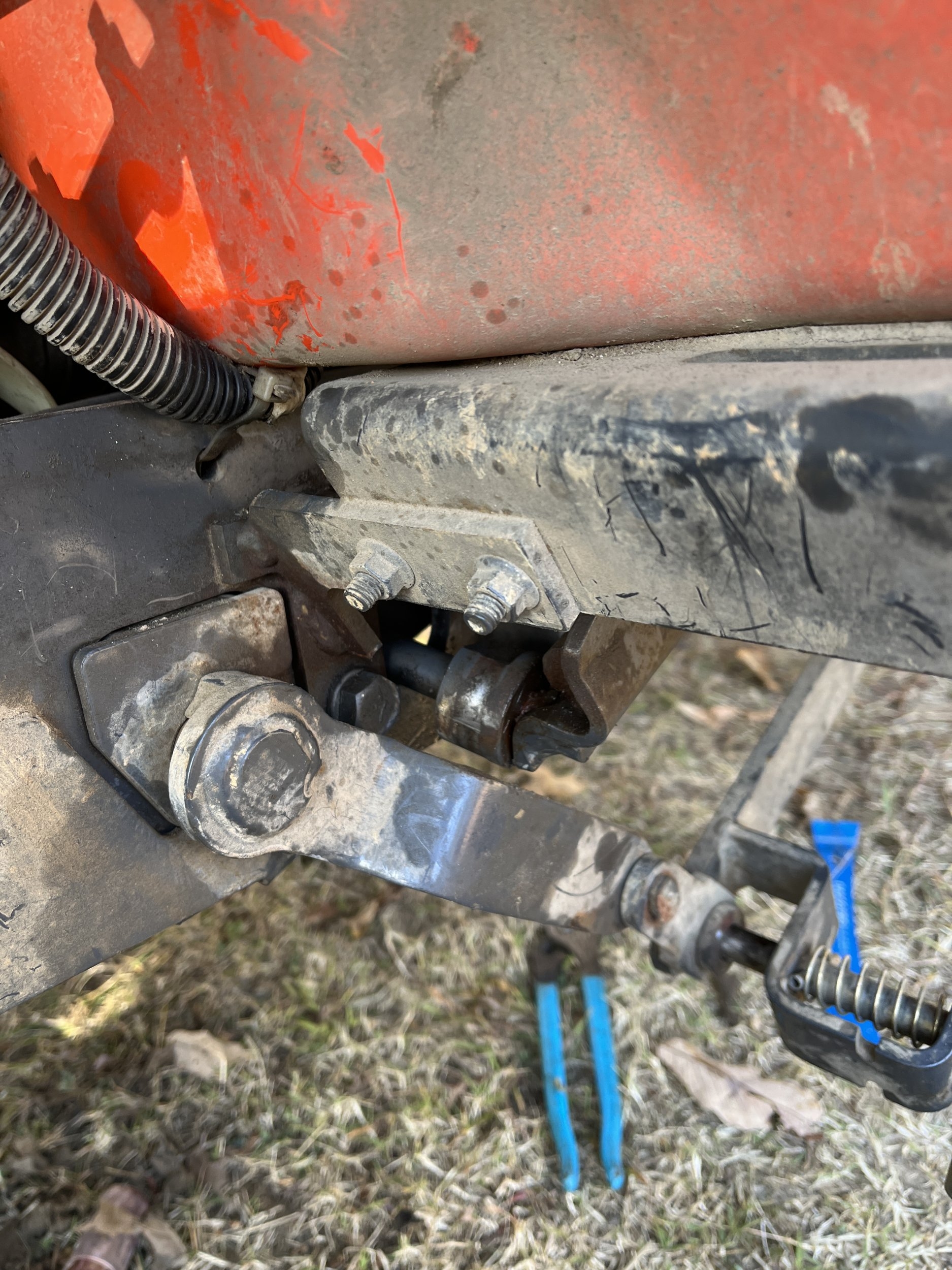

EDITED: I applied brake and locked down, tractor doesn't move in neutral, so its holding. Return spring isn't broken...
I've checked every bushing, spring, any obstructions etc and find nothing. I jacked up back of tractor and manually rotated tires, (with transmission in high, low and neutral) and pushed on the brake pedal. Nothing, didn't make any difference. So I'm thinking brake disc or another one of the rear axle components from service manual: Rear Axle Case, RH and Brake
  1. Internal Cir-clip
  2. Brake Cam Lever
  3. External Cir-clip
  4. Steel Ball
  5. Actuator
  6. Brake Disc
  7. Friction Plate
  8. Bearing Holder
  9. Shim
Is my logic sound? I've called the Kubota dealer for a quote on repair assuming I'm right....
   / 2009 BX 2660 traveling/parking brake won't spring back without manual adjustment
#12

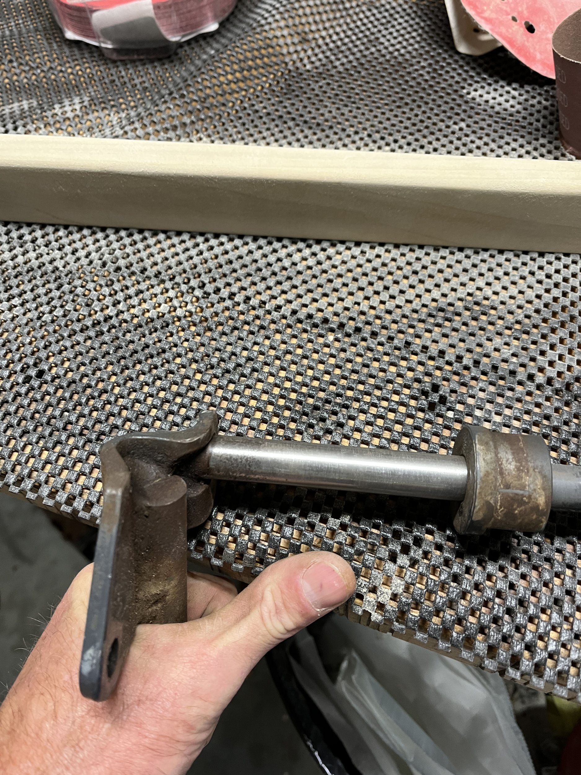

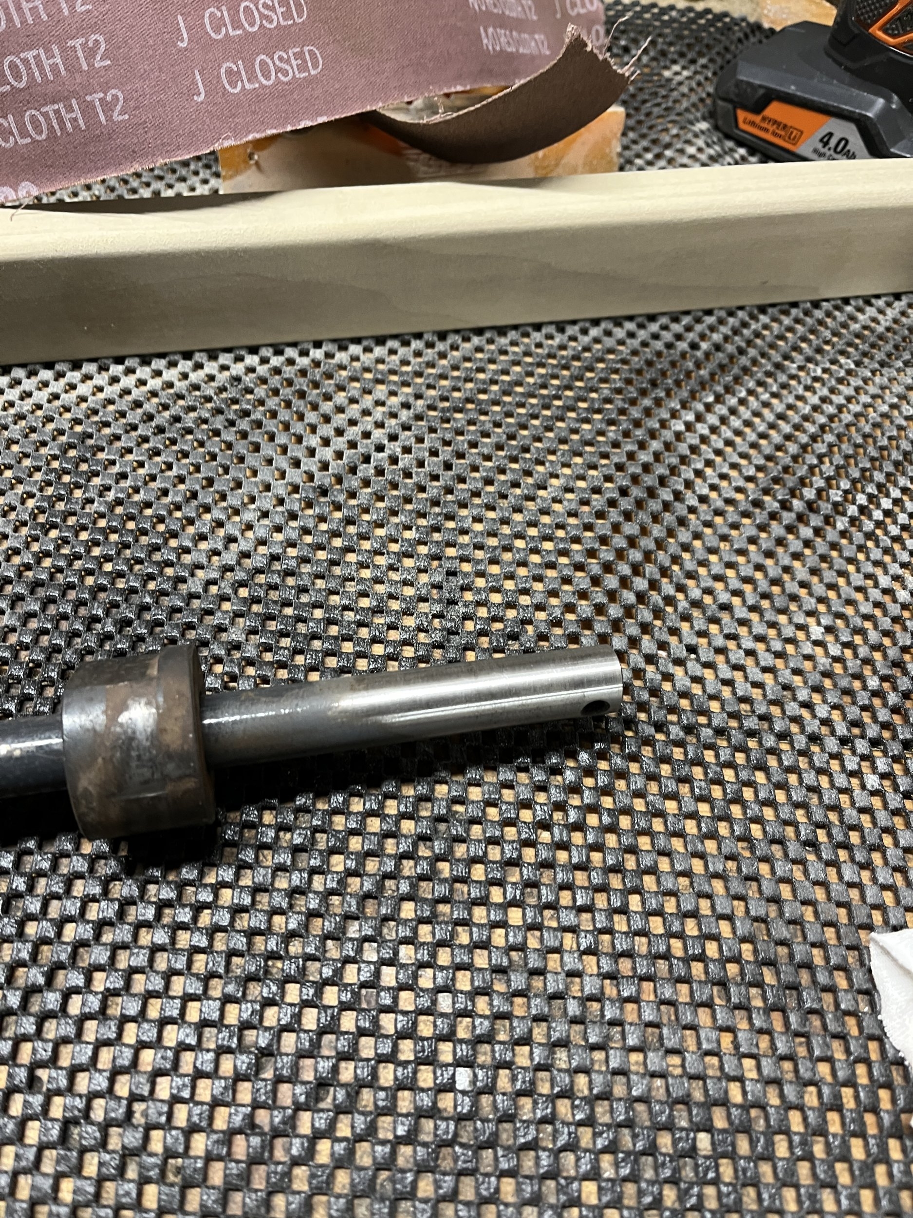

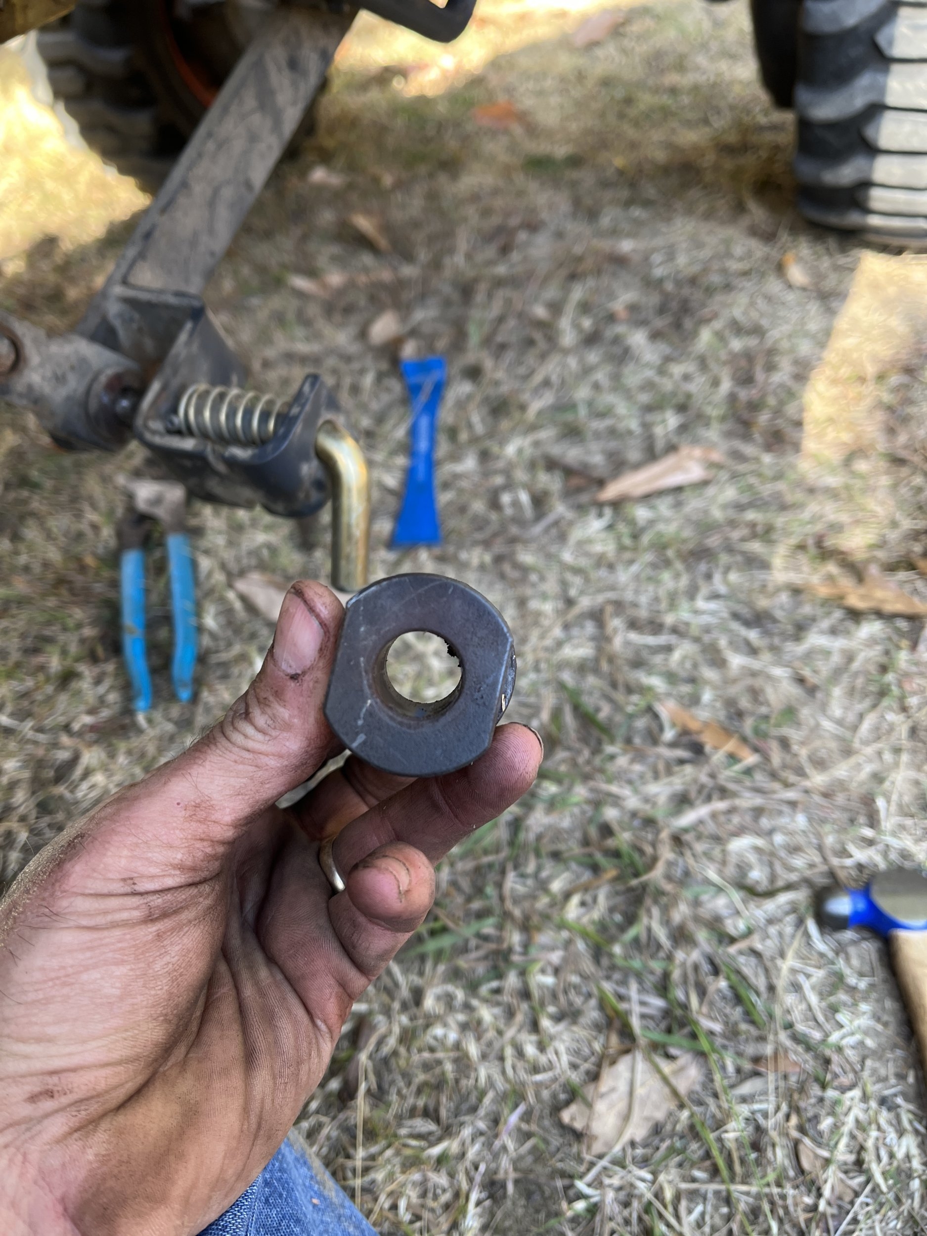

Here's the culprit, the bushings that brake rod goes through, one on right side is seized, won't loosen. Torch and heat next to break free. They should put grease fittings here. Left side fitting was fine, shown off in the pic below.
   / 2009 BX 2660 traveling/parking brake won't spring back without manual adjustment #13
I had this happen about once a year on my old L185DT. The thing that freed it up was a bit of lubricant in that exact spot, where the shaft passes through the case into the brake housing. It would seize up more if I didn't use the tractor for several weeks during the winter, but after a week or so of regular use after lubricant application during the spring would free it up for the year.
Glad you verified the bushing was your problem!

Glad you found it. I was about to suggest separating the linkage to see if the pedal returned on its own or not but you beat me to it. So...are you gonna drill and tap a grease fitting in there before you reassemble???
#16
I am thinking seriously about that, but it would be a tight fit.

I sprayed all kinds of lubricant in there working the arm back in forth. BUT, I had never before even thought about it, but will from now on or see if I can get a grease fitting in there.
