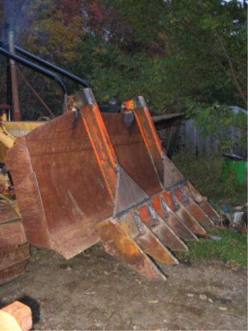

and here is one more view

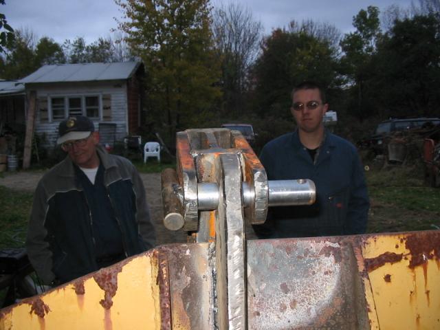

heres where it attaches to the blade

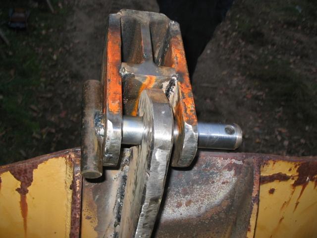

heres another shot of that, the spot to the right with all the paint burned off was where i had to heat the blade to bang out a dent that was in the top edge right where i needed to weld on my bracket, took alot of heat since its about a half inch thick, i held the big propane torch on the back side and my girlfriend held the oxyacetylene on the front and when it was hot enough i took away the heat and gave it a few good blows with the sledge, took a few times of doing this but i got it back to straight
