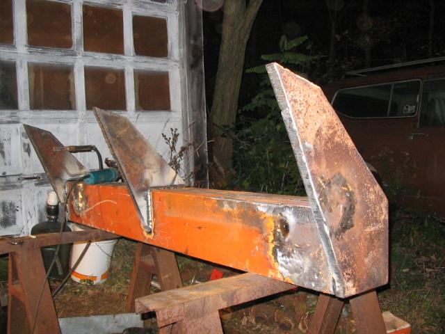

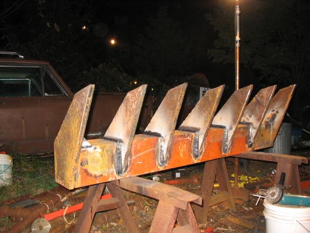

/ dozer root rake
#24
here is a picture of the rake itself completed, i will get a better pic from the front once i turn it over, its so heavy now tho that i will need the loader to flip it.

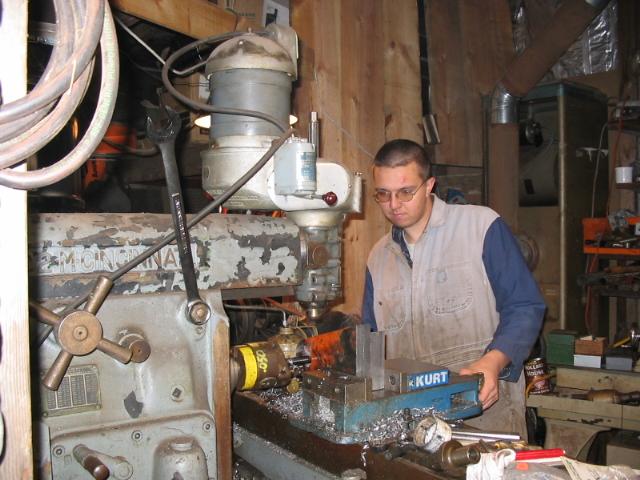

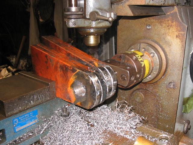

/ dozer root rake
#25
now that the rake itself is done, i had to make the pins and brackets to attach it to the dozer blade, these two plates will be welded to the top of the blade, here i am drilling the hole for the pins, after i drilled it i bored it to size just like the other plates i had shown in the milling machine a few messages back

/ dozer root rake #28
Mark I never thought of using a horizontal mill with a boring head in it. One shop I worked in had a horizontal boring mill for upto a 48 inch hole. I did use a horizontal mill that we mounted a chuck to it and 4 tool holder to the table to turn some large pipe flanges and other work on. I like your rake, I used to build a few here and there and they are handy on a dozer. those are some great looking cuts on the teeth and the mounts to. I used to be good at cutting free hand but since my car accident im less steady. I cheat now with my pattern burner. One thing about a rake i learned is to either hard face the tines or what i do on alot of things is take a leaf spring off a pickup and cut them into strips to puut on the bottom of the teeth and on the fronts to make them last longer. It helps if you do alot of clearing but occasional use its not a problem unless your in sandy soil like we have here.
/ dozer root rake
#29
yea i had been fourtanate enough to come across the tooling for the horizontal spindle very cheaply at a surplus store, i have been looking for a medium sized lathe chuck to mount to the spindle also as you mentioned for turning large short stuff, using it to bore a hole is kinda a pain since you have to work behind the table, so ya cant see what your doing real well, but you make do with what you have to work with.

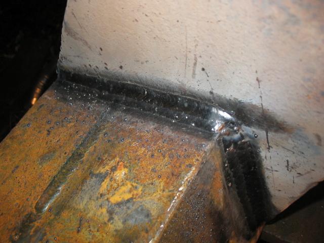

/ dozer root rake
#33
heres another shot of that, the spot to the right with all the paint burned off was where i had to heat the blade to bang out a dent that was in the top edge right where i needed to weld on my bracket, took alot of heat since its about a half inch thick, i held the big propane torch on the back side and my girlfriend held the oxyacetylene on the front and when it was hot enough i took away the heat and gave it a few good blows with the sledge, took a few times of doing this but i got it back to straight
