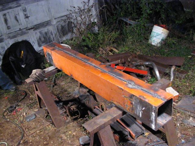

after cleaning all the welds from brackets and stuff off so i had just two six foot long channels i beveled the edges where they will go together and then clamped them up, ran a root pass of weld

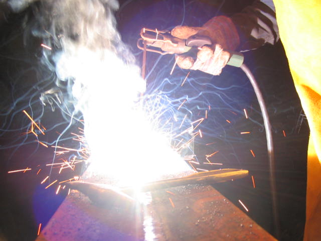

here is a close up of where i started running a finish bead over it, this is the part that will be the main cross piece that i will weld all the teeth to to form the actual rake part

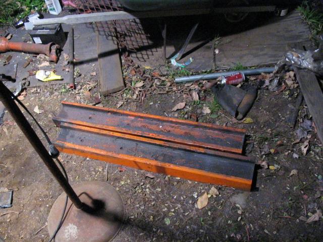

and these are the two pieces that will be the vertical uprights to attach it to the top of the blade, more forklift mast parts, plenty heavy duty steel, and best of all the forklift was free, it was one of those electric stand up warehouse ones, so it was of no use to me so i had just take it for parts anyhow

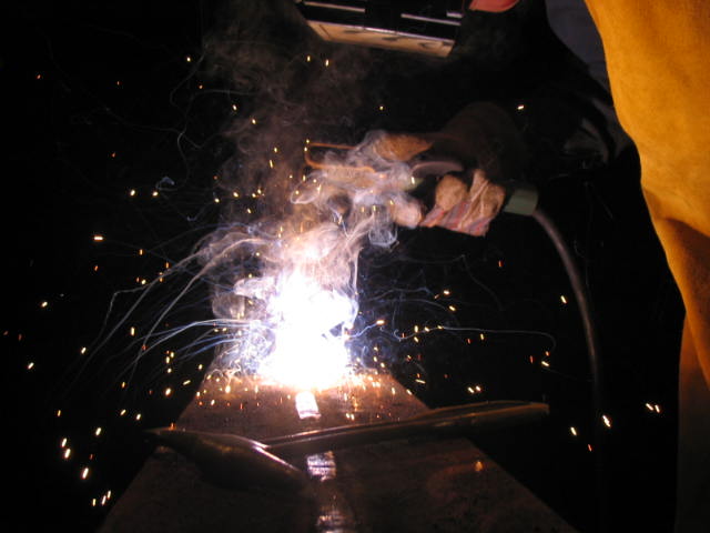

here is a pic of welding up the rest of the seam between the two channels to form the box tube
   / dozer root rake
another of me welding, i burned up almost an entire 10lb box of rod this evening
