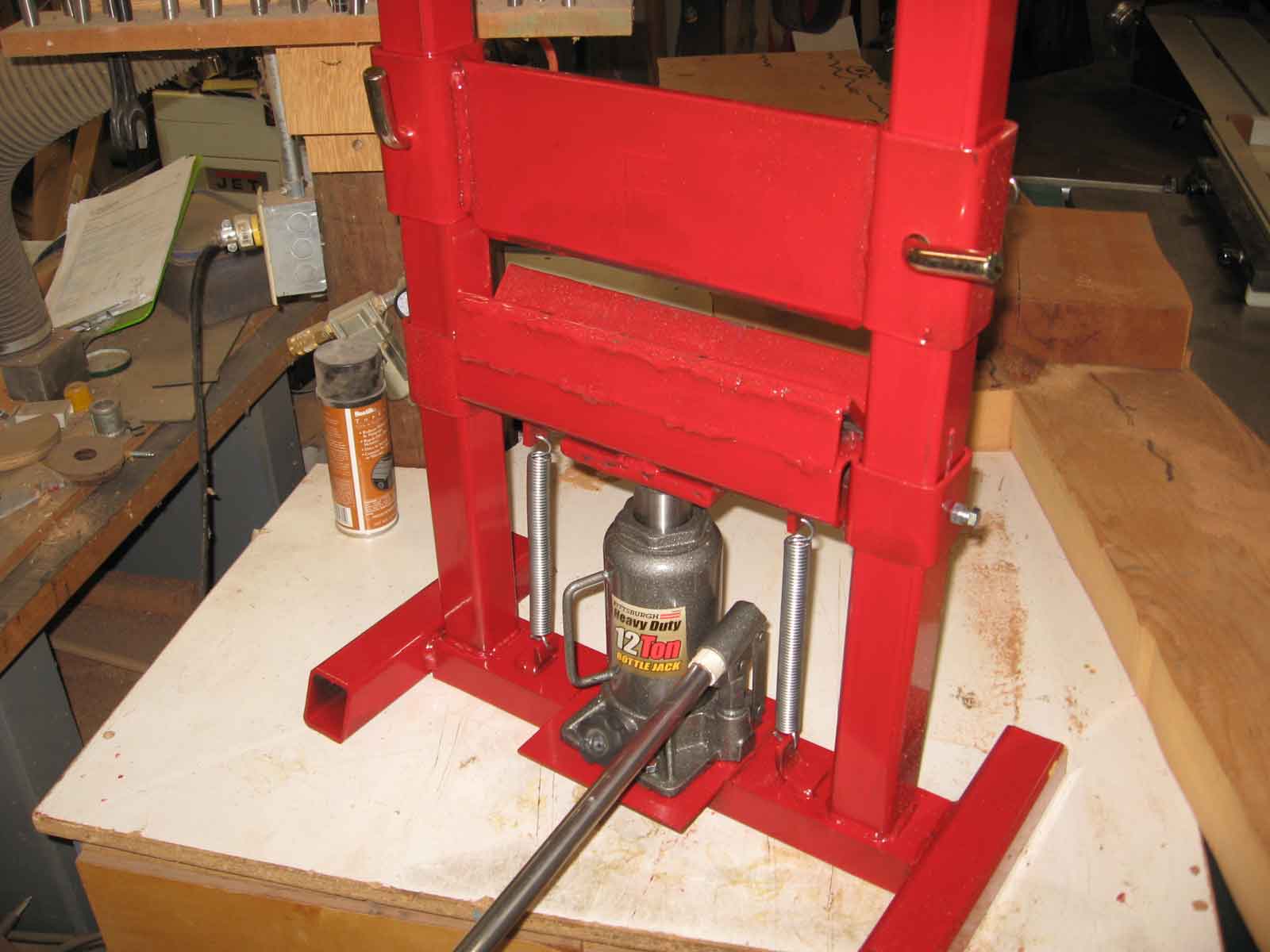

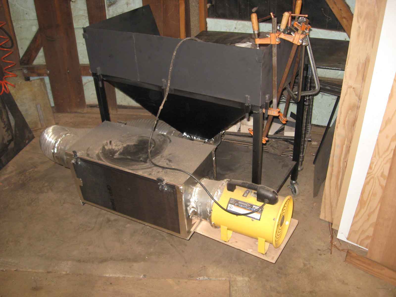

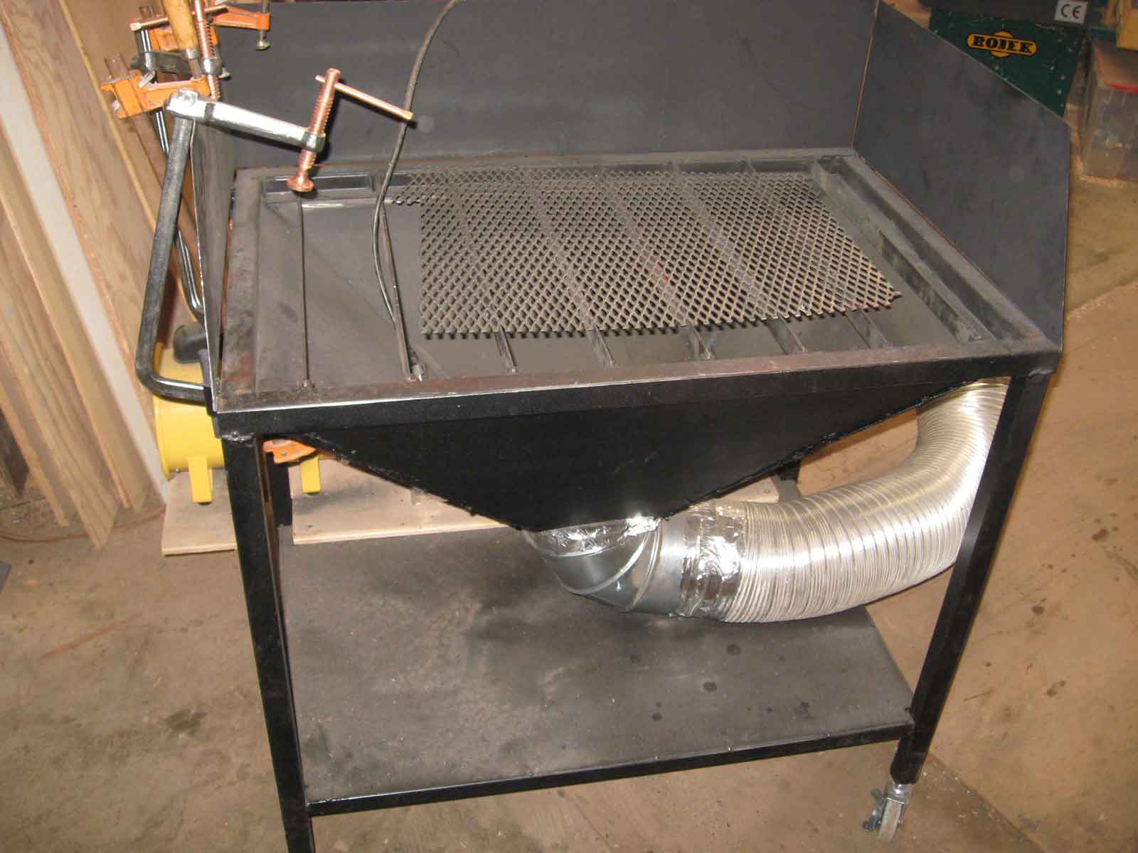

Hi all
Just finished these two projects up. the first is a downdraft table for cutting and welding really helps to keep sparks and smoke contained. the metal box contains the filters, it needs to be mounted better in the future.

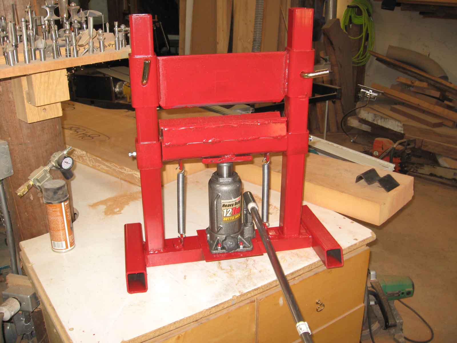

The second is a press brake using a 12 ton harborfreight bottle jack, does a nice job bending things up to about 1/4" if not too wide .
Most the ideas used were found using google images.

I like the design of having the top plate removable on your press brake. It'll come in handy being able to remove your bent pieces.

I saw a bunch of down draft tables at an auction last week. In fact, I bought the motor controllers for them. If you can't use them for mig, then really what for? I'm guessing they won't keep grinder sparks from still shooting across the room either. Maybe good for that poisonous plasma smoke.
/ downdraft table and press brake #4
On the down draft table why not exhaust to the outside? Is the press stable when being jacked? It is a great feeling to buying something that works as you wanted or needed it to.

Reminds me that the local shop offered me his floor model press brake for $50.00, a cross bar is bent but easy to replace.
He said that the safety police ordered him to replace it with some shielded model for operator protection,
The jack works OK and at that price I could not buy the steel to make one.
My problem is shop floor space.
Thanks for the great comments, I use it mostly for plasma and it also works well for mig on the lower setting.
I didn't vent it to the outside to conserve heat in the winter .
seems pretty stable on smaller thing but if I bent long items I would clamp it to something.

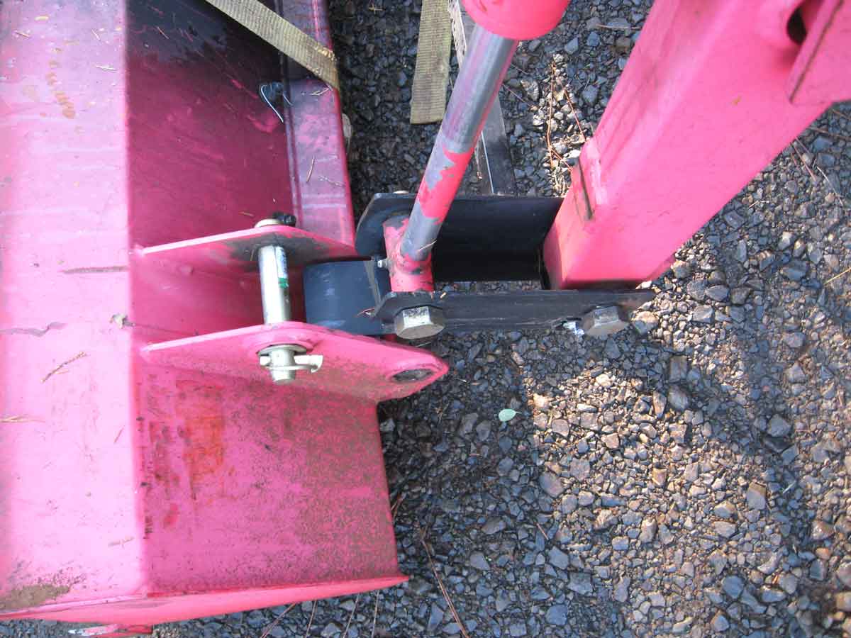

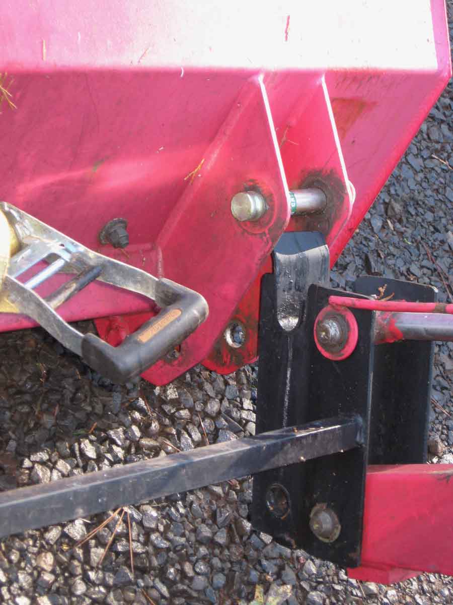

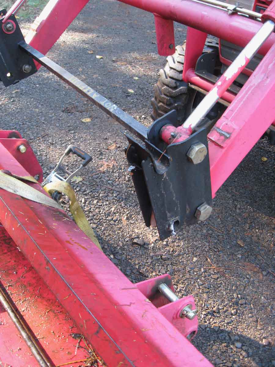

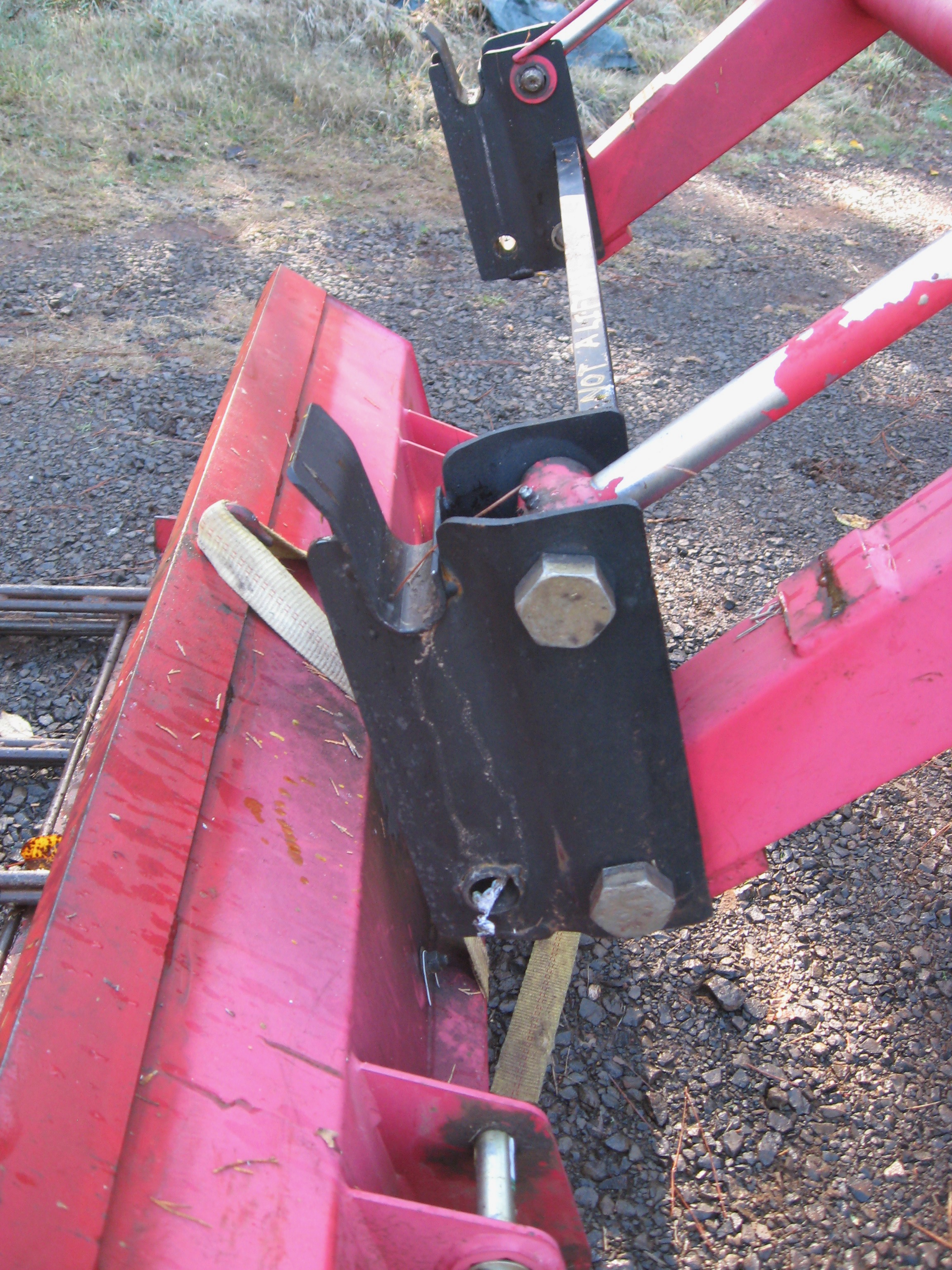

Any pictures of the BX quick attach?
here's some pictures, there are a few really good post with different variations on how to make one on hear. They all seem to have links to each other so if you find one it is easy to find the rest.
The mount was pretty simple all 3/16" plate and the bottom tube is 1" black pipe. DOM tube might have been better but i used what i had.
Tom

mrfu, nice job on the quick attach. It is very similar to the one I made several years ago for my B7500 with LA301 loader. My only comment to you is the size of the cross tube between your quick attach mounts; it seems rather small. There are more forces on this piece than you might realize. My loader is probably not much stronger than yours. I originally had a 2 inch by 2 inch, 1/4 inch thick square stock for the cross bar. After a couple of years, the seam in the tubing split open. I since replaced it with a 2 by 3 inch, 5/16 inch thick tube and have not had any problems.
Another advantage of a larger cross tube is that you can weld on hooks. You get a little more lifting power this way because you don't have a 100 pound bucket on and the lift point is closer.
