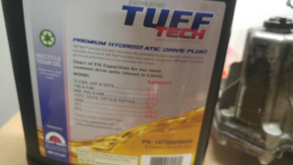

My K46 is $1000 new. And here is their oil. No mention of the weight on the jug.

My K66 stated it came with 5w-50 full synthetic oil, so I kept it the same.
