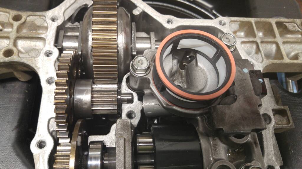

The problem with the K46 transmission is there is no oil filtration and not even any feasible way to change the oil. No drain plug on this non serviceable transmission. So it just chews itself up from its own metal particles.
There is a rubber plug on the top whereby oil can be sucked out and replaced. Thicker oil seems to be the word from TT. There is a very fine mesh filter screen inside the oil section, in the top of the unit.....about 2" diameter, 1" high.
Here is inside of my k46. I had to replace a broken axle. Has internal filter before the pump. Also has 2 magnets next to filter, another magnet near the axle gear. They had a little crud, but not too bad for 10 yrs.
The old oil didnt look bad either.
