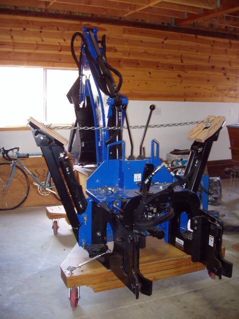

So far I have made dollies for my Woods BH90-X backhoe w/ hydraulic thumb,
Wallenstein BX42 3-pt pto chipper and my hydraulic 3-pt wood splitter. Not just for the ease of attachment/detachment but more so for "sardine storage" in my shop-just roll them where I want them.

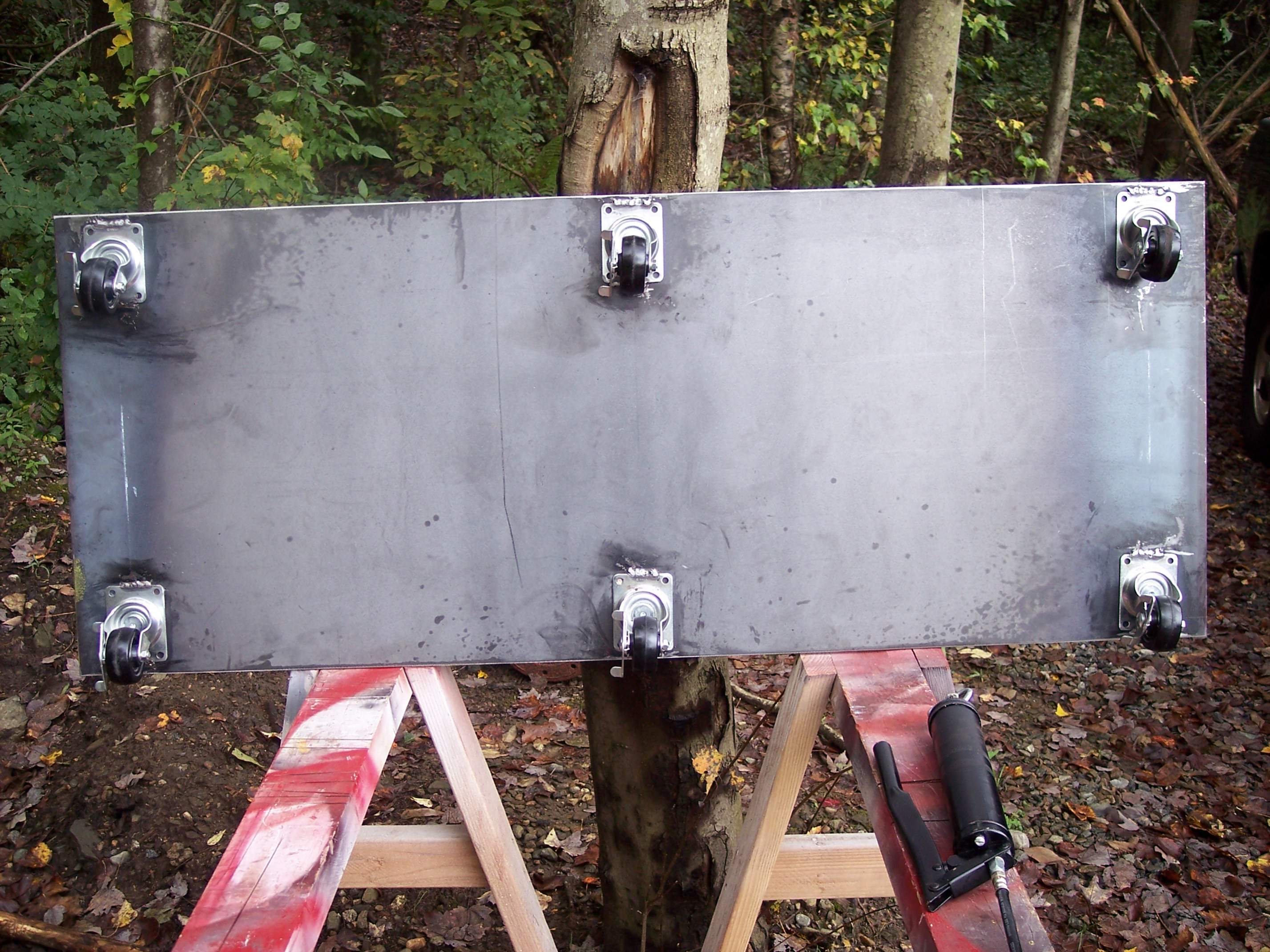

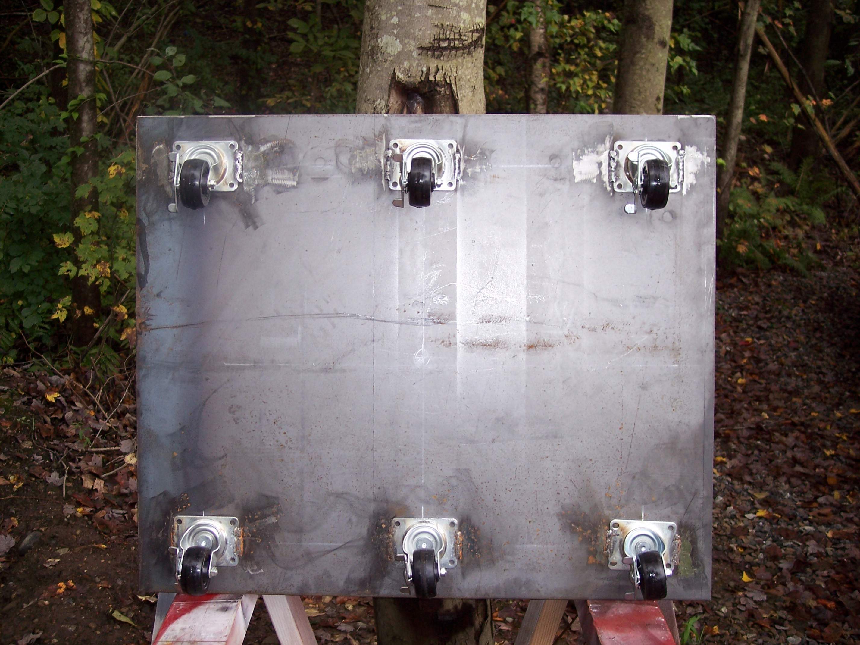

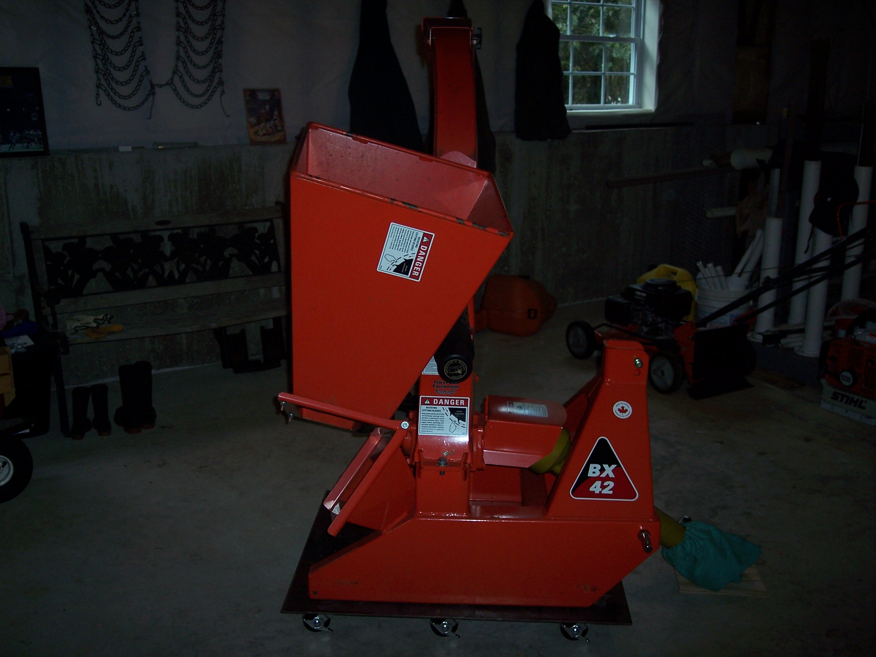

I have (hopefully) attached photos of my carts for my tiller and my chipper. I welded 3" swivel casters to 1/8" plate. Casters are from Home Depot. I will be making another soon for my woods backhoe. Prior to making these carts, I was using small wooden furniture moving dollies. They worked good, but were not quite right.
