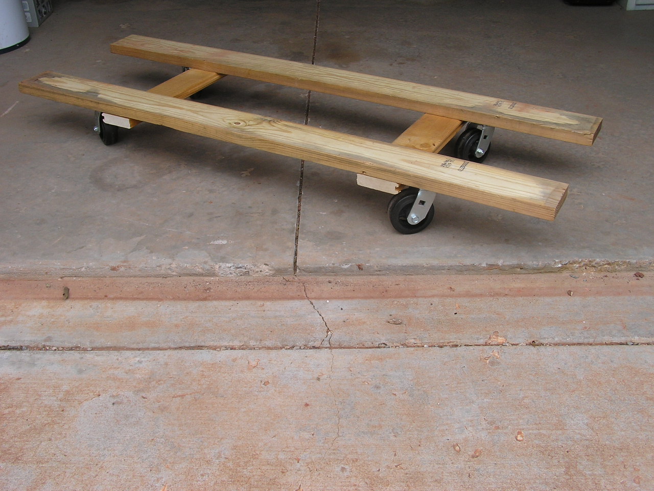

For those that didn't see it: https://www.tractorbynet.com/forums/build-yourself/422412-my-lumber-plywood-cart.html?highlight=

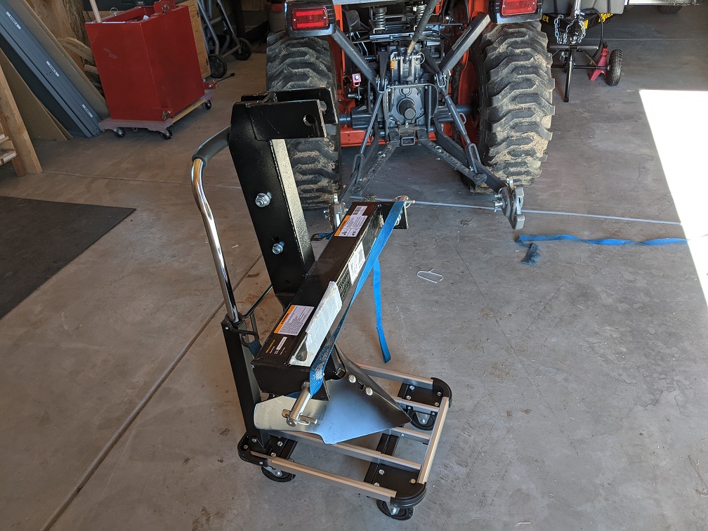

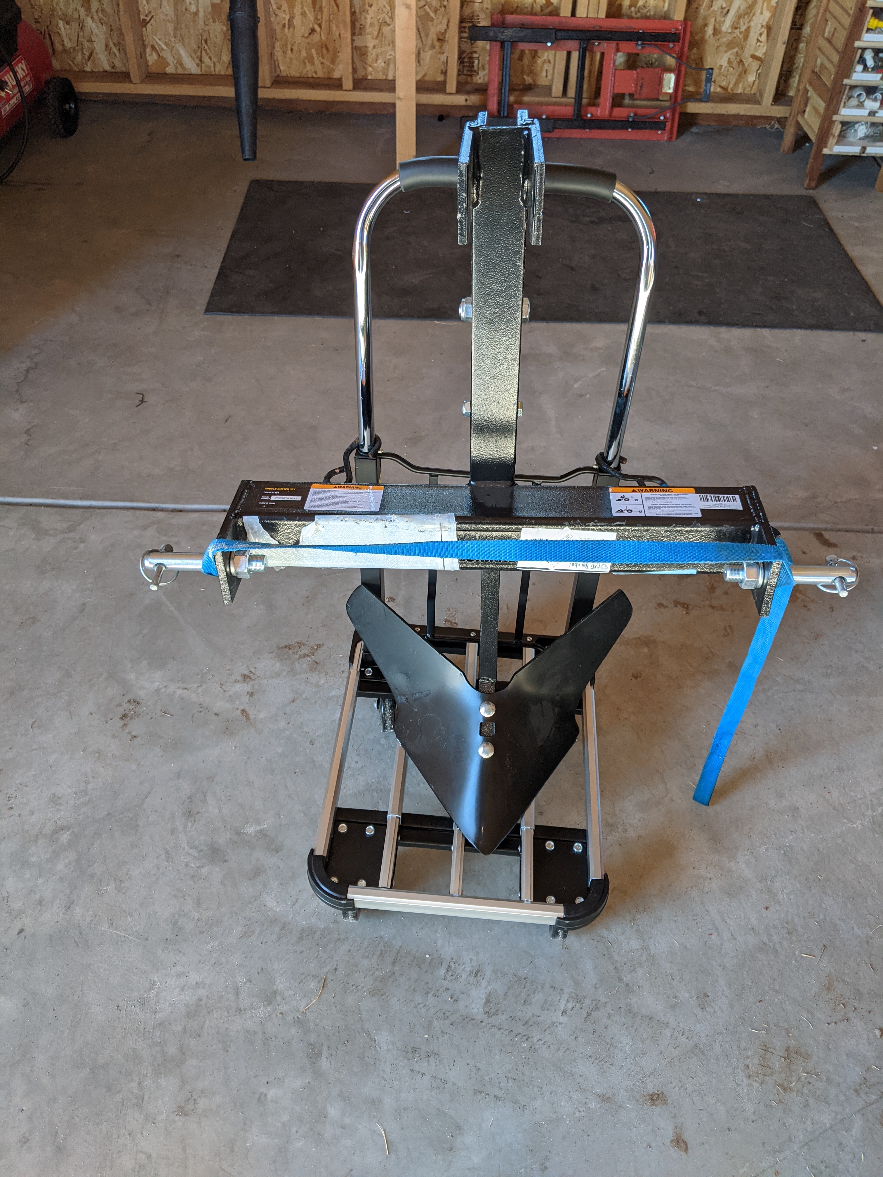

I bought a harbor freight $40 platform dolly for my middle buster. Works better than I could have hoped.

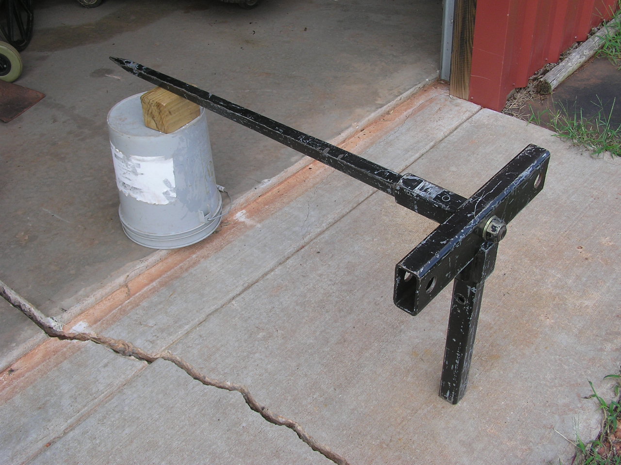

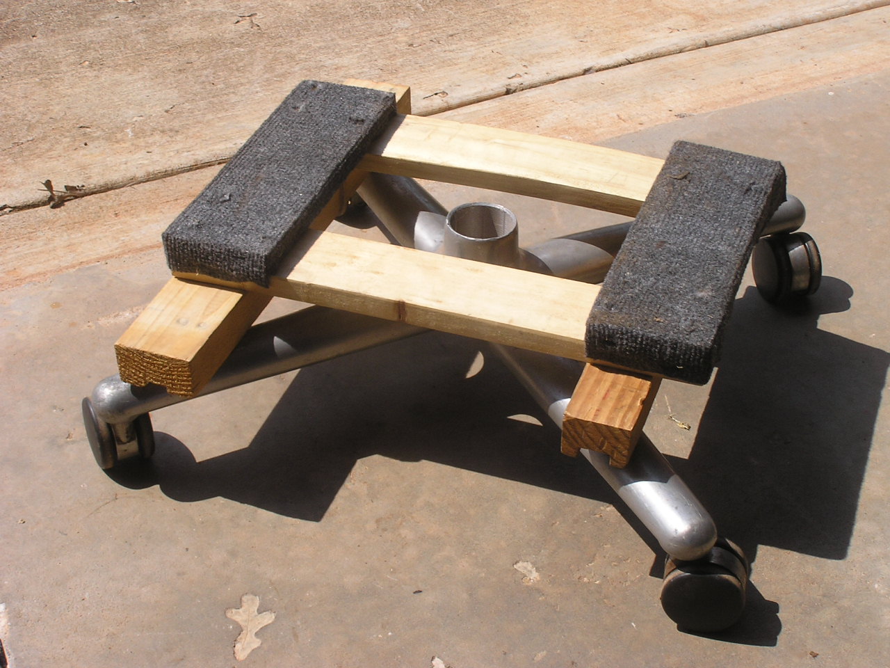

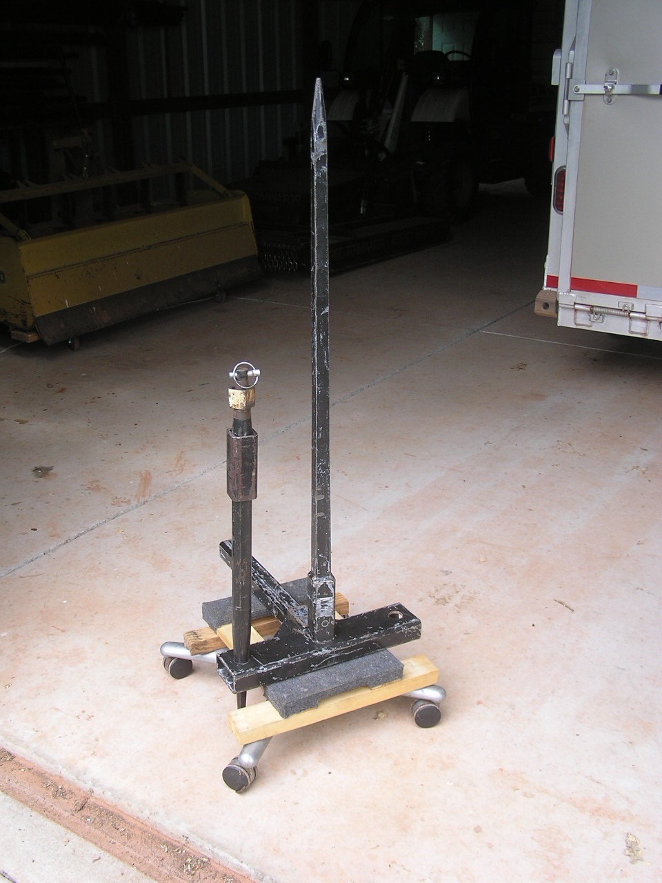

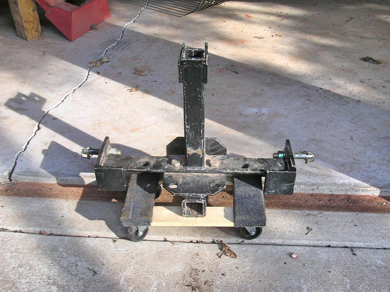

Here is one made from the bottom of an old office chair, scrap 2x3 and a small dolly that had the casters removed for use on another project:
The 48 inch bale spear:
The 34 inch stabilizer added:
They fit into the Omni Mfg. Transformer 3 point receiver hitch:

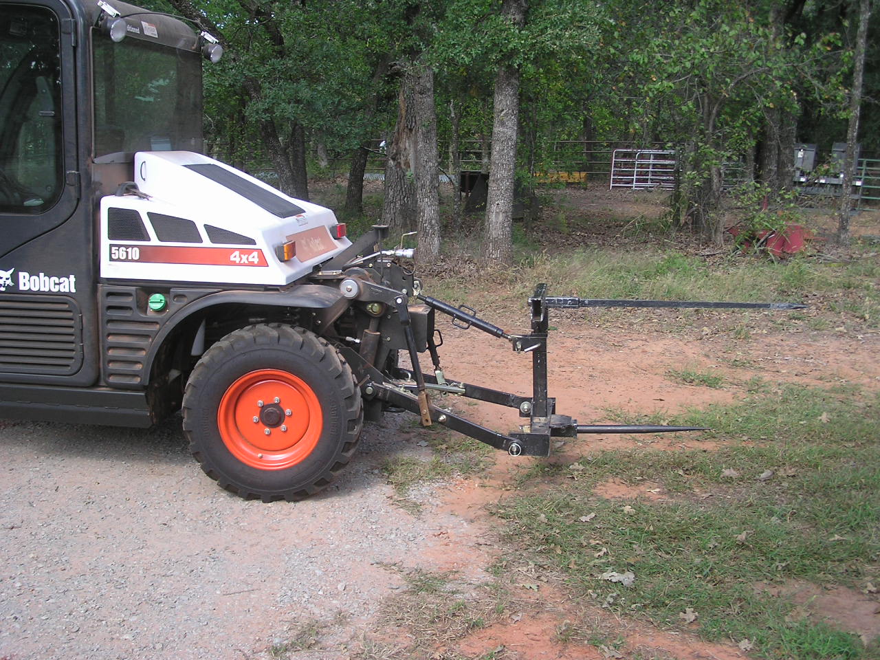

And mounted on the 3 point:

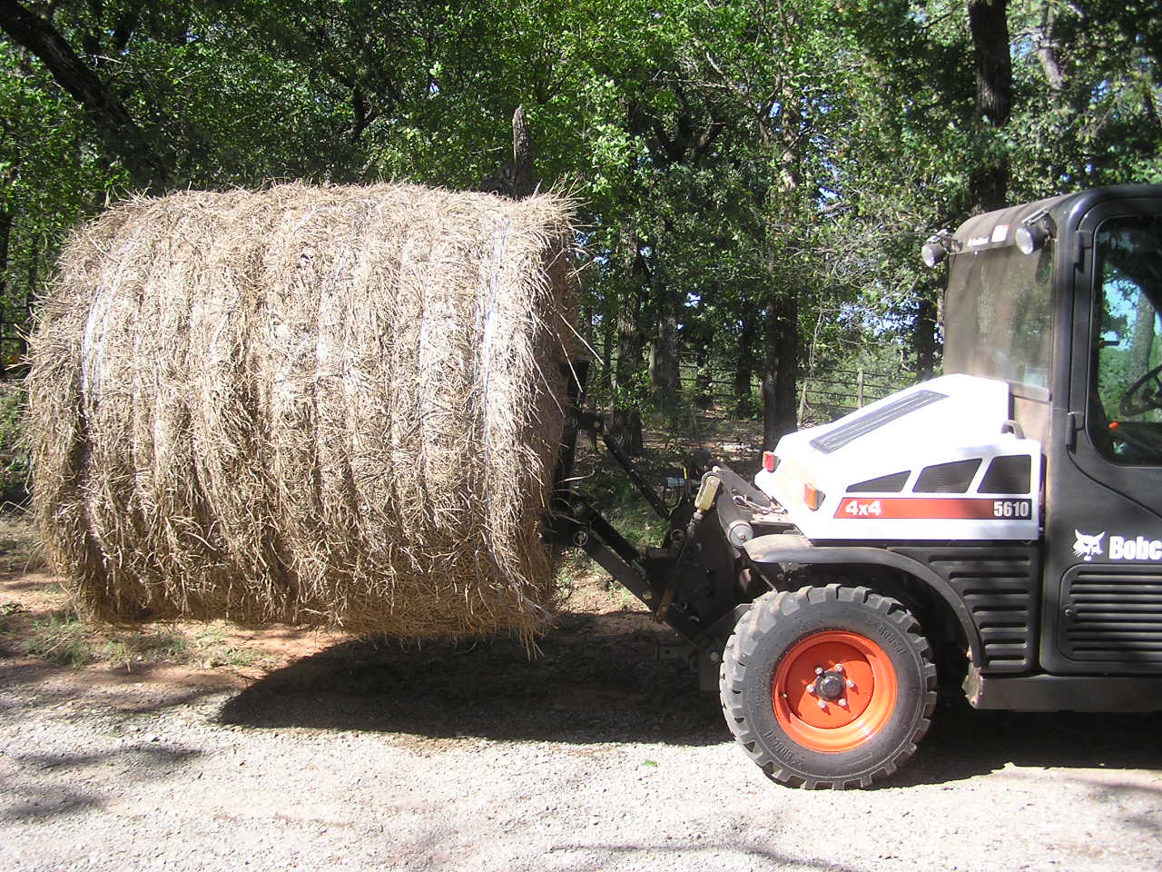

Moving a 5x6 round bale:

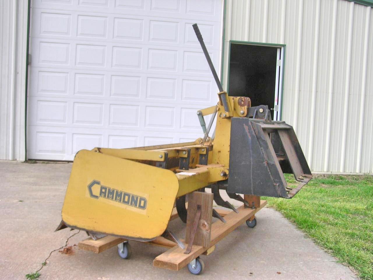

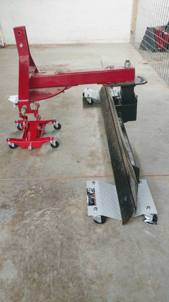

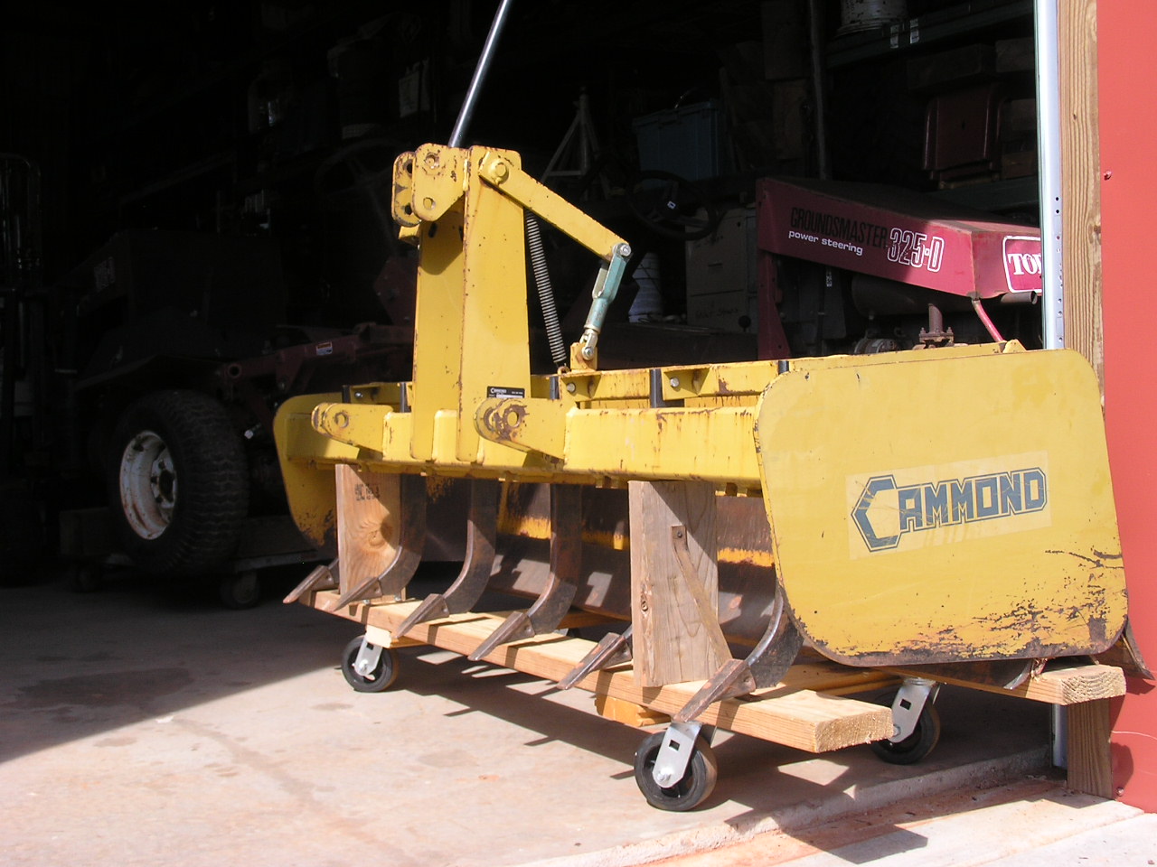

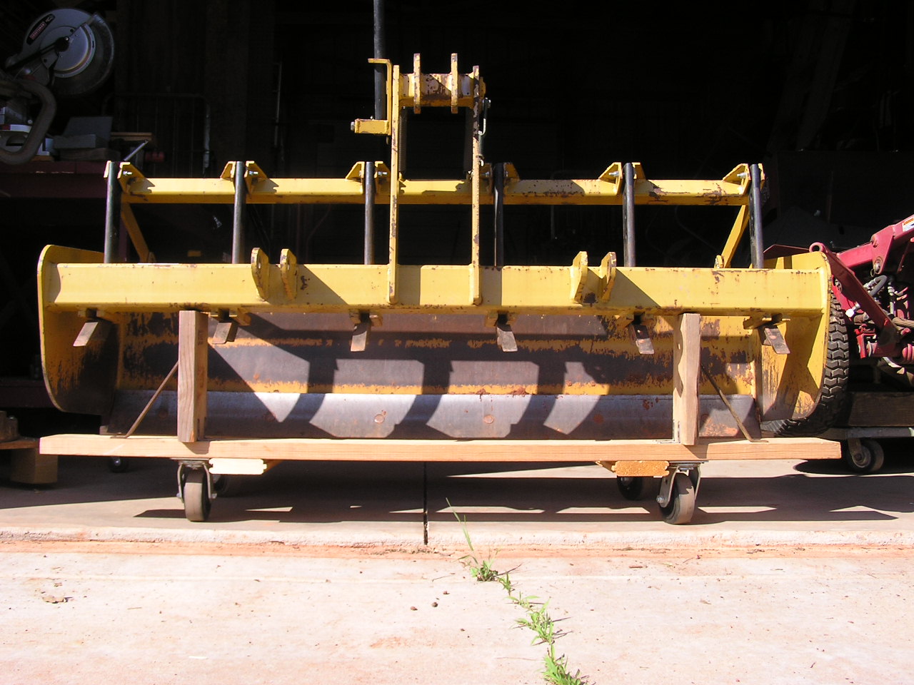

I used 2 dollies tagged together for the bucket and a smaller one for the support stand. The rear blade sits on some car dollies and a transmission jack. Both are easy to move around as needed.
