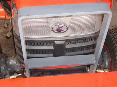

Steven,
If you weld or know someone who does, you could make a grill guard for much less than you can buy one. Attached is a pic of one I made. The metal came off the scrap pile, so its cost was minimal.
I might add some expanded metal for more protections and I want to have someone plasma cut my handle "Captain Kubota" to mount in the opening sometime........

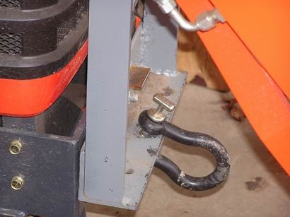

Pic #2--how it mounts.
The angle is a spacer for now......... I need to trim the cross piece later to give more clearance to the front of the BX.

Yea I thought about making my own, but I am still a little frustrated over the headlight, one of those I will get to it and probably never will type deals. I have to many projects see my post about my jeeps /forums/images/graemlins/crazy.gif Plus I am really starting to look into building the grapple. I did like the clevis mount, on your bumper. Also did you use a torch to bend the flat bar ? That was another sumbling block since someone stole my tubing bender /forums/images/graemlins/frown.gif.

Yep, used a torch to heat/bend the top radius. Then cut the ends flush for the proper length.
I found leaving a clevis on the front and rear speeds my tie down time on the trailer and doesn't skuff the orange/gray. In fact, I just unpin the clevises after loosening the binder and drive over the chains. Time = Money.
