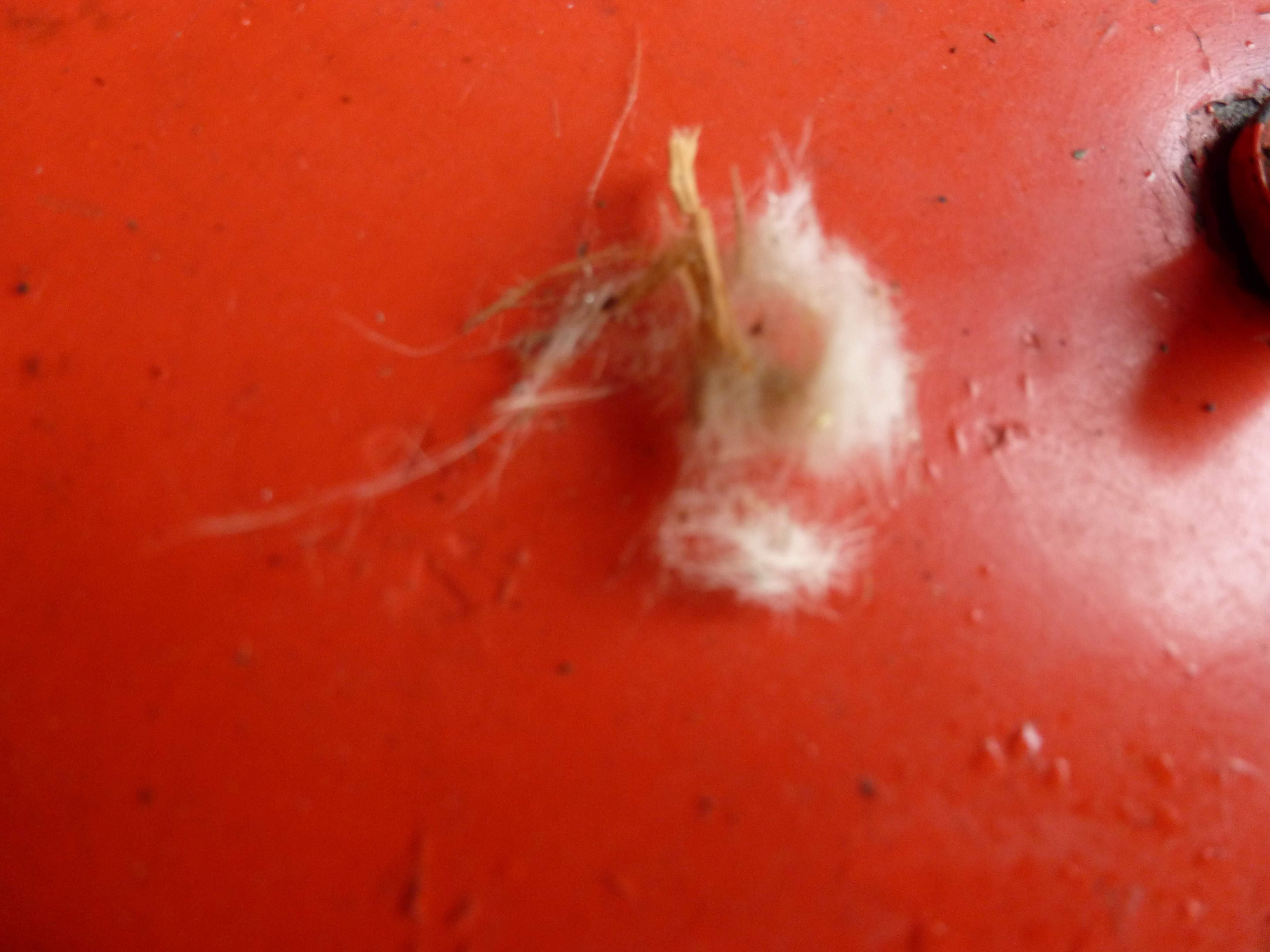

My last mowing job of the season was about half an acre of six foot overgrown weeds, affectionally called a "meadow" by the property owner.
Going along just fine, doing the last pass, but going through a thick patch of some large weed that created an enormous cloud of white fluffy material, so much
so that some blew across the road nearby and I bet folks wondered where the snow was coming from. I didn't think much of it, only an hour long job and my Gravely was perfect
going into this job. In a period of ten seconds, I smelled something funny, and then the motor quit like a light switch thrown. I got off the tractor and looked in the rear and just
did a real "oh no". Air intake 100 percent clogged with white stuff, inside of air cleaner clogged, and a pile of seeds off in the corner. Smoke pouring out of the engine but luckily nothing lit off.
What really worried me was looking down at my glass gas filter, and seeing the gasoline boiling merrily away. Not good. It turned over just fine, no strange noises, but no spark.

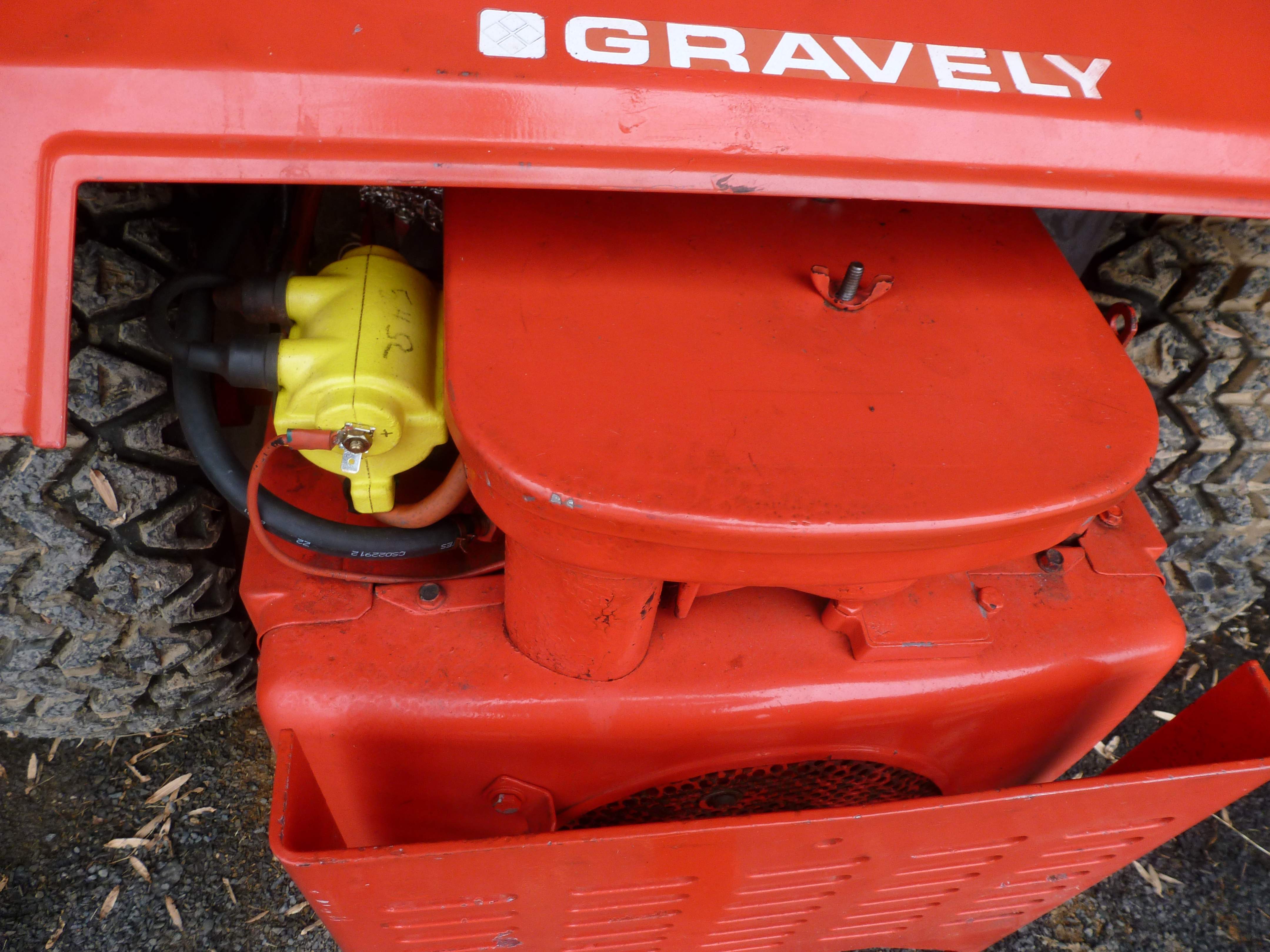

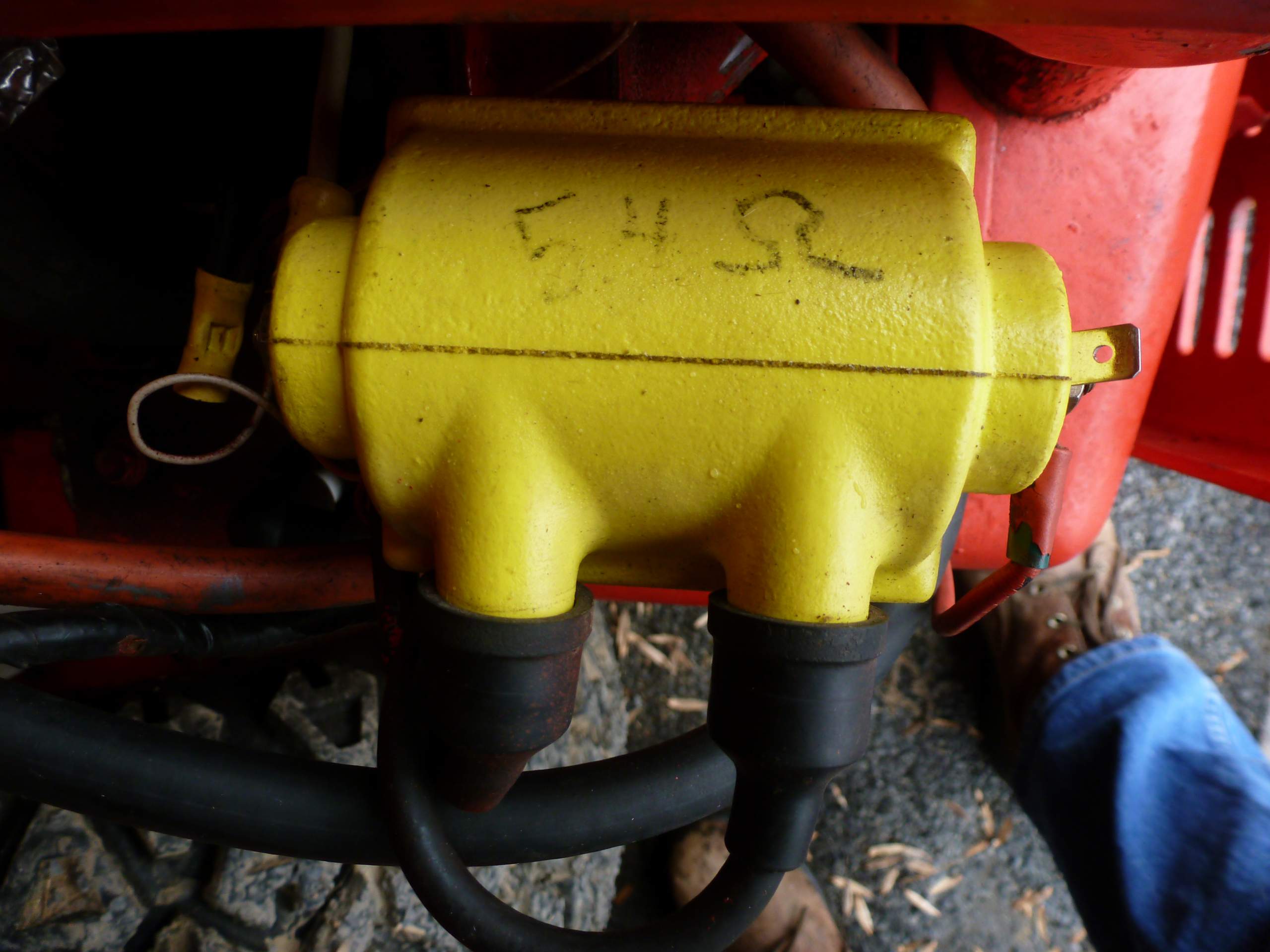

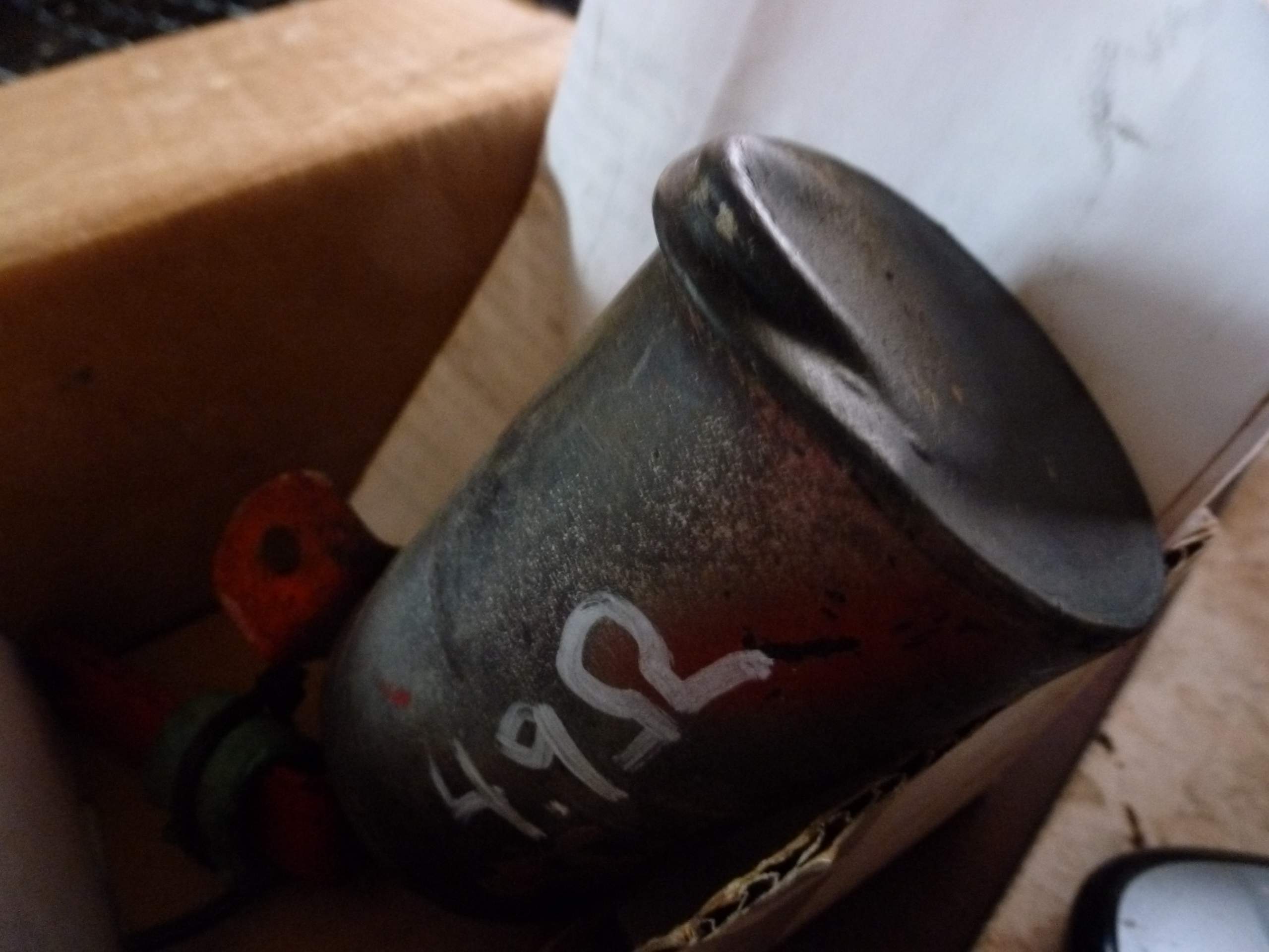

the culprit was found, my coil became a large thermal fuse, melted, shorted out I suppose, or just failed, and off went the engine. Since I supplied the shop with a replacement coil, the bill wasn't too bad. New fuel line from fuel filter back, and had to tighten 8 of the 16 head bolts. Hmmm. Guess that sucker expanded a bit. That tells me they didn't take the heads off, which I wish they had, but it runs just fine. And starts quickly.
I'm going to fashion an open weave furnace filter to fit in behind the stock bumper guard and the intake fan. That might help. And a little more attention paid by the operator.

I'll take a pic of the new coil installed later today. It's bright yellow and sticks out like a sore thumb. The new Bosch coil I have on my Cub Cadet 125 is an attractive metallic blue, this thing is dayglo yellow.
I have plenty of Gravely paint...and I need to inspect the engine closely to see what paint I burned off anyway. All the shrouding was taken off and everything inside cleaned out. So I'm back in operation; I really missed the thing

I've put 180 hours on the Gravely in the three years I've owned it. Some of that is high load, high heat operation, doing field mowing. But the hour meter is still under 800, so that helps. All those loose head bolts concern me, and why if they were loose weren't the heads taken off and new gaskets reflected in the parts list? I thought this was a good time to do that, but apparently my overheating period was short enough that I didn't damage anything more than the ignition parts. Fine with me.
