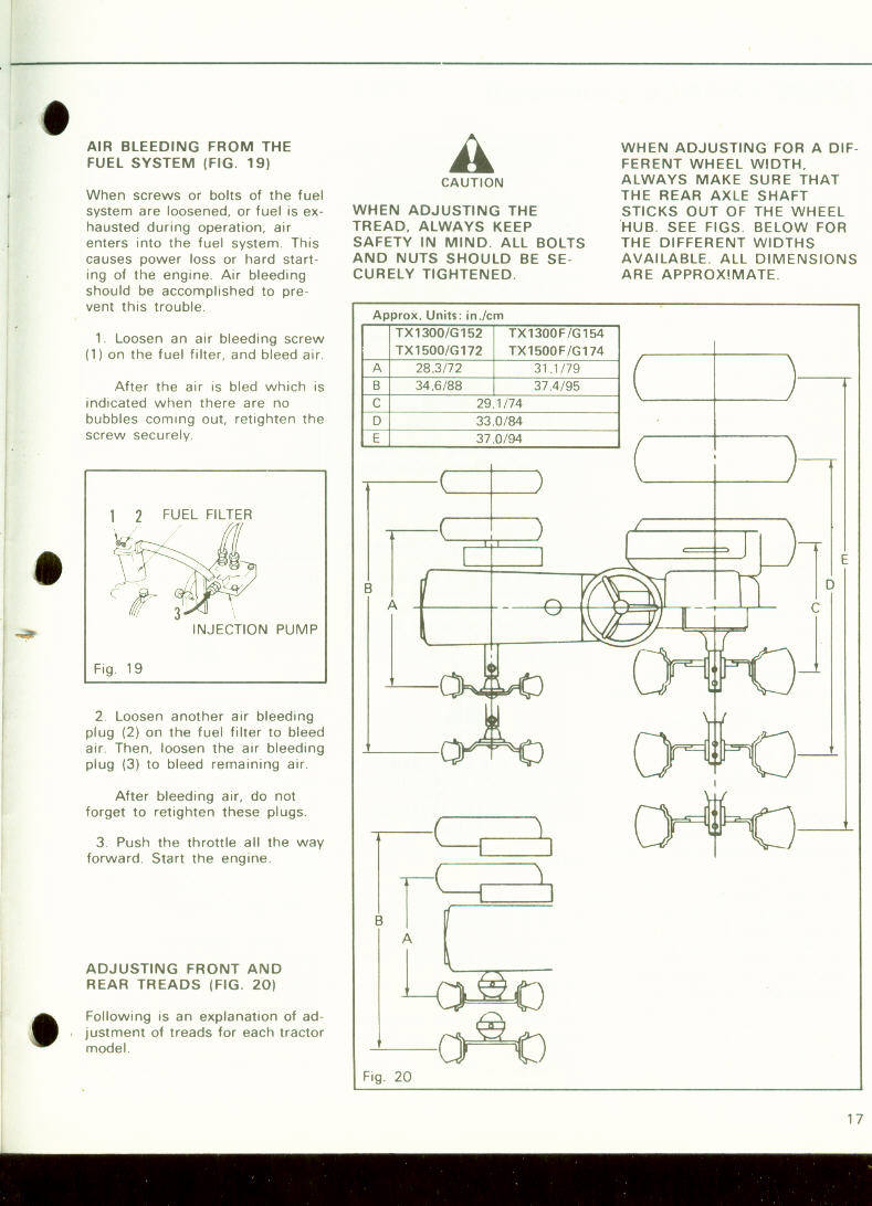

Attached is a diagram from a manufacturer's operating manual showing the front wheels in their respective "dished-in" and "dished-out" positions. I'm not for sure what it does for bearing wear (I can understand the OP's argument though that the magnitude of the torque shouldn't be more just whether it is positive or negative) but I know the tractor steering wheel is much more difficult to turn when the front wheels are at their wider position.

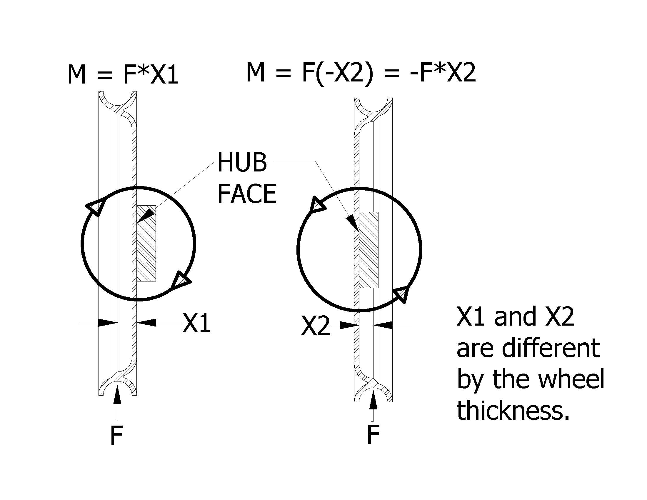

Here is my (possibly poor) attempt to put some sort of math to the problem. My better judgement says not to do this, but "'tis the season for sharing", right? The moment (torque) M is calculated in each scenario. The "hub" is considered fixed in position by the bearing arrangement, whatever that is, as long as it's the same in both cases (which is sure ought to be!) The moments magnitudes will calculate out differently by the difference in the thickness of the rim at the point of contact with the hub. This may or may not be significant depending on the ratio of the thickness of the rim to the offset of the "dish". In other words, if the dish is offset by 1" (from the centerline of the tire where the force is assumed to be acting from the weight of the machine) and the wheel thickness is 0.25", then the moment will be different by about 25%. If the dish is 3" offset from the centerline, then it would only affect the moment by about 0.25/3 = 8%. Not really the results I had in mind, but this is what my diagram indicates. Certainly mark it up or propose alternate diagrams so we all can learn what's really happening in this wonderful endeavor. The subject comes up enough to deserve a correct answer while we wait around for the next tractor job :)

After thinking this over some more I've concluded my analysis in my previous post is wrong for the purposes of this thread. The question revolves around the stresses on the bearings and the analysis does not address that question. Therefore, it should be adjusted to consider each bearing position on the final drive shaft in relation to the force applied to the center of the tire (if we assume the force is indeed centered on the tire). I'm thinking this would then lead to a conclusion that moving the tires out would indeed increase the stresses seen in the bearings.
