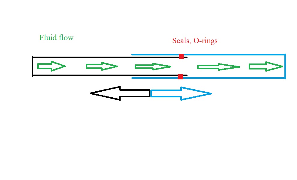

i am looking for linear retractable hydraulic joint,
basically it is hydraulic cylinder with hole in the rod, it does not perform any work, it does not slow the fluid flow, it just expands and retracts as needed, it acts as a hose but its cylinder based
is there something like this out there, what the name of such joint, send me link where can i buy it

i need something liek this but cylinder based
https://encrypted.google.com/search...1#q=axial+expansion+joint&tbm=isch&tbs=imgo:1
axial expansion cylinder coupling which expannds and retracts with minimum resistance if needed

something like http://www.slb.com/services/charact...g/product_sheets/drillstem/slip_joint_ps.ashx ??
look for
Telescopic Joint (Slip Joint)
A riser joint having an inner barrel and an outer barrel with sealing means between. The inner and outer barrels of the telescopic joint move relative to each other to compensate for the required change in the length of the riser string as the vessel experiences surge, sway and heave.
