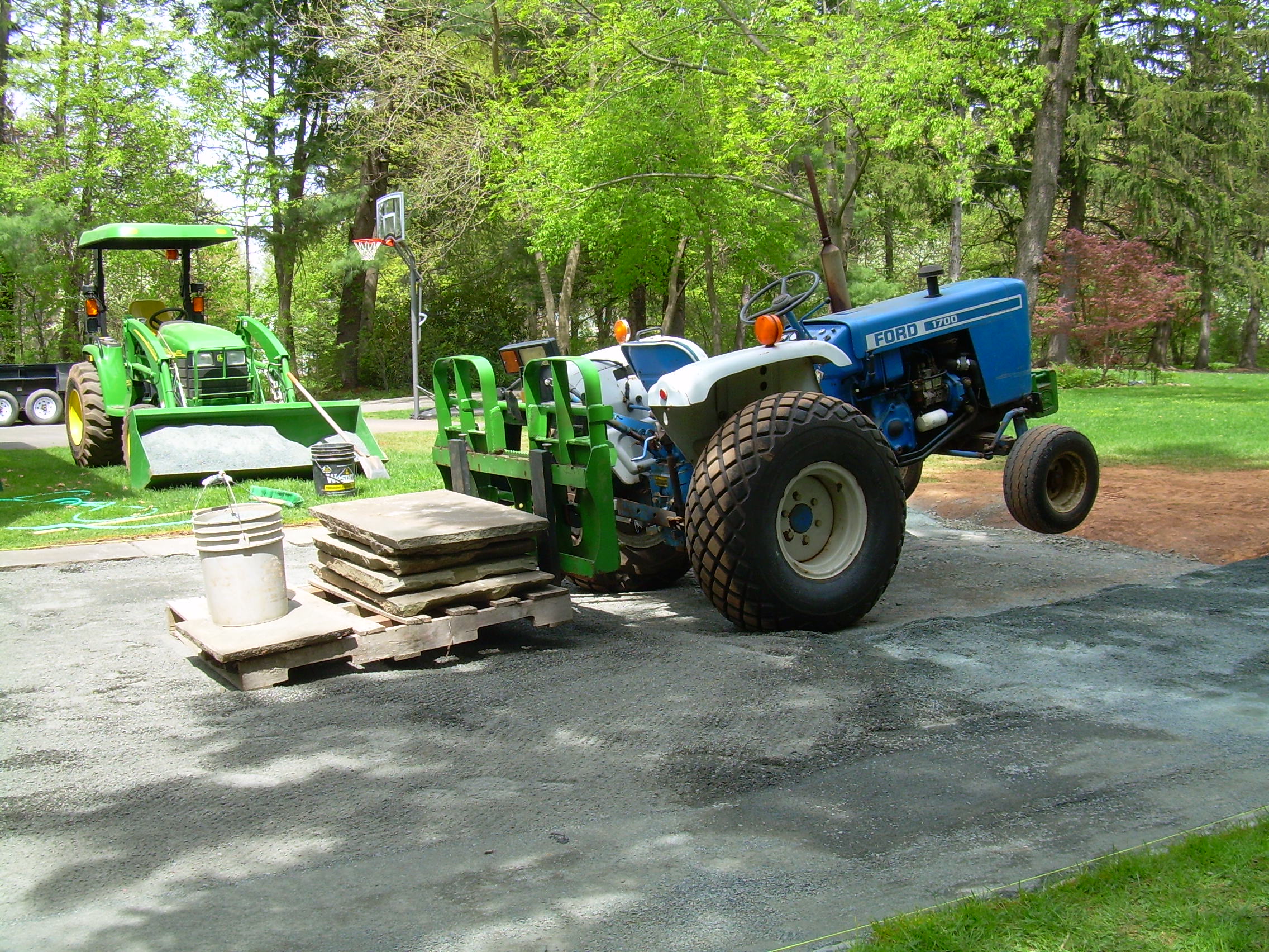

It would be barely measurable if that capacity was from 24" rearward of the lift arms. it would be a little more a factor if the spec was right at the lift arms.
It's about leverage ratio, so yes it would reduce the capacity but not by a noticeable amount.
Anyway, this usually happens before the 3pt fails to lift, at least from my experiance :laughing:
/ Does Quick Hitches Compromise Lift Capacity? #6
That happened to me once.
I always installed the loader, then the ballast box...but one time I hooked up the ballast box first (on my old 790...not too long after I got that ballast box).
Needless to say, the 3PH didn't lift, but the front end of the tractor sure did!!
No damage and I lowered the tractor as soon as I felt the front end come up (front tires probably never got more then 8-10 inches off the ground).
Kind of surprised me...I'd frequently lifted a 60" Befco RFM (450 lbs, per the Befco site) with no front ballast. I guess that extra 200-300 lbs in the ballast box was enough to do the job though...
