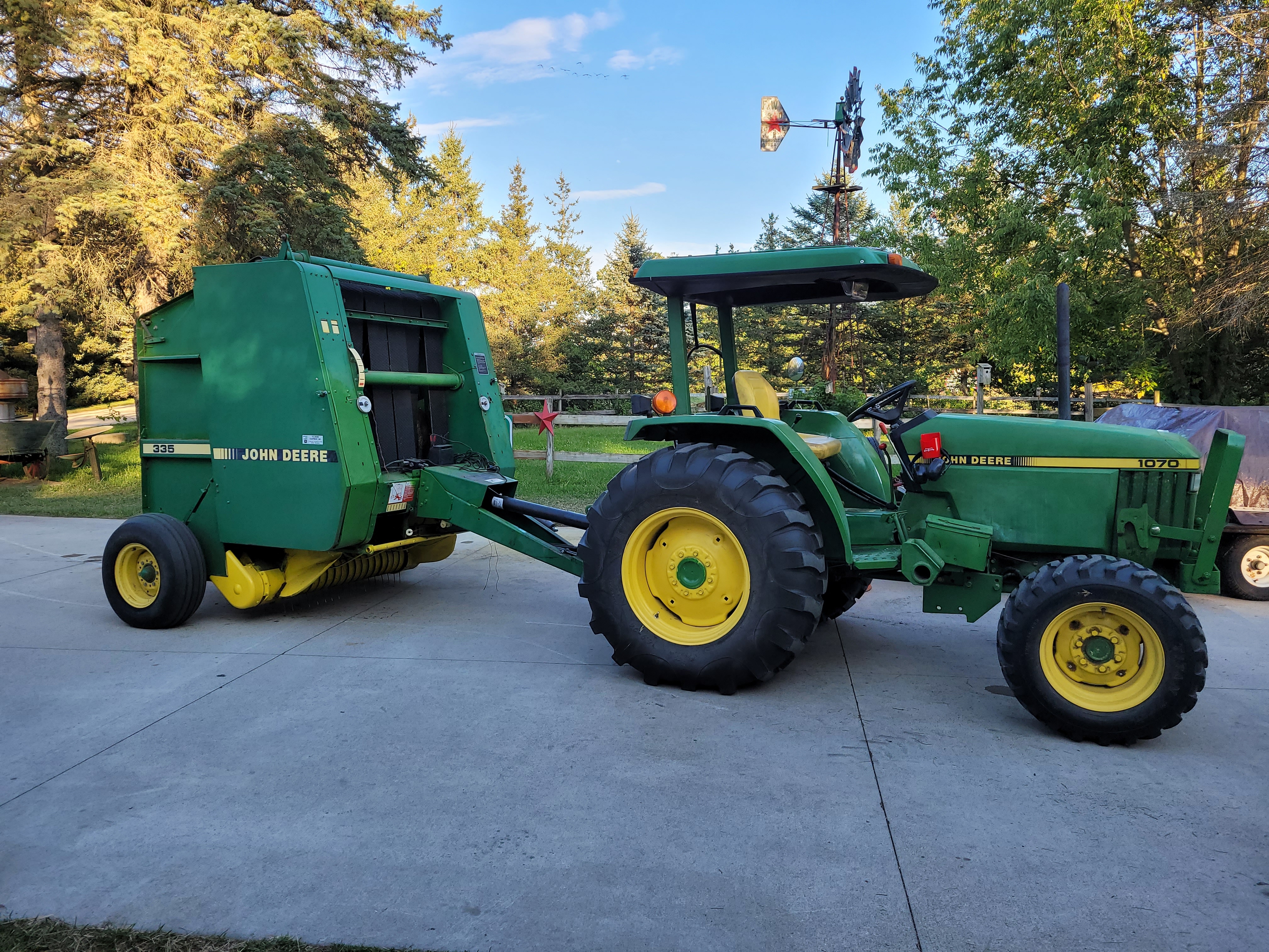

I agree. My 35 hp JD easily rolls my 4x4 variable chamber bales while running in 2nd range, 3rd gear. These weigh more than the 4x5 bales I struggled to make with my Vicon 1210 fixed chamber machine. So, the process is a large factor in this power requirement. As for comparison with square baling, I never was able to run this ground speed on my JD 14T. 1/3 the wall-clock time with the 335 to do the same field.
