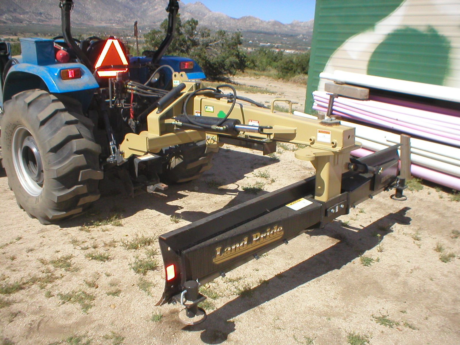

Well - I've found that the rear blade will just bounce along behind my tractor in the summer and aggravate any problems that exist. My driveway is not a soft, spongy, even - gravel surface. In the summer it sets up just like concrete - including pot holes, large rock and all form of other anomalies. I tried to do summer maintenance with the rear blade for 27 years and finally gave up and got a land plane grading scraper (LPGS). What a completely different experience with this new implement. No more bouncing around - it just lays flat and smooths everything out.
If you plan on doing summer driveway maintenance with the rear blade - figure a method of adding weight to the blade and forget about draft control. Weight will definitely be your friend when using a rear blade.

This is where gauge wheels or a land plane comes in. When I redid my drive I really fought it. The tractor I had then the 3 ph was either up or all way down. I had more whoopdedos than a motocross track. So I built a land plane drag. It lays flat on the ground for 6'. The 3 ph lets it float so no matter what the tractor does it stays on the ground. The longer the better. As the LP glides it bridges it's self across the high spots and fills the lows spots. 2 or 3 trips is all you mite need. Then you can go back with a blade or a rake set o an angle and put your crown on it towards the center.

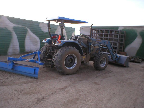

Based on this statement, why do you think that it does not work with a rear blade and grading? :confused: As long as the system is adjusted-setup properly, then why do you think that it doesn't work for grading? There is still a load put on the implement, you just set it up to be much more sensitive than when plowing.
Draft control does work with a rear blade, been there done that and still do it. I did it with my first 8' 680lb rear blade and I do it now with my 9' 1140lb rear blade.
   / Does Draft Control have any use for blade work (or is it mainly for plowing)? #20
My guess is that many of you guys who say that Draft control does not work for grading either have never used it to do any or are not sure on how to set it up properly. All I know for a fact is that it sure does work for me. :thumbsup:
It was mentioned that it will create wash board, well it does in a sense, the blade is consonantly raising and lowering about 1 /16"- 1/8" and extremely fast when doing a very light cut, or a cleanup cut. With any heavy cutting such as in the picture, maybe 1/4", at most, actually not really noticeable at all without actually looking for it.
Do you guys think that the 3pt raises inches when plowing, pretty sure it does not unless there are actual obstructions. It does not take all that much to lower the draft load and allow the tractor to continue moving forward.
Just my :2cents:, take it all for what it's worth. ;)
