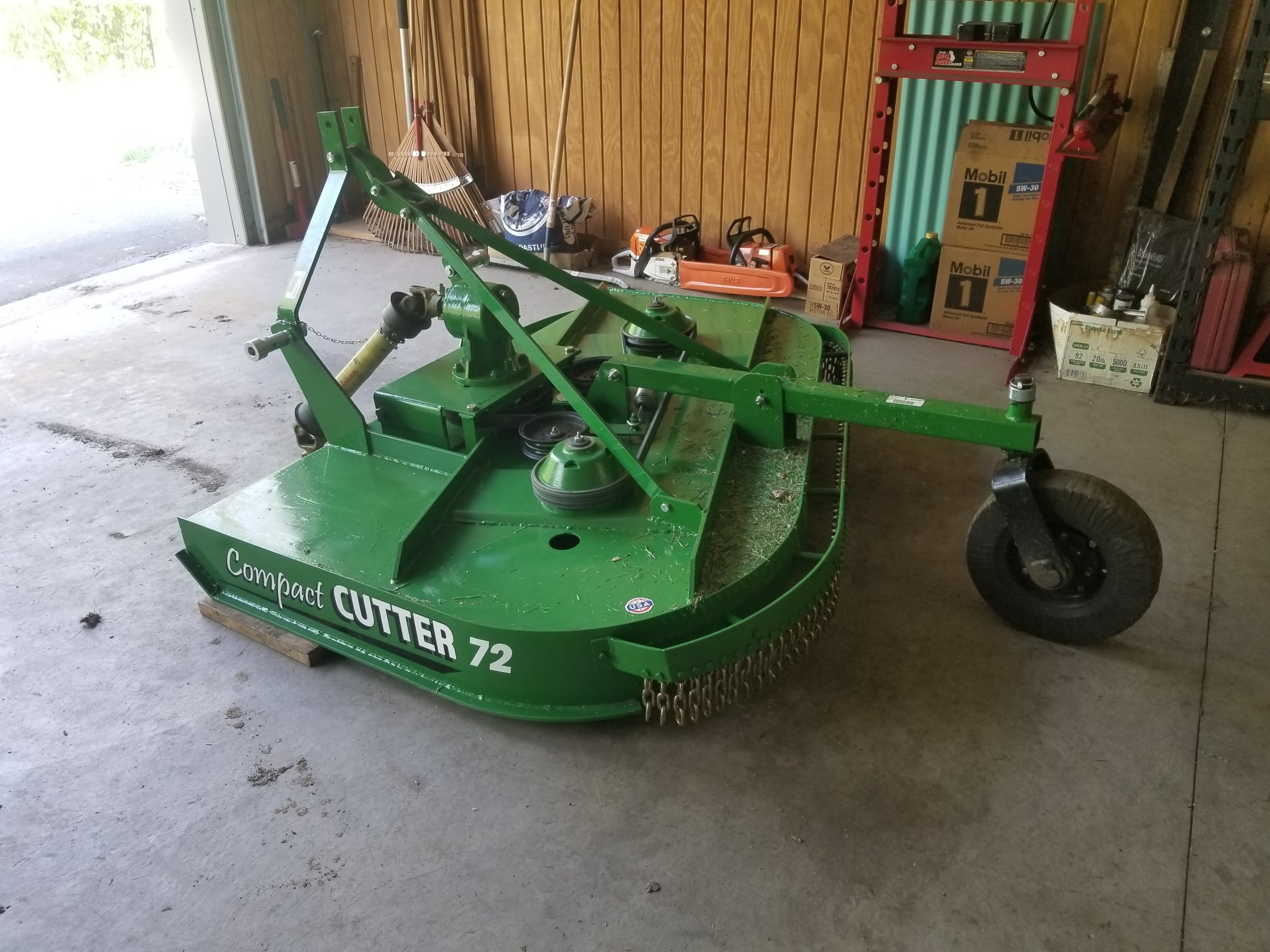

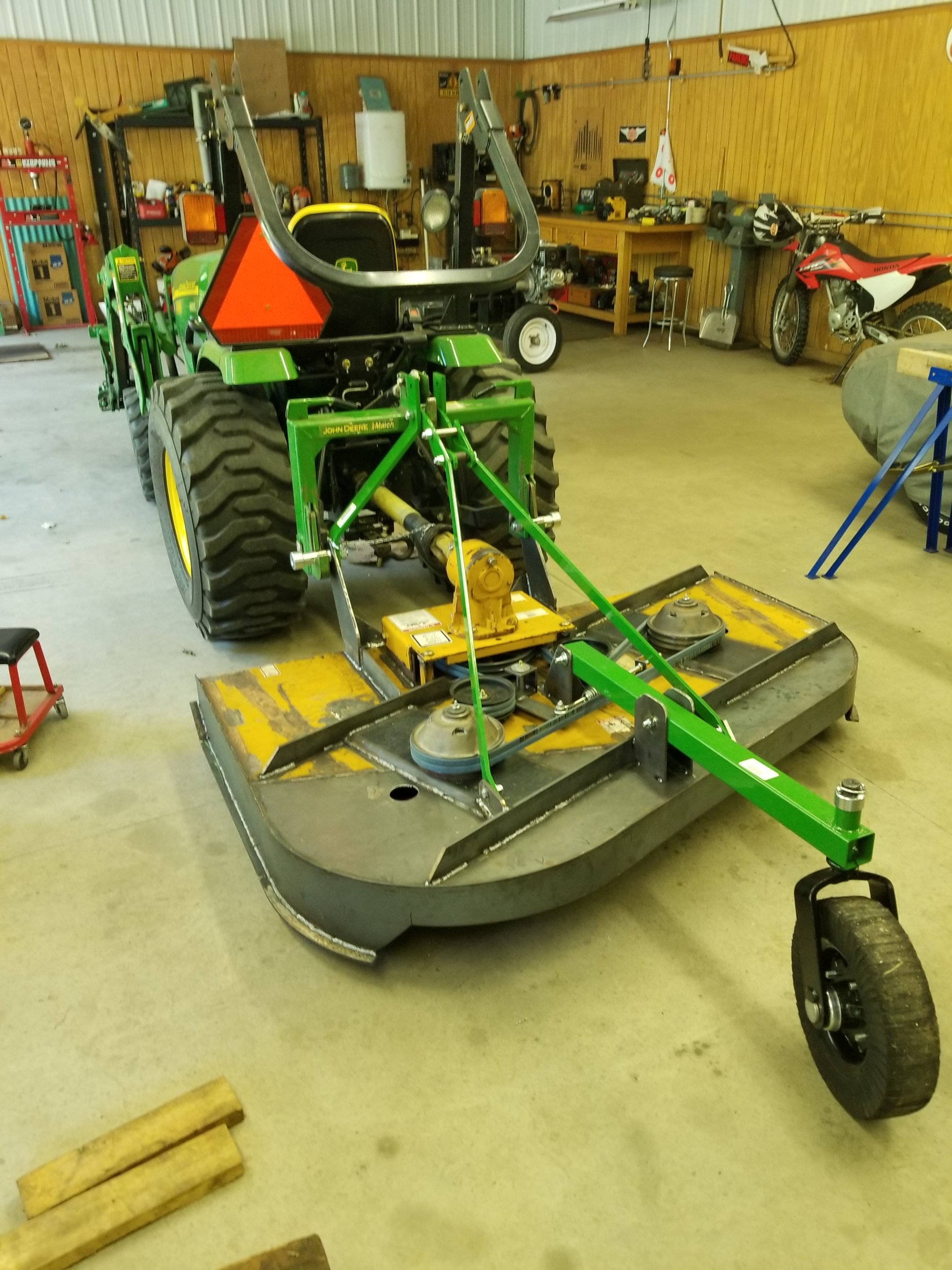

Absolutely right. I have a compact tractor with 20hp pto. NOTHING out there short of single spindle rotarys and finish mowers (I dont have the power for a flail).
So what does a former tractor/mower engineer do in retirement? He builds a prototype mower!
Built from an old beat-up used Keen Kutter 3pt finish mower, it has two 3' dia swing blades/stump jumpers from Fred Cain. It has staggered conventional CCW rotation spindles.
The mower is offset to the right so BOTH tire tracks are back swept. I've been mowing all spring with this thing and it has exceeded my expectations. I knew it would cut well but was concerned my tractor could run it. It does! I routinely cut 20" down to 4" without slowing.... at a full 6' cut width! Because it is mechanically back sweeping the tire tracks, it didnt need high lift blades or high tip speeds... both huge power hogs. Somebody needs to make these for sub-compact and compact tractors!

LOVE the cutter, nice work!
Your 2520 appears to be standing tall also.
Any idea of the weight?
