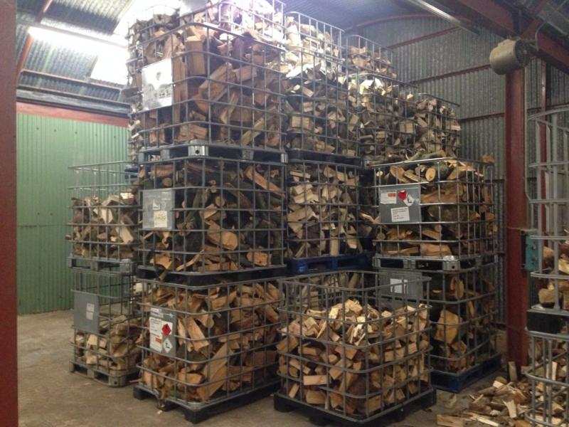

Where we are in southern Spain, firewood is at a premium - not too many trees around and all the pine is protected! A lot of people here have started using old IBC cages - the metal cages fitted to pallets which have a liquid tank inside. They take the tanks out, leaving the cage and then fill it with chopped wood. Like your system, it can then be left to season and is easy to move around with pallet forks later on. It's also nice and easy to take into the woods on a trailer to load up when no one is looking...!

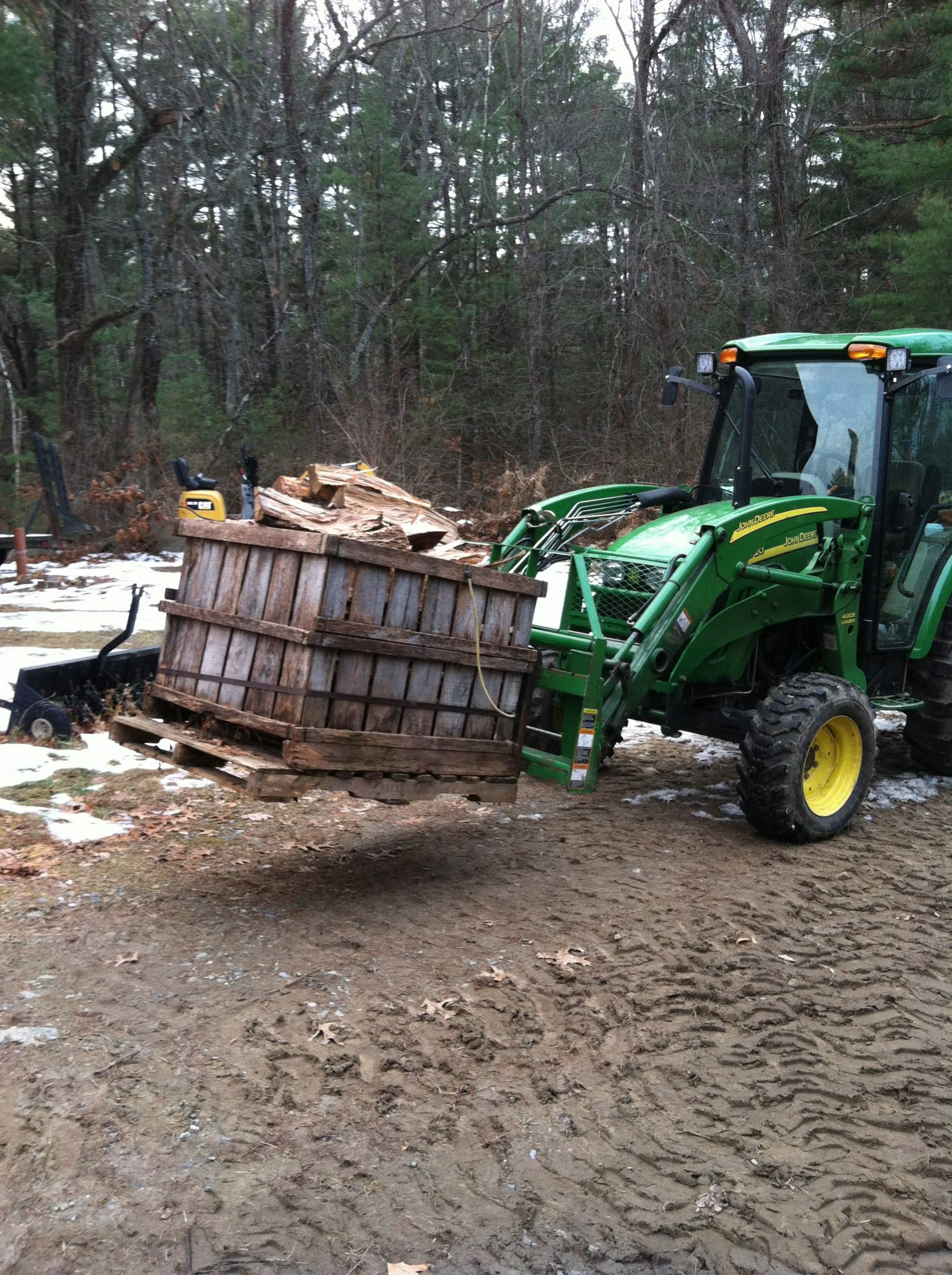

Here is my alternative to pallets-old orchard boxes. No problem with trying to neatly stack a pallet so it doesn't immediately fall apart when you move it. As you can see in the picture, I do put the boxes on pallets because the boxes I have are very old and using pallets saves a lot of wear and tear vs. trying to pick up boxes directly with forks.

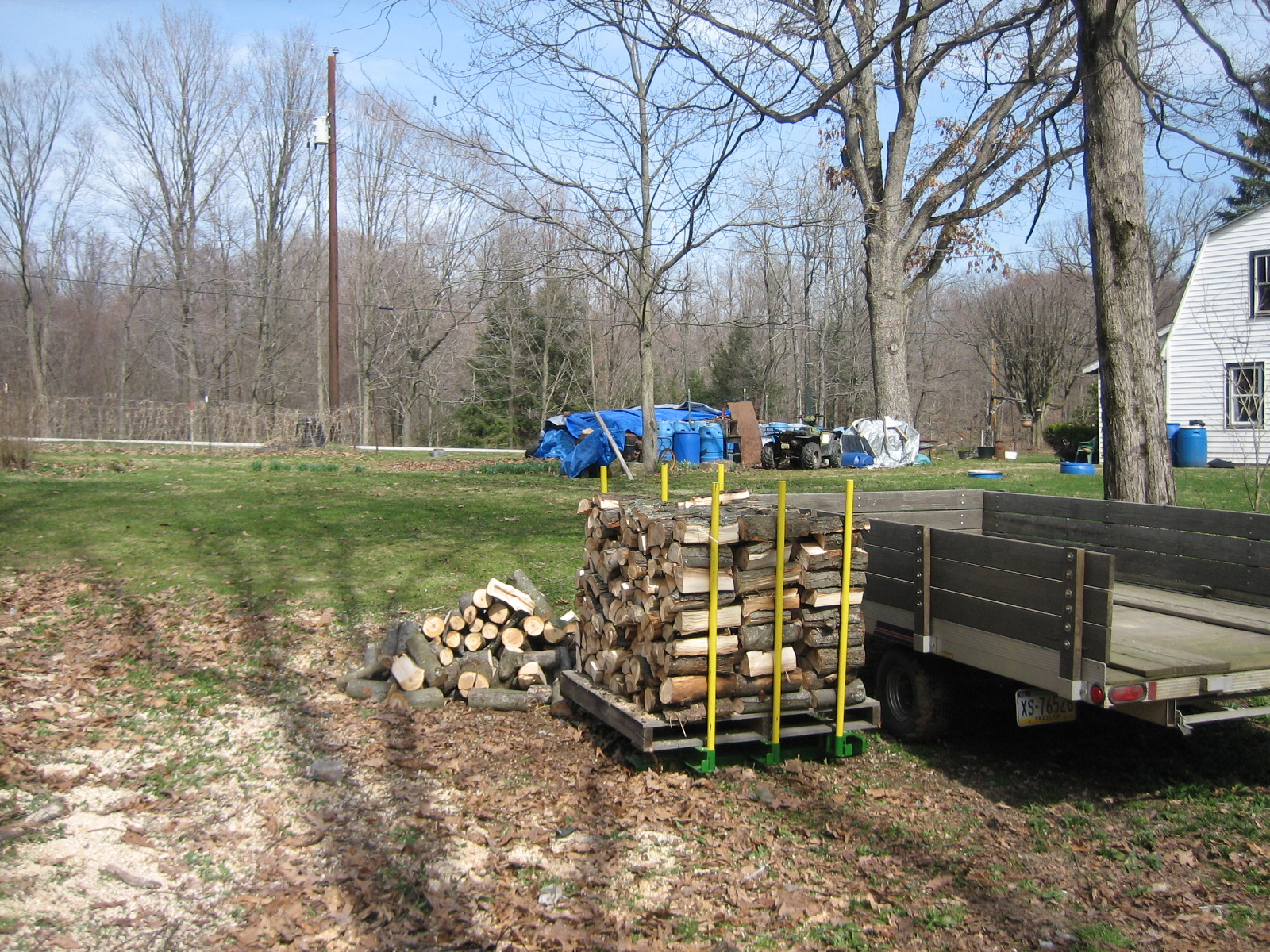

Since I am a newbie I need to show everybody the pallet/ holding fixture that I made for a friend several years ago. It works like this. Put a surplus pallet onto the fixture, I think I made it to hold one that is 48" 48 ". Load it with wood as shown. Lift it up the fixture with your tractor forks. The fixture has fork access from either side if I remember correctly. Use plastic banding on each row. Set the fixture and skid back on the ground. Pull out the pipe. Lift out the pallet. Put the pipe back in and start again. My friend needed to put the wood on his mother-in laws front porch for her kitchen wood stove. He would make up 15 to 20 of the skids for winter season. Just an FYI. Also I have never seen it work so I do not know what happens when the bands are cut loose. Later
