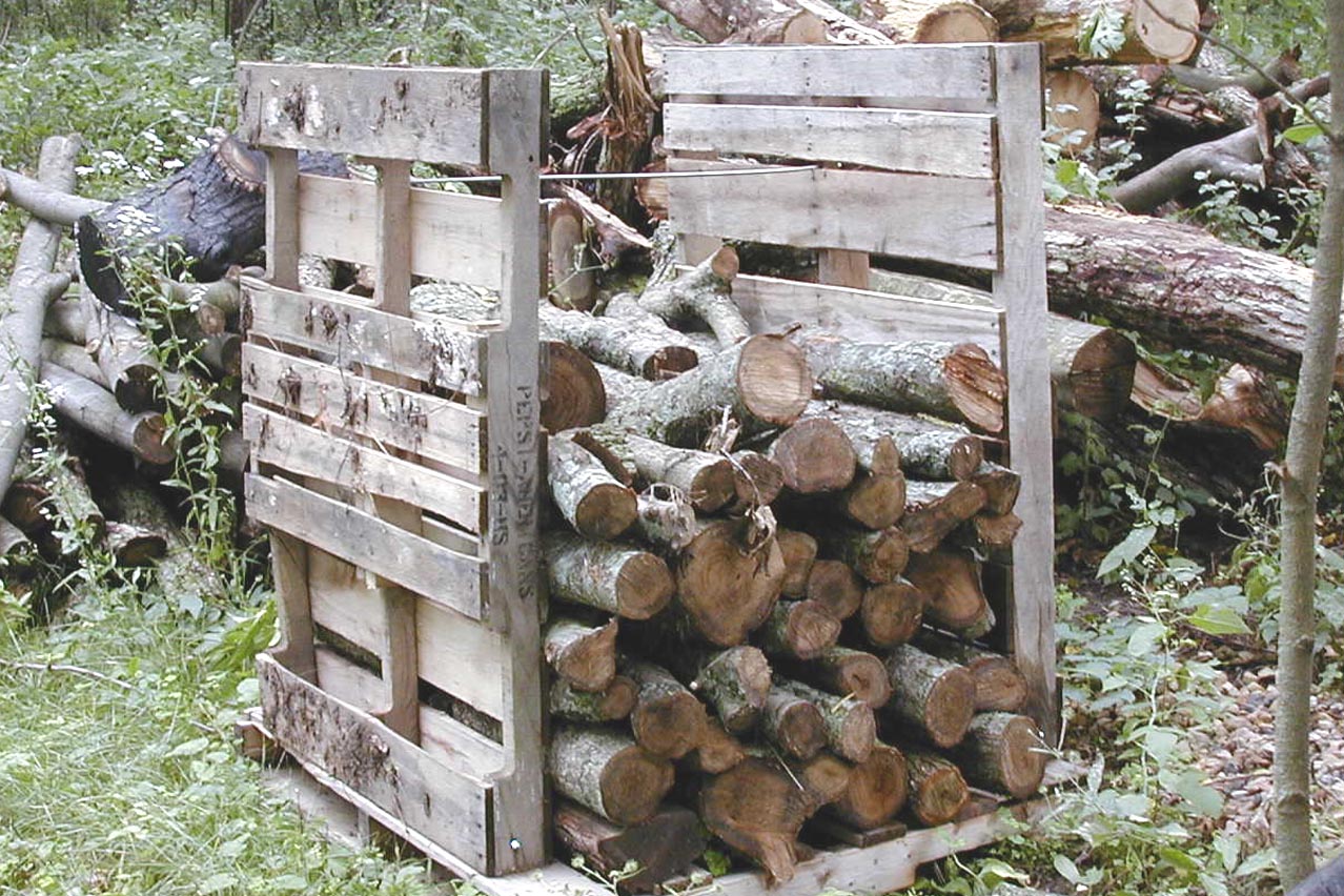

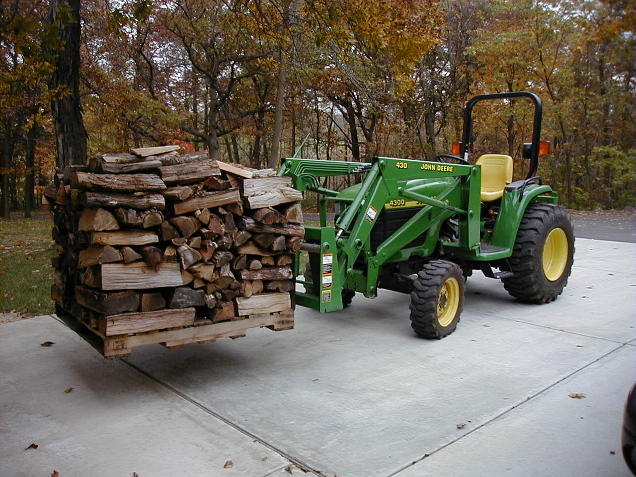

I split and stack directly on flat pallets, and put on about 1/5 cord on each. That is 6-7 layers of 16-18" wood, depending on how it is split. It is just about the right load for my Deere 4300 with the ballast box that I have, when the wood is fresh s;lit. The pallets are then stacked two high, and covered with a square of used rubber roofing to shed water from rain and snow. I leave the wood dry for at least two years for seasoned wood.
The round wood (unsplit) from tops, I put on a pallet that has two pallets upright for ends (held together with 1/4" threaded rod at about $2 per pallet). This routine works very well for bringing in about a pallet every 5-7 days, depending on weather. I burn right at 5 cords (or 25 pallets) a year.

Beenthere,
I would have the wood all over my driveway with the way I stack. I really need side supports for now. Maybe I'll get better at it in the future. It looks good though.

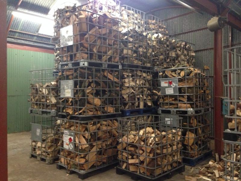

Where we are in southern Spain, firewood is at a premium - not too many trees around and all the pine is protected! A lot of people here have started using old IBC cages - the metal cages fitted to pallets which have a liquid tank inside. They take the tanks out, leaving the cage and then fill it with chopped wood. Like your system, it can then be left to season and is easy to move around with pallet forks later on. It's also nice and easy to take into the woods on a trailer to load up when no one is looking...!

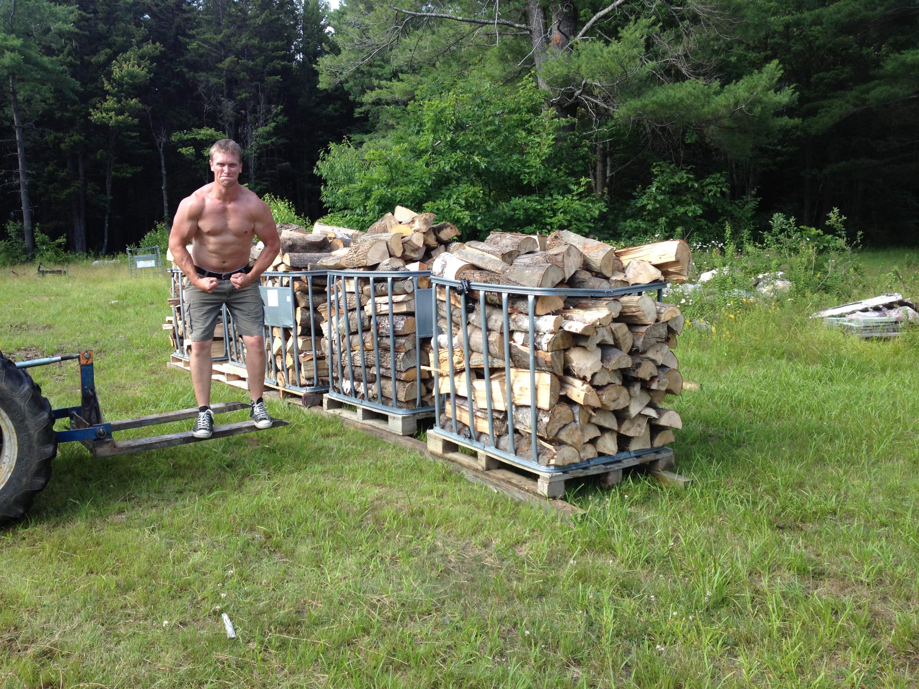

I use metal cages also but cut the end out of 1 side so I can stack it neatly which also make it easy to unload.
I get just shy of 1/2 cord by volume in each one.
I have 20 or so but need only 12 for a years worth of wood.
I mounted mine on wood pallets which makes it easier to handle without damaging the bin.
It seasons quickly and when ready to throw in I use my forks to pick it up to my chute and just drop on it and down it goes.
Having some back issues this works very nicely in eliminating a lot of handling.
When I split I stack it in the bins as I go.
The only photo I could find of my bins had my son showing off!
Doing my part in keeping him strong & healthy.

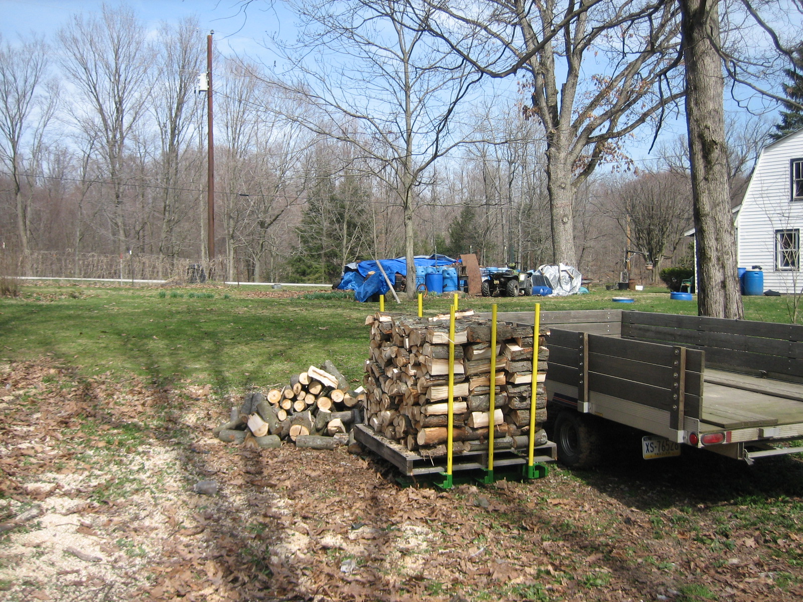

Since I am a newbie I need to show everybody the pallet/ holding fixture that I made for a friend several years ago. It works like this. Put a surplus pallet onto the fixture, I think I made it to hold one that is 48" 48 ". Load it with wood as shown. Lift it up the fixture with your tractor forks. The fixture has fork access from either side if I remember correctly. Use plastic banding on each row. Set the fixture and skid back on the ground. Pull out the pipe. Lift out the pallet. Put the pipe back in and start again. My friend needed to put the wood on his mother-in laws front porch for her kitchen wood stove. He would make up 15 to 20 of the skids for winter season. Just an FYI. Also I have never seen it work so I do not know what happens when the bands are cut loose. Later
