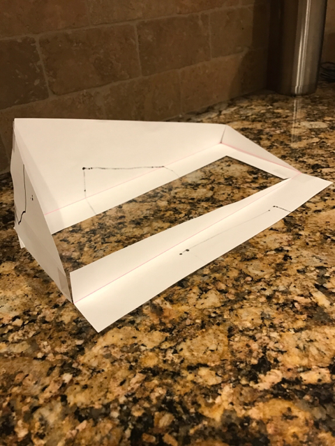

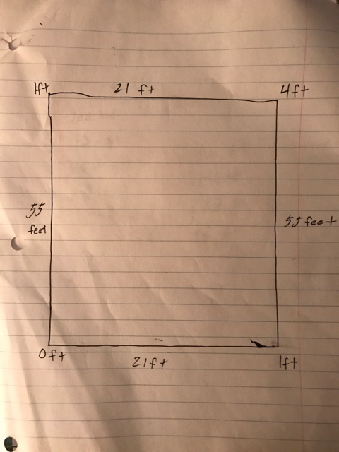

This started out as trying to come up with a semi accurate amount of fill needed to fill a retaining wall. I've been unable to figure it out and it's turned into a personal mission. The shape has a rectangular base with one side being 4 feet high with the adjacent corner being 0 feet high. The other adjacent corners are 1 feet high. The rectangle is 22 feet by 55 feet. The only number I've came up with is 67 cubic yards. Here's a paper model I built.View attachment 496267 Here's a drawing of the dimensions if it helps. View attachment 496268

None of the plane geometry formulas will work for this one. The slope of the 21' ends are equal but the slopes of the 55' sides are different. Because of this, you can't just use the average heights.
A 3D model shows a volume of 62.715 CY. Add a factor for compaction based on the type of fill and you've got it.
But since we're talking dirt by the truckload, the difference between 62.7 and 67 cy isn't much.
Good luck with it.

The sides aren't 21, they are 22.
   / Does anyone know how to calculate the volume of this figure? #26
That dyslexia will get you every time.
67.07 CY

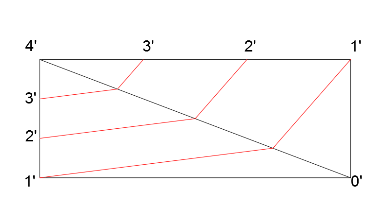

Here's the topo based on a 1' contour if you like.

So the OP has 22' listed in the post but 21' on the sketch -- which is it??
I get 64.17 yards if it's 21' or 67.22 yards if it's 22'.

It's actually going to be 24 feet because we may build a pole barn over it in the future and 24' trusses are cheaper. The original sketch ( not pictured ) was 21x52 and I increased it to 22x55 for increased margin of error.
