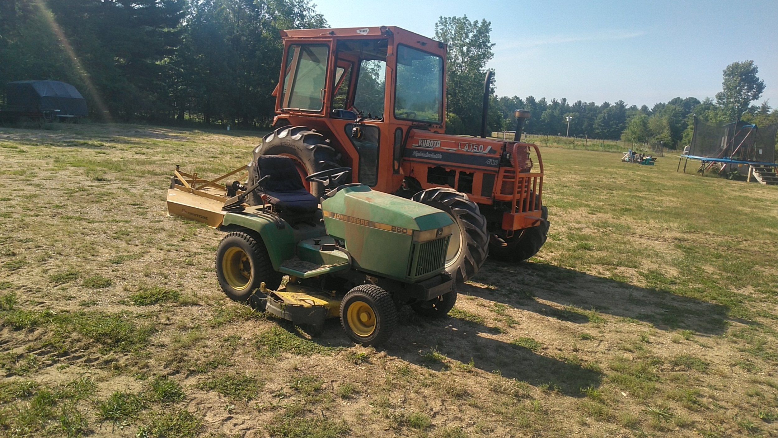

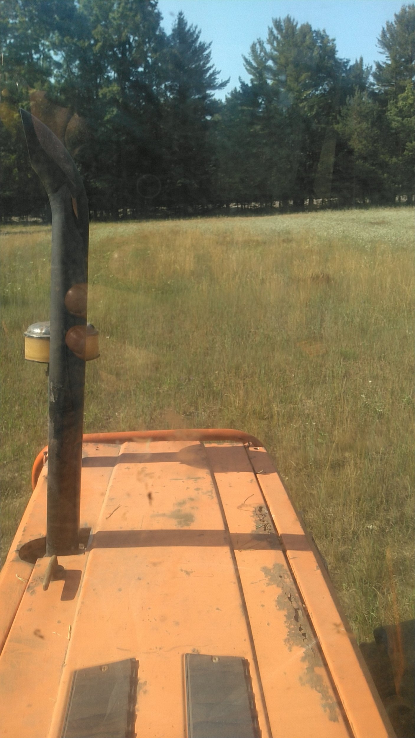

Here's a used up (cheapest cab tractor I could find at time) only had to replace the rad and built front grill guard bumper, yooper rigged hydraulic clutch shifter. hogging 10 acres +Xmas tree rows problem free for over 5 yrs now, only regret is it's impossible to find a parts tractor for it at scrap prices cause they apparently don't die lol.
