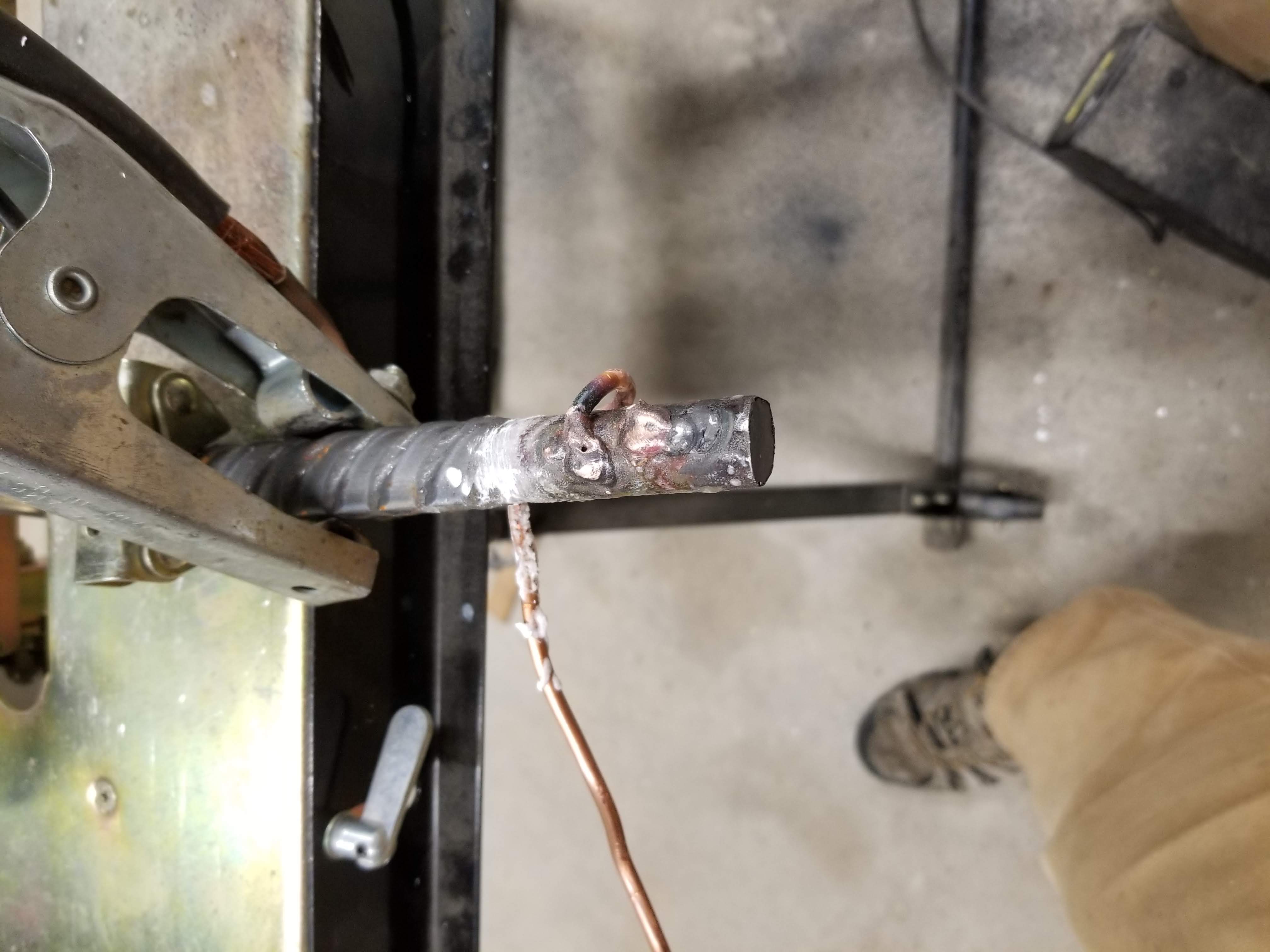

Speaking of TIG brazing, can anybody comment on silver soldering with TIG? I need to connect some copper to steel.
I have some rebar I've welded up to reinforce the foundation & anchors that will eventually be buried in concrete for a HAM radio tower. I need to attach some copper to that rebar for grounding. I have the TIG welder, but no acetylene anything. You need to use high temp silver solder or such as normal solder can melt on you in a lightning strike.
I'm trying to figure out if I can get the job done with my TIG welder or need to beg, borrow or buy some acetylene rig. I've got some appropriate silver solder & flux. I assume I'd need to use at least a bit of argon to keep the tungsten clean. Not sure if the flux would help or hurt.
I've cleaned up the rebar well where things will connect up. Haven't done any testing yet on scraps & looking for advice before I get to that step.

I think I'd use a normal grounding clamp .... of the screw clamp type that is commonly used to connect copper ground wire to the grounding rods for household current. Home Depot...I think that would stand a better chance of surviving long enough to pass the high current in a lightning strike. Corrosion and conductivity reduction probably don't mean much to a bolt of lightning that has just jumped a mile through atmosphere.
However, if you prefer to use TIG it won't be a problem. Copper welds to steel fairly well. No solder needed. You may find that using an intermediate bronze or copper rod in your other hand will help the weld. Use the heat of TIG arc just as you would use an acetylene torch, NOT letting the flame or arc ever touch the area you are welding until the weld is done and it is time to add a little heat to the surface to smooth things up.
I've not done large silver solder (silver brazing) joints like you propose, but have silver soldered copper to steel. It's a natural easy joint. If I was dead set on using silver bearing solder like you are suggesting, then I'd clean and prep the joint, coat it with flux and wind the joint with some of the silver soldering wire. Then strike an arc an inch away from the joint and let the heat flow to the joint. That way you get clean heat to do the work. Oh, and have a piece of silver solder in your other hand to stir the joint as the metals begin to flow.
Naturally it makes sense to practice first.
good luck,
rScotty - ex K5EZK
A quick blast with the TIG torch & the copper welded to the rebar. It was almost disappointingly easy. I was trying to heat up the test chunk rebar to try soldering it on with some silver solder & accidentally got a good weld before I knew what was going on. Repeated it several times. Had some brazing flux on there, may need to up the argon and/or use a bigger cup. Copper got a hair thin on the first one & I broke it off just past the weld when I bent it a couple times.
Congratulations on trying it. To make the joint less likely to break, it helps to stabilize it somehow. One way woud be to go ahead and use the standard grounding clamp to hold the ground wire to the rebar, and then weld the end of the copper that sticks out past the clamp. The most common type of grounding clamp would do that nicely.
Alternately or also, you could also flow some brazing rod around the whole welded joint - standard rod will flow nicely to coat and cling to both the copper and the steel ....as long as you don't get the steel too hot!! Dull red is plenty.

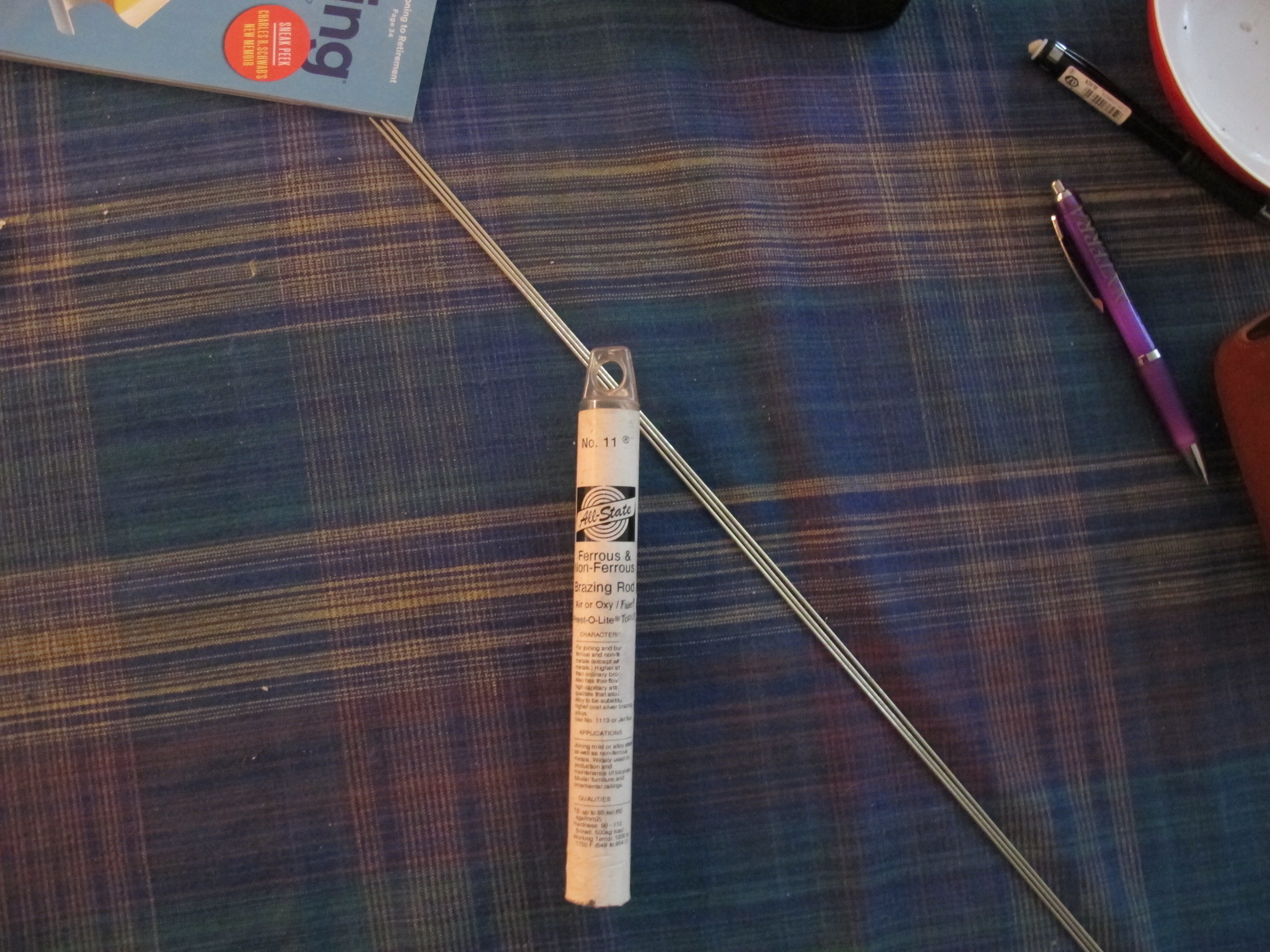

The best tool for putting on tht sort of heat that would be an acet/oxy torch set with a slightly soft flame about a quarter inch long. For TIG I'd use remote heat. The brazing rod can be either a standard low fuming brazing rod, or for even better results use a rod with 10% nickle in it such as All State #11. in either 3/32 or 1/8" size.
I like that rod for general brazing as well. It is stronger than low fuming bronze and a little more expensive, but not a whole lot more $$ than regular brazing bronze or silicon bronze.
Just to make things a little more confusing, the welding industry also often refers to this 10% bronze alloy as "nickle silver brazing rod" - probably because of the color. There is no silver in it at all, and it takes a standard borax brazing flux rather than the special flux used for real nickle silver.
BTW, if you are using brazing flux there isn't much need for more argon.

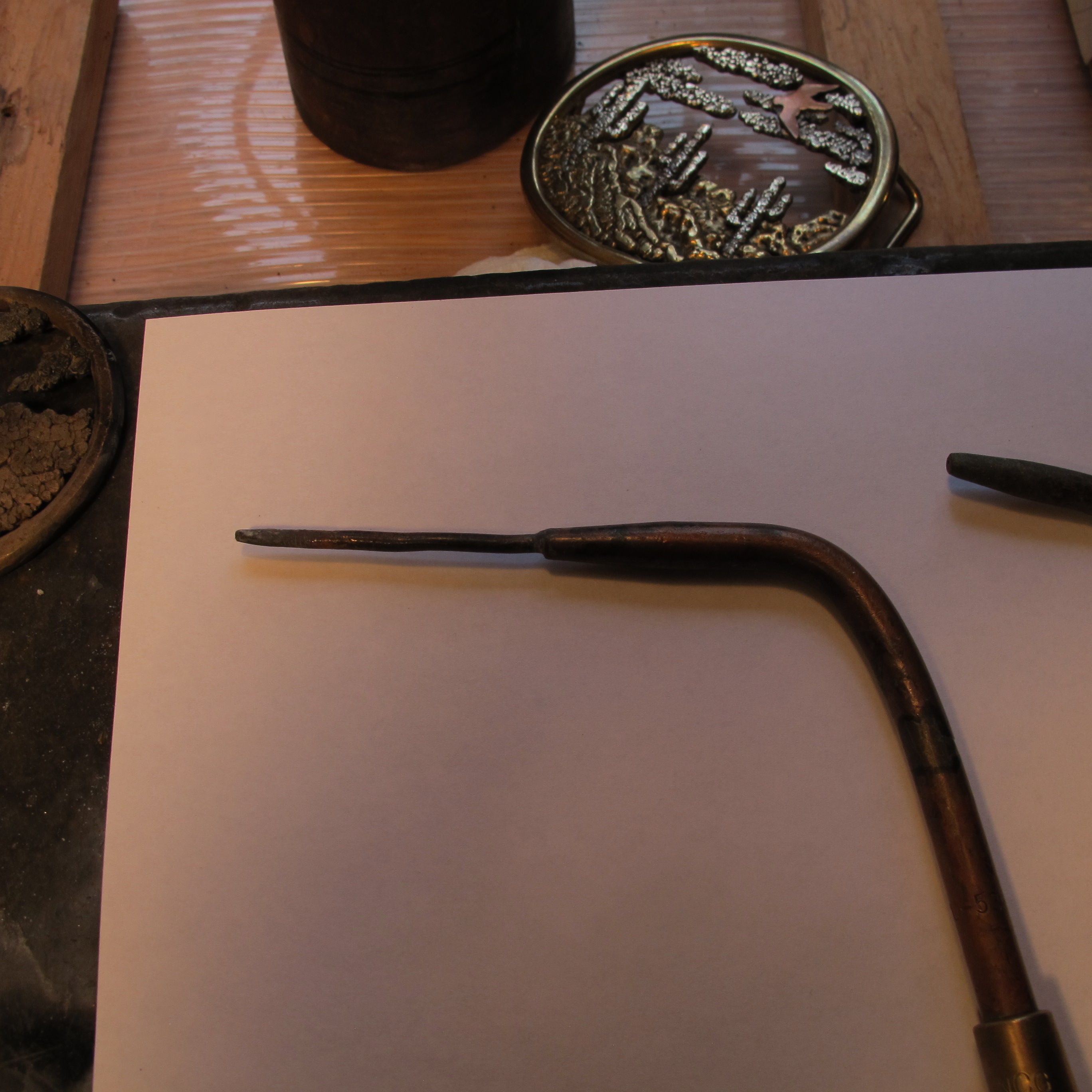

Here's some more photos.

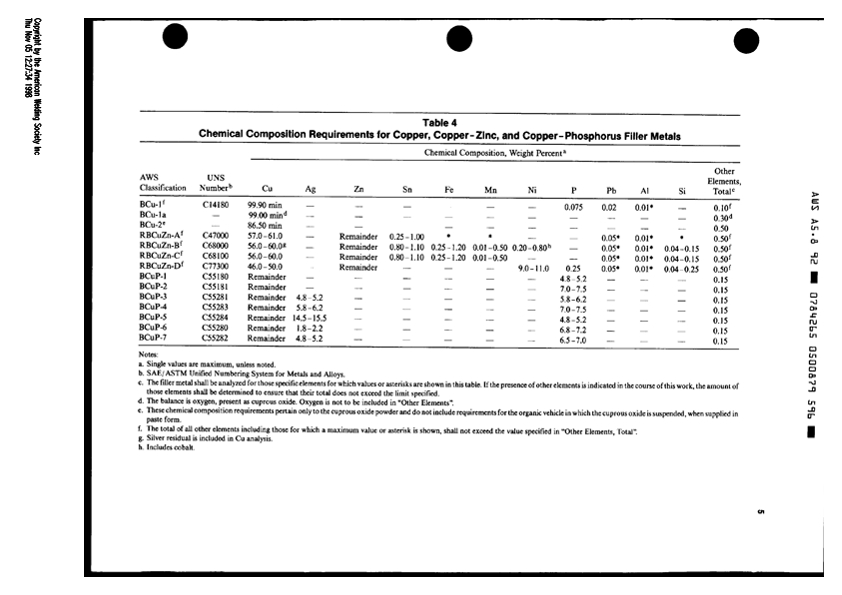

Here are two charts from AWS A5.8-92. This is an older version AWS as newer ones cost you $75. Finally found a way to convert to JPG as the AWS is in PDF and moving it corrupted something. These ID are how the various alloys are commonly identified and ordered. One is the silver alloy types and the other the copper alloy types. As I find old stuff in my files I will share now that I can convert PDF to JPEG in another manner. I think proprietary documents often have things embedded to thwart guys like me.
View attachment 624021 View attachment 624022
Ron
You can go to various filler metals company websites and they will break down the B-cup's for each silver product. I'ts a little more clear when you are looking at a specific product like the HVAC # 15% that's so widely used. Harris and Weldcote spell it all out individually. I have this chart too. I'll look into getting a freebie on anything newer.
