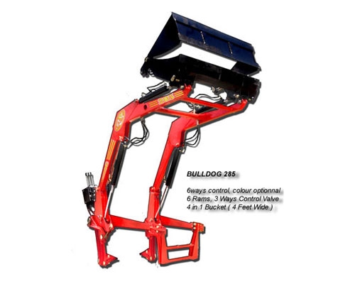

Back in the day, BullDog brand was hammering the market with a reliable loader where nobody could touch their prices. Today, try to find a loader complete and new for under $5,000 install on your machine. Impossible.
/ Does anybody know if some spool valves are generic? #7

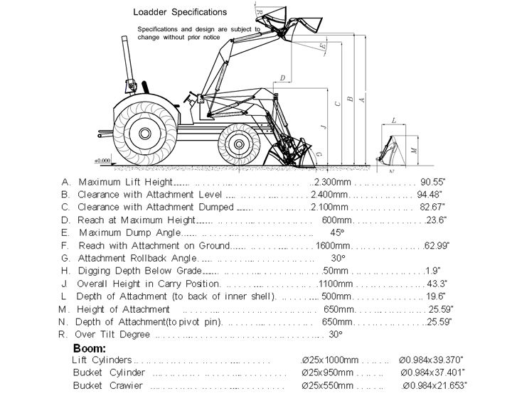

BTW, LCI offered the BullDog in regular controls and 6-way controls.
From their old archived site, here is the regular,
