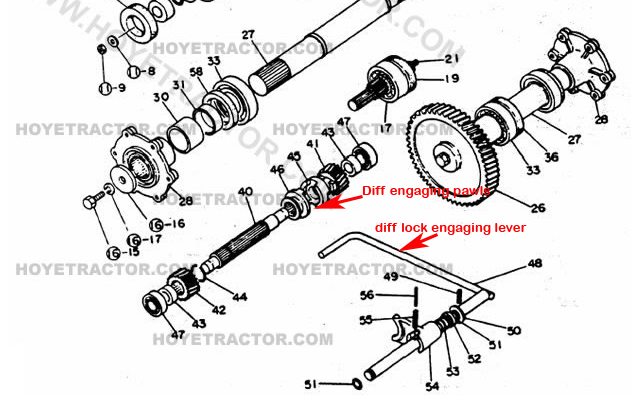

Below is an internal picture of the diff lock and rear axle parts breakdown for a 1500.
Mike

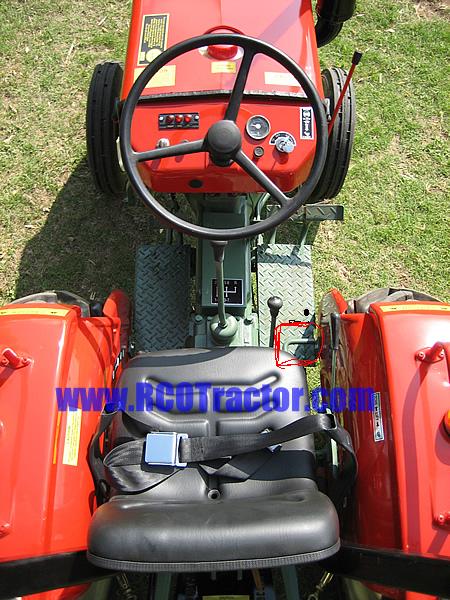

Mine does. Lever is down by the right foot.

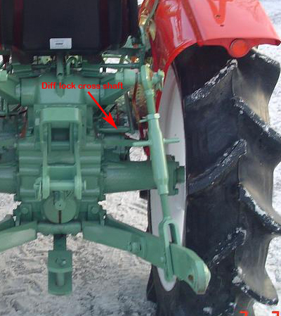

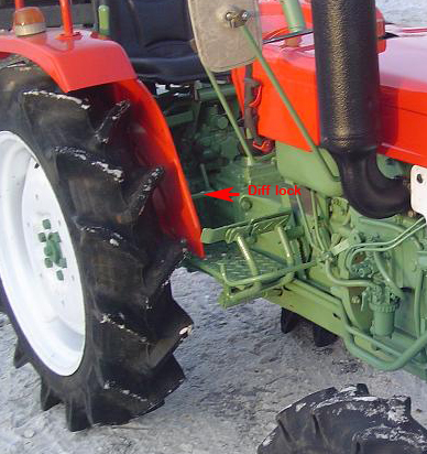

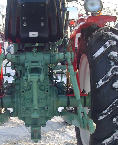

I have included a couple of pictures of a 1500 that I believe show the Diff lock pedal and the cross shaft.
Mike
