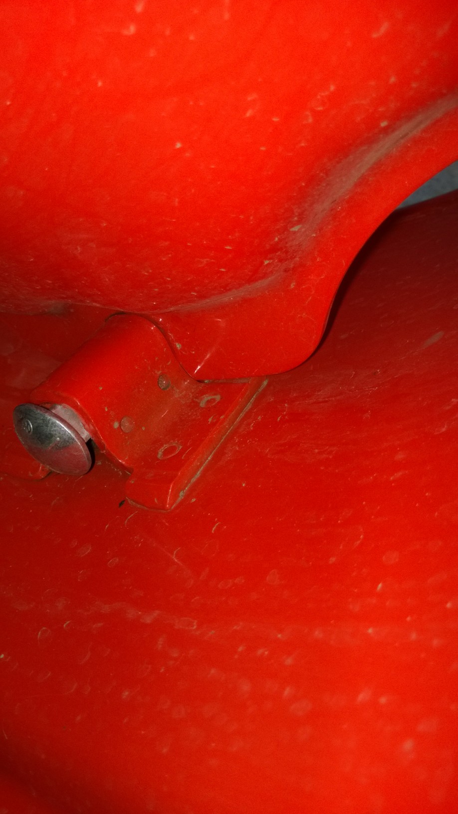

My dealer wanted $650 to come out and do 50 hr service. So I passed.
I had lug nuts very loose so be sure and check yours. I should have checked mine at the 5 hr mark probably.....
Plus I happened to notice about a third of the rear wheel bolts were not seated correctly by the dealer. Easy fix but just more setup stuff that's needed attention. Here's one.
Another reason to do your own service and check your own machine. There are some dealers with great service depts. but no one cares as much as you do or you should for YOUR machine.:thumbsup:
