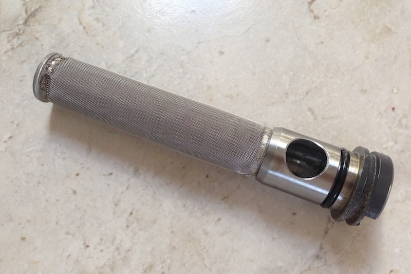

Okay! Finished my 50 hr. Went pretty smooth but took awhile. Next time will be faster. My issues were:
Filter wrench wouldn't get small enough for oil filter. Solution: Went to NAPA and got a wrench cap and one for the transmission filter too. Went old school to get it off before purchasing them (one also for the transmission filter). Used the 'old screwdriver hammered into the filter trick' to get it off. Who has done this before on their care or whatever?
Had to drop the BroTek skid plates both mid and aft. That was easy but wrestling with them afterwards getting bolts to line up was a bit of a struggle. Next time I will do better. Did not remove them completely. Just the back end bolts for each and they rotated down enough to access filter.
Removed the left rear wheel for easier access. Pulled the transmission strainer out and had an assortment of tapered corks ready to plug it. Second try got it... almost lost the first one in the hole :eek: yes, lost some fluid but figured some refreshment of new oil couldn't hurt. Some fine shavings on filter but not much so I figured a complete flush was just a waste of money. Was thinking there might be more metal chips based on comments previously read on TBN. Here is a picture of the strainer... I hadn't seen any pics of this previously. I should have taken a before and after pic. This is after I cleaned it. Didn't bother to remove the drain plug.
Didn't spill but a few drops of engine oil but the transmission side was a little messy. Have a drop cloth under your large catch pan for the rest of the errant drops and runoff especially if you are trying to preserve your cement garage floor and have skid plate partially installed. The oil will catch on the skid plate and pour through the access holes when removing the filter. I got spots... oh well, it's a garage.
I'm sorry I'm a little slow this morning. Did you change the hydro fluid or just try to catch what leaked when you changed the filter and cleaned the strainer? I'll be looking at doing this in the fall so I'm learning from everyone else's experiences.

Vacuum cleaner on the fill port of the transmission and you will NOT spill a drop next time!:thumbsup:
