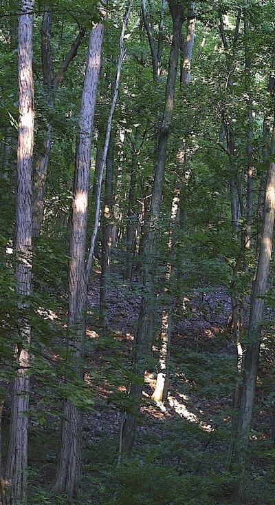

I mostly cut standing dead trees-and the ones Mother Nature drops for me:thumbsup:
If it is accessible with the tractor and wagon, I cut and split where it lays. Before felling, I put a few lengths of deadwood across the estimated drop line, and the tree is supported for bucking. If i miss, I use the cant hook.:laughing:
attachment.php
If the future firewood is up on the hillside, I use wire rope and a snatchbock to git 'er down to the Bucking Zone.

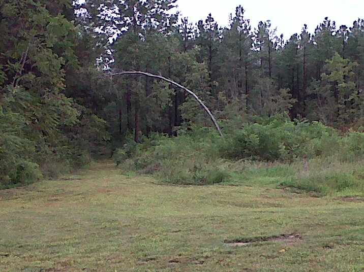

I have not felled a tree yet. I am only processing the good scraps the loggers left, and the stuff that is falling. I'm going to cut down my first trees probably this weekend (I have a couple vacation days) (if the wife let's me have any tractor time) and I will start with dropping the snags and broken trees that snapped 10-15' up.
For example in the pic below, that bent over poplar snapped off last weekend at about 12-15' up.
I have many, MANY cords of wood on the ground now...
