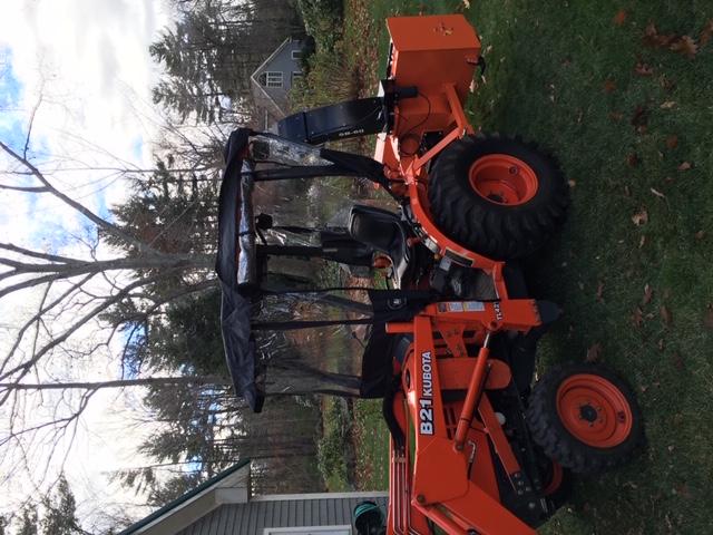

I use them golf cart canopy on our L3830 for a winter.
It worked well, I was able to blow snow in a sweatshirt, but it was not sized the way that they said it was in the ad, so it did not fit properly and chafed around the edge of the canopy.
It also did not come down quite far enough oh, so there was about a foot between the floor of the operators platform and the bottom of the canopy wall. That meant that my feet still got covered in snow.

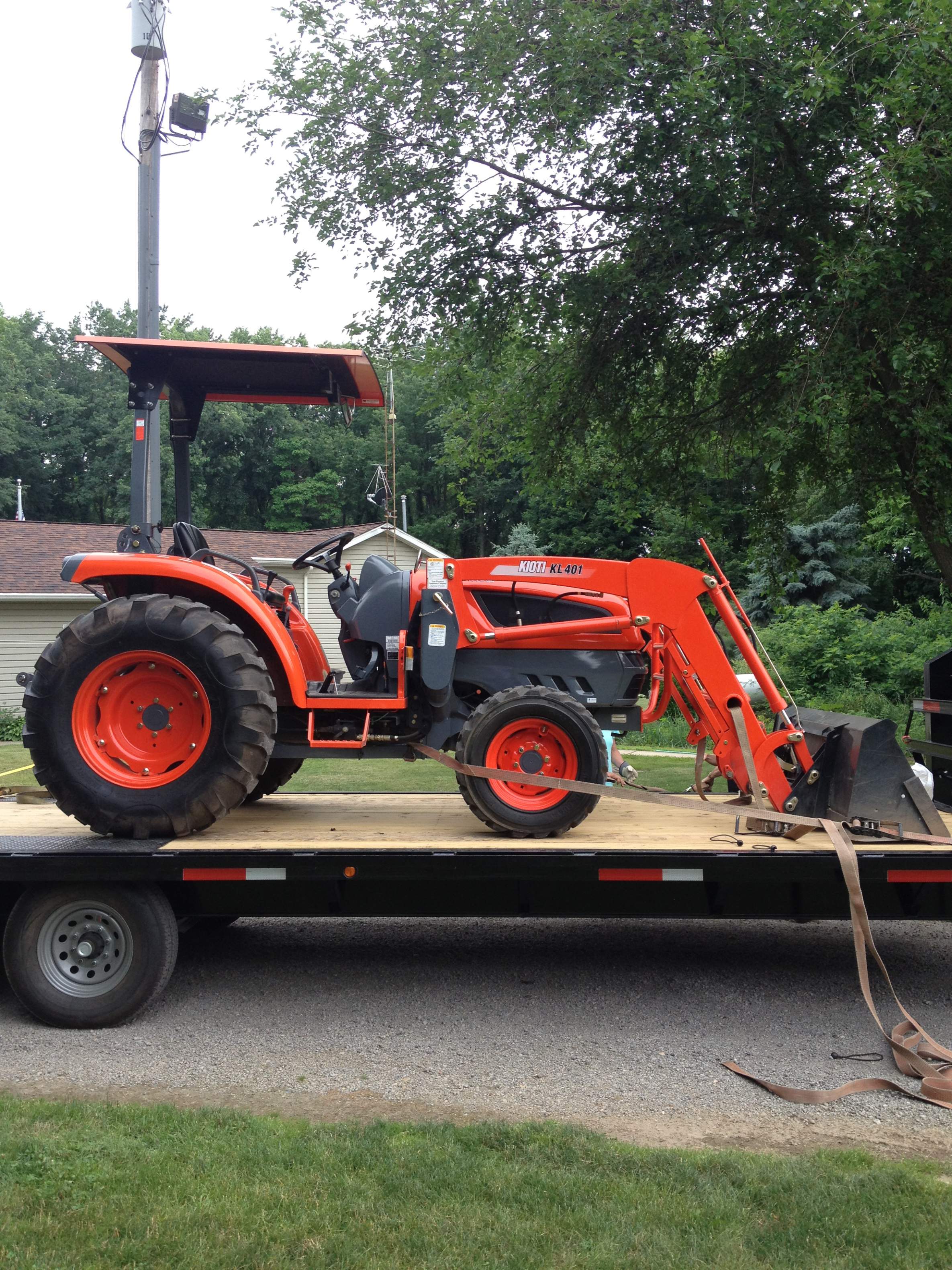

I had a steel canopy on my previous BX25. The BX25 is too tall for a standard 7' garage door. The steel canopy was too hard to remove when I wanted to garage my tractor. I bought a BX23S and a Tuff Top tractor canopy to go with it. It is a light thermoplastic material (metal frame) and the canopy can be removed or installed in less than a minute. It has several tilt angles. I like it a lot. I have run into tree branches with it without damaging it but better not to run into them. It's not really a FOPS but will have some fall protection. Also, it's an economical buy.
