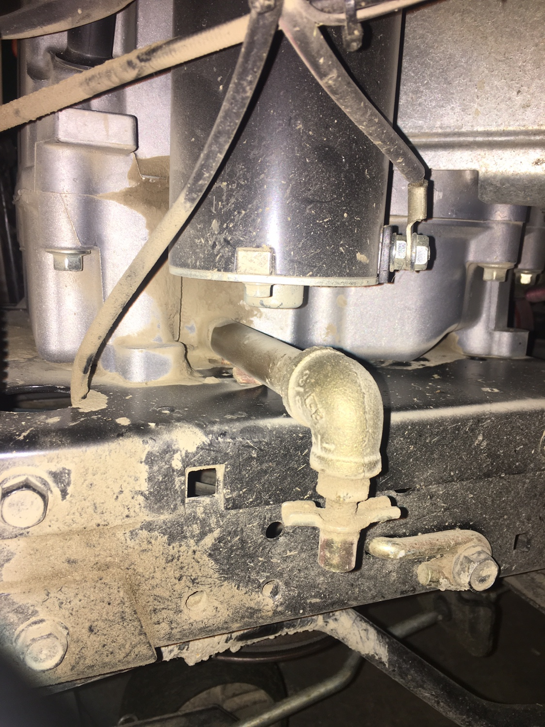

On the mower I got rid of the factory quick drain, it came apart too easy, and replaced it with this.
