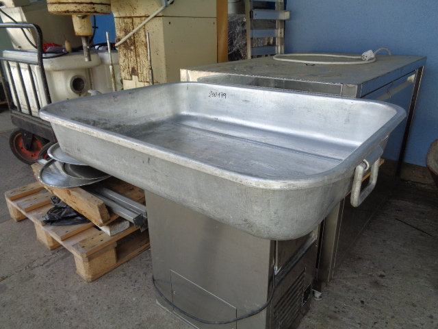

I got a used meat pan/carrier to catch any spills. My old Honda motorcycles have cartridge filters, there is no way taking them off without spilling. This pan catches it all.
