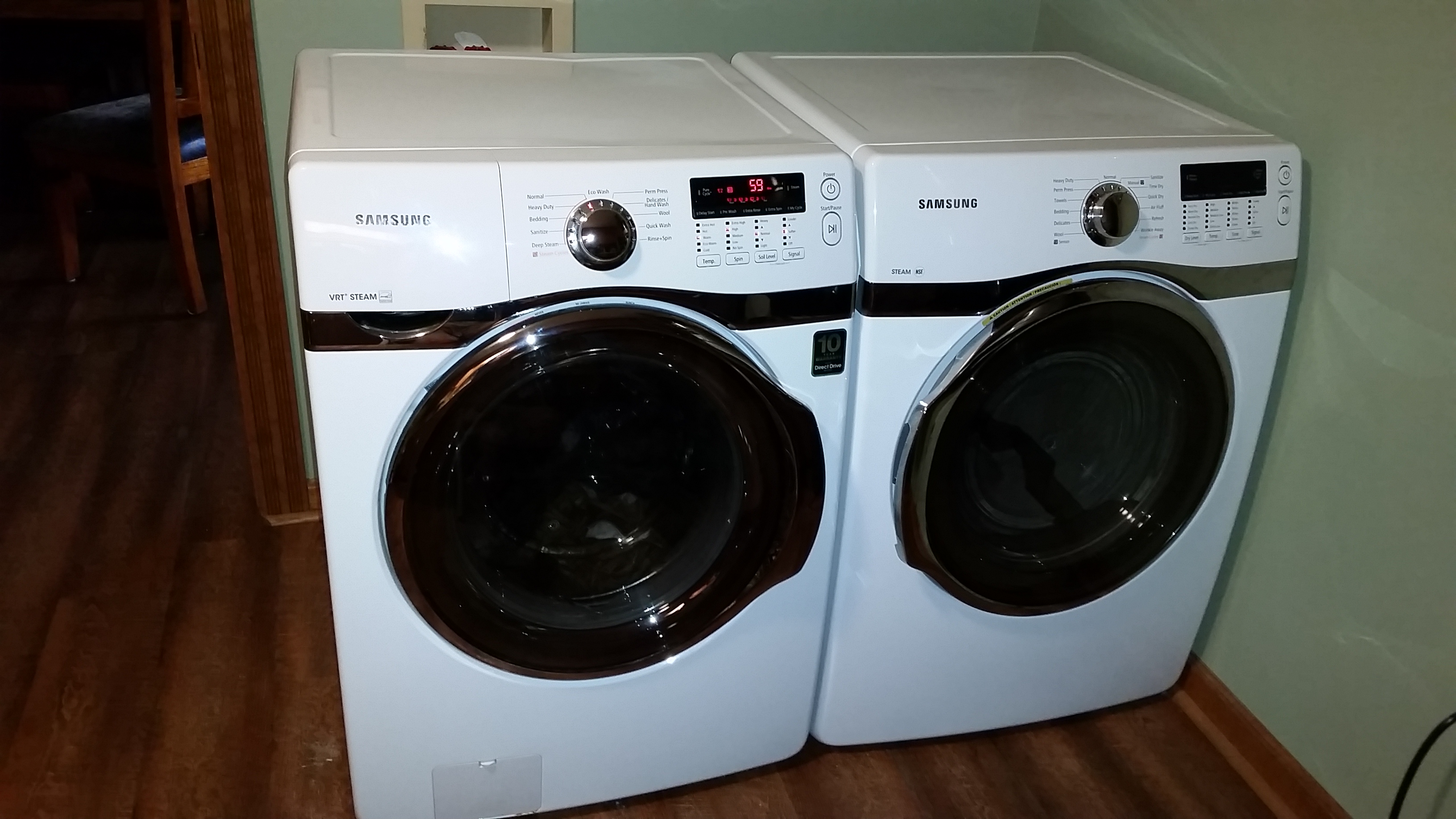

I have a set of Samsung front loading machines. I've been very pleased with them, they do a great job and I've never had an odor issue with the washer. (I leave the door ajar when not in use).
The other day I heard a very load explosion, thought the power transformer blew up. Turns out it was the washer. When I went into the laundry it was shaking pretty bad, thankfully at the end of the spin cycle.
So I called Samsung, they informed me I was 20 days outside of my 5 year extended warranty. Go figure.

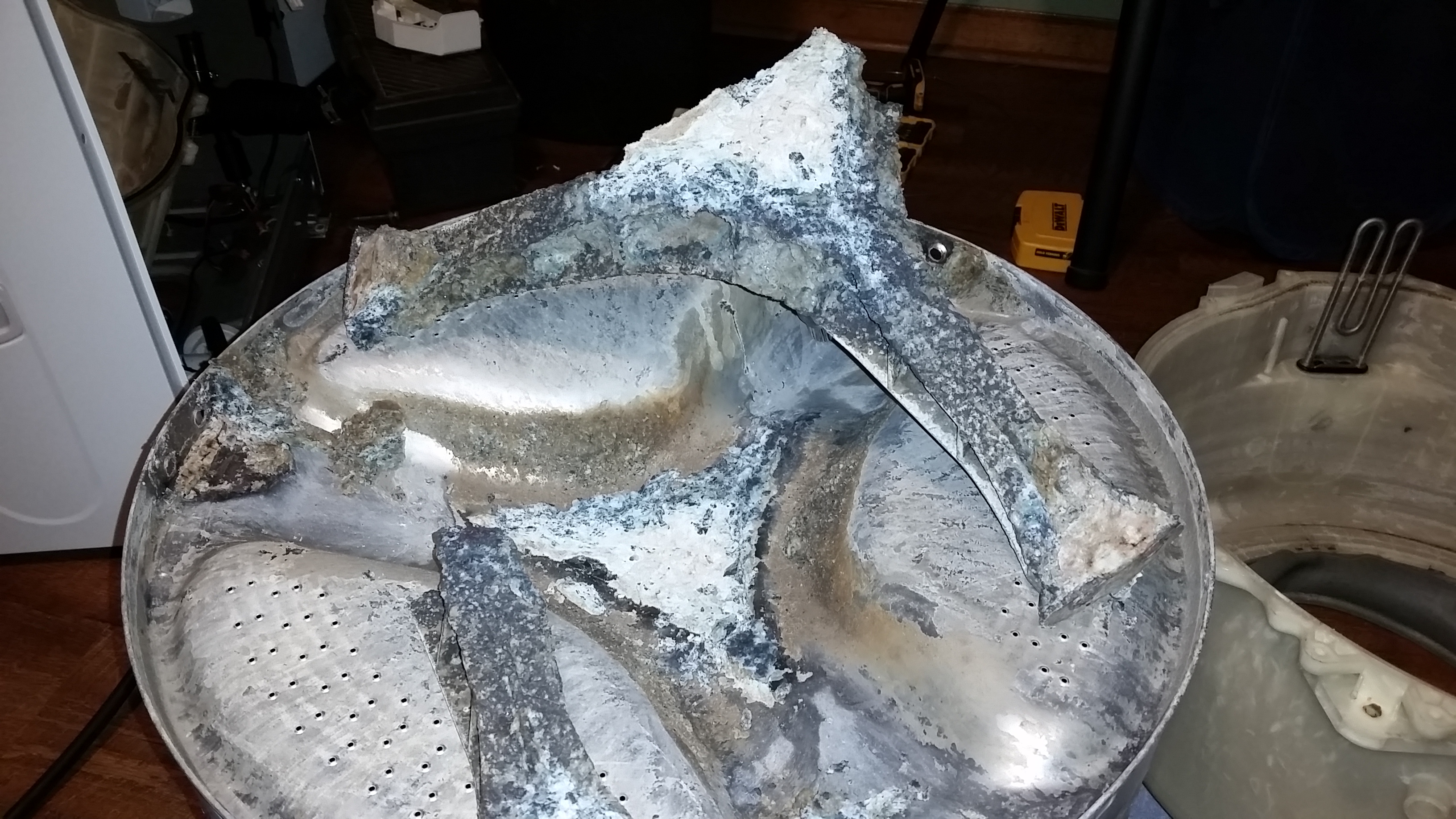

So I decided to fix it myself and started to research.
Long story short, this is a common problem on most front loaders, not just with Samsung.

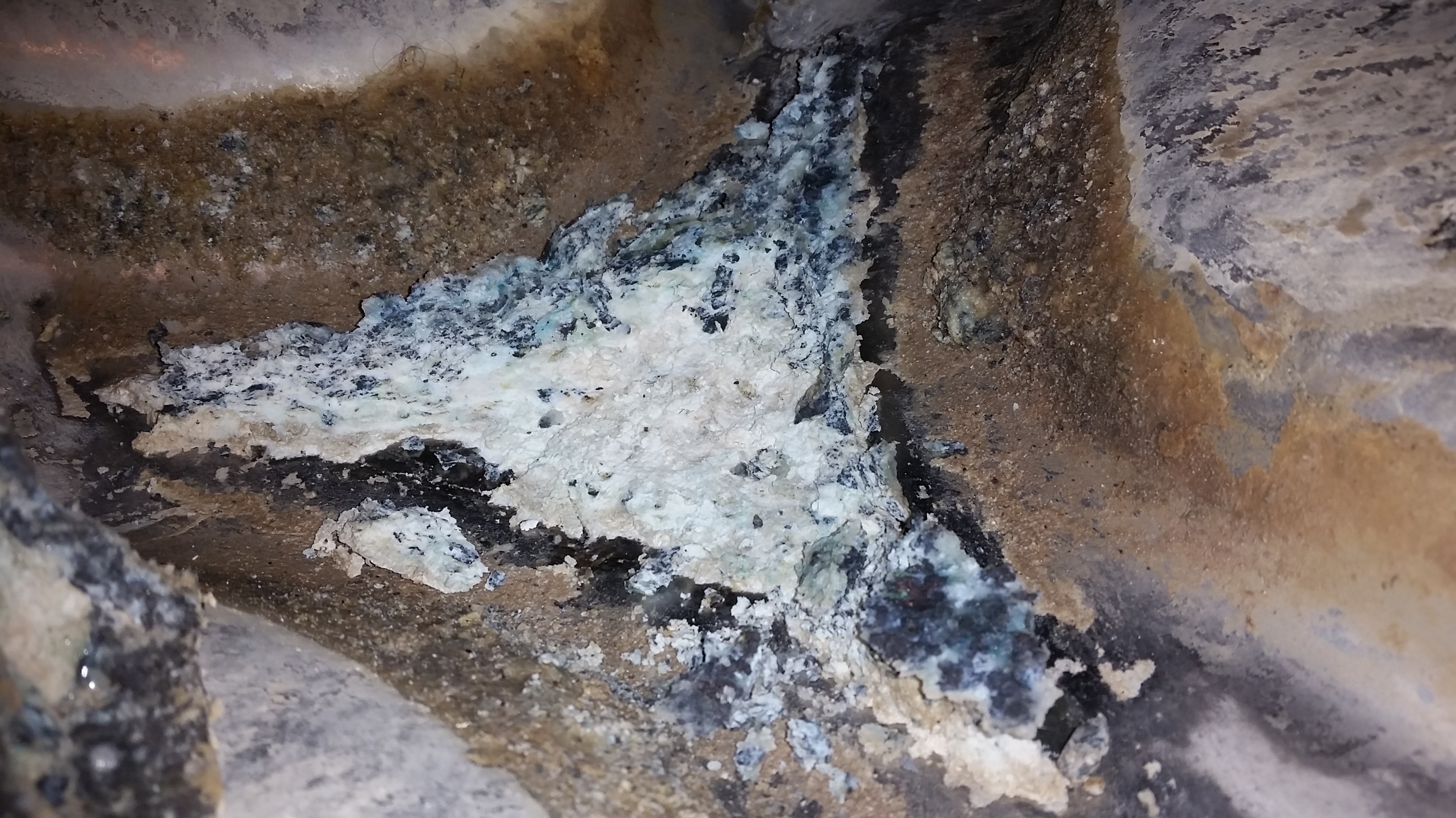

The bracket that connects the drive to the drum (spider bracket) gets caked with detergent and it causes the Aluminum to fail. Some say galvanic corrosion is the issue.
In the course of my research a few tech's posted on a YouTube video that too much detergent is the cause. They recommended ONE TABLESPOON of detergent. I was filling the dispenser to the max line which is 7 TABLESPOONS!!
I had no idea. Turns out 1 tablespoon is plenty, the clothes come out just as fresh as before. These units don't use much water so they don't need much soap. (I use Persil, I get that from WalMart)
The tech's recommended using the clean tub cycle if you have one. They suggested using a cup of vinegar and setting the washer to the hottest cycle. If you have been overdosing on soap like me, you might want to do this once a week for awhile.
My cost was $235.00 for parts. The bracket, 6 new bolts and the rubber boot that goes between the door and the tub.
I have no doubt the cost for them to repair would have been almost as much as a new unit.

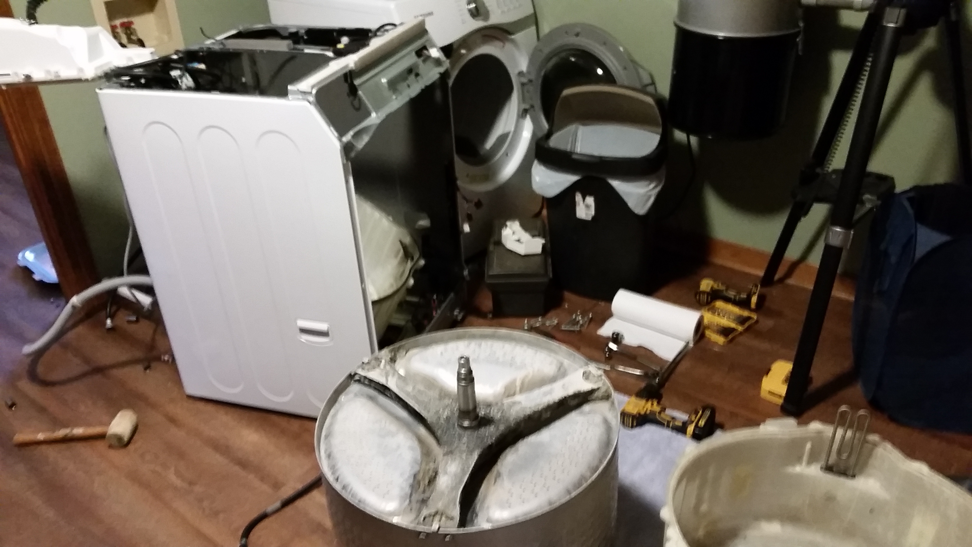

This is the end of the disassembly. For the 1000th time, thanks YouTube!

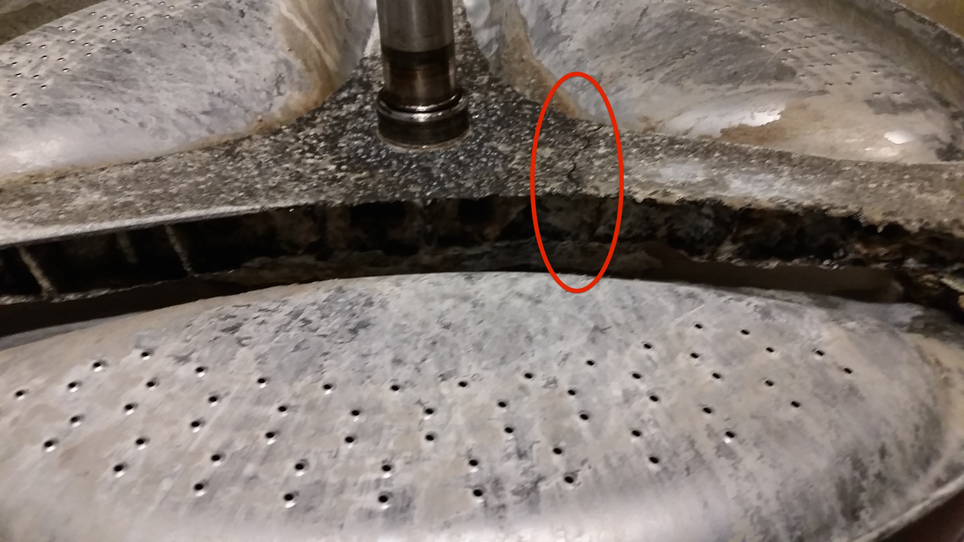

This shows the crack in the spider bracket. Had it broken completely, the machine would have disassembled itself. :laughing:

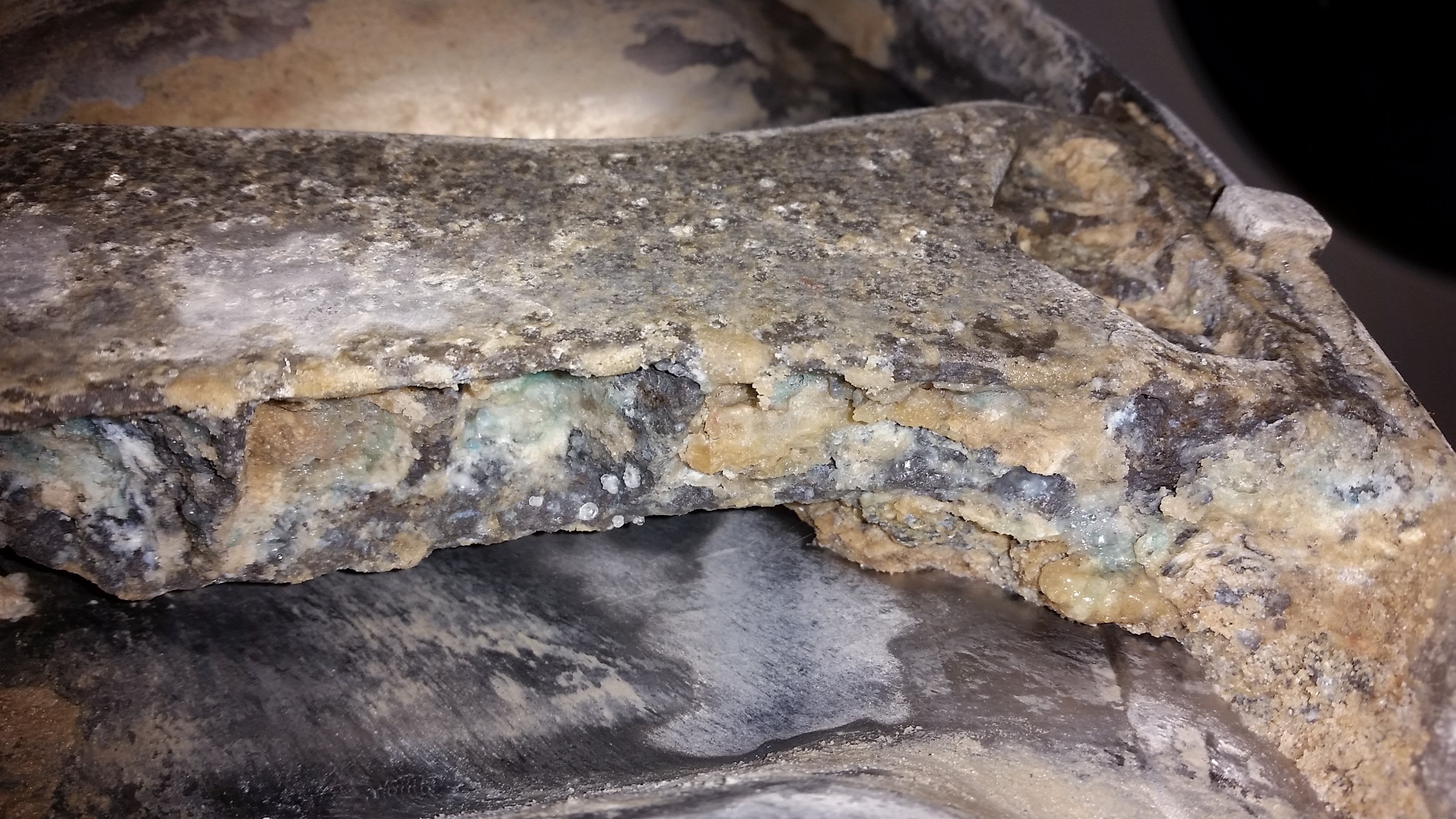

Closeups of caked on detergent.

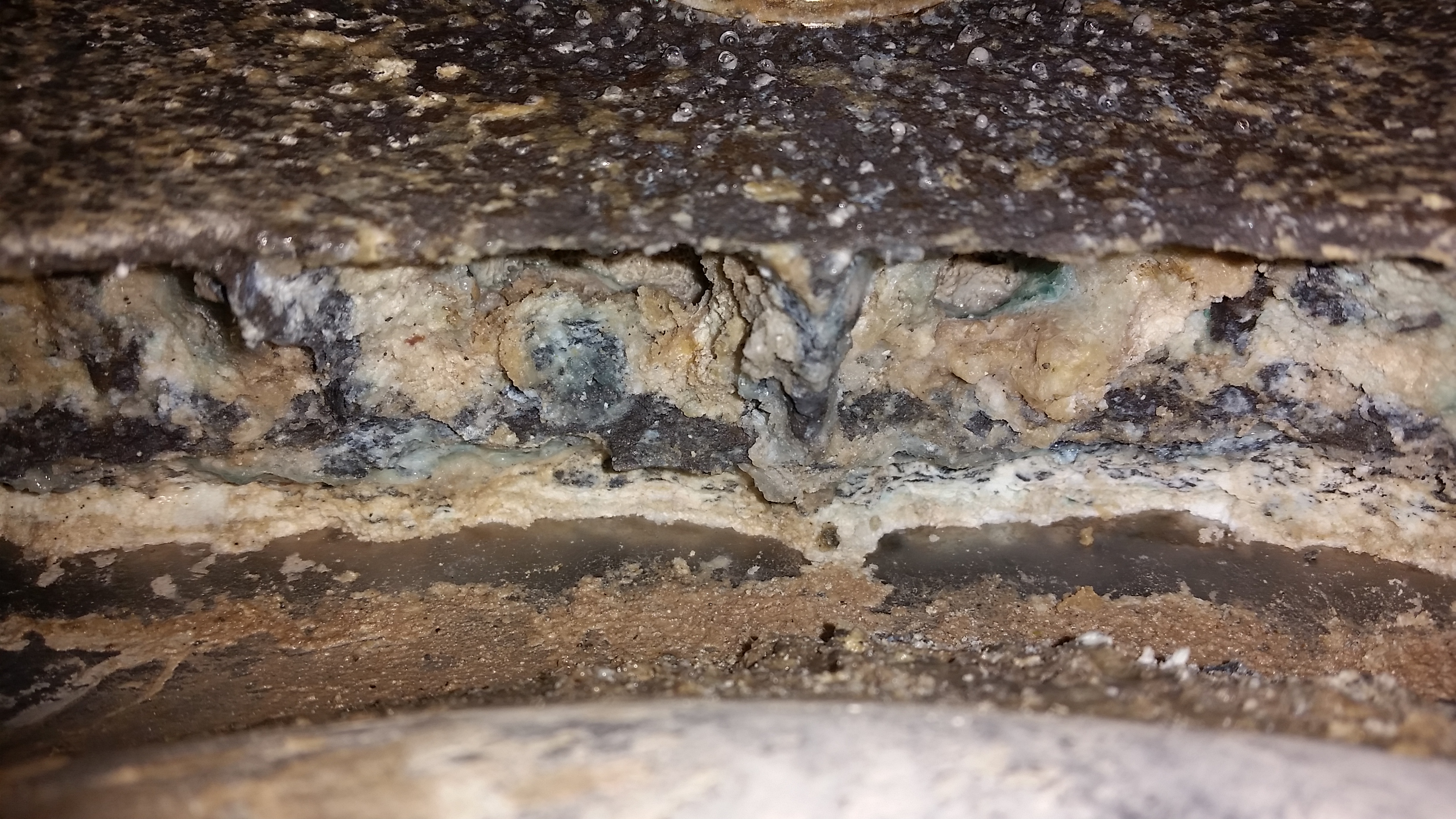

This was under the spider bracket.

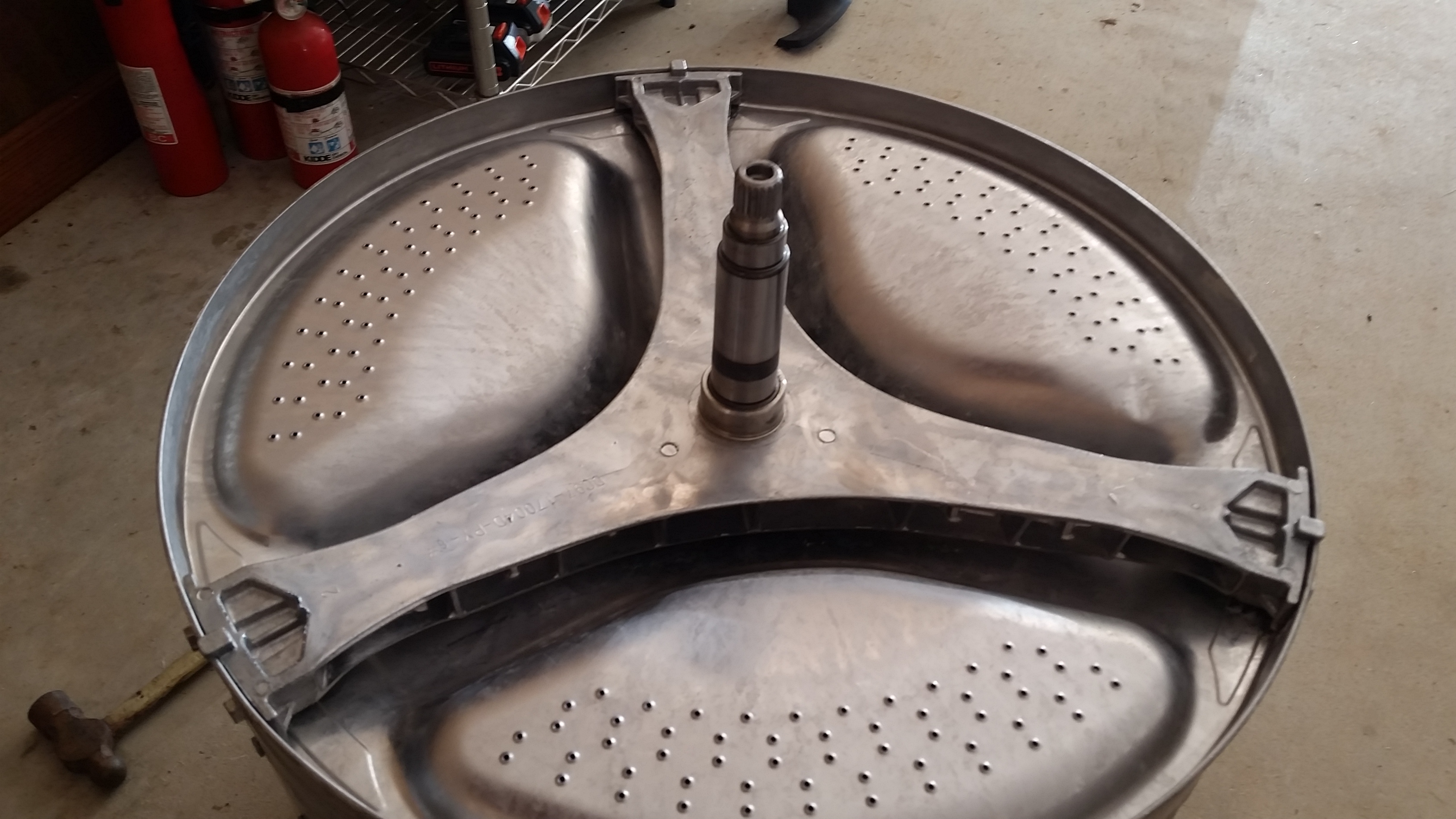

This is after I put the pressure washer on the drum and installed the new bracket.
All done!

The bracket that connects the drive to the drum (spider bracket) gets caked with detergent and it causes the Aluminum to fail. Some say galvanic corrosion is the issue. ...
From the photos, I would guess the problem is not galvanic corrosion but crevice corrosion. Crevice corrosion can happen in Aluminum and Stainless Steel when oxygen is lowered/missing on the metal. Both of these metals need oxygen to prevent corrosion and when the oxygen is missing corrosion can start which is usually in a pit or crevice. It looks like the caked detergent might have caused an oxygen deprived environment so hopefully changing the detergent solves the problem.
