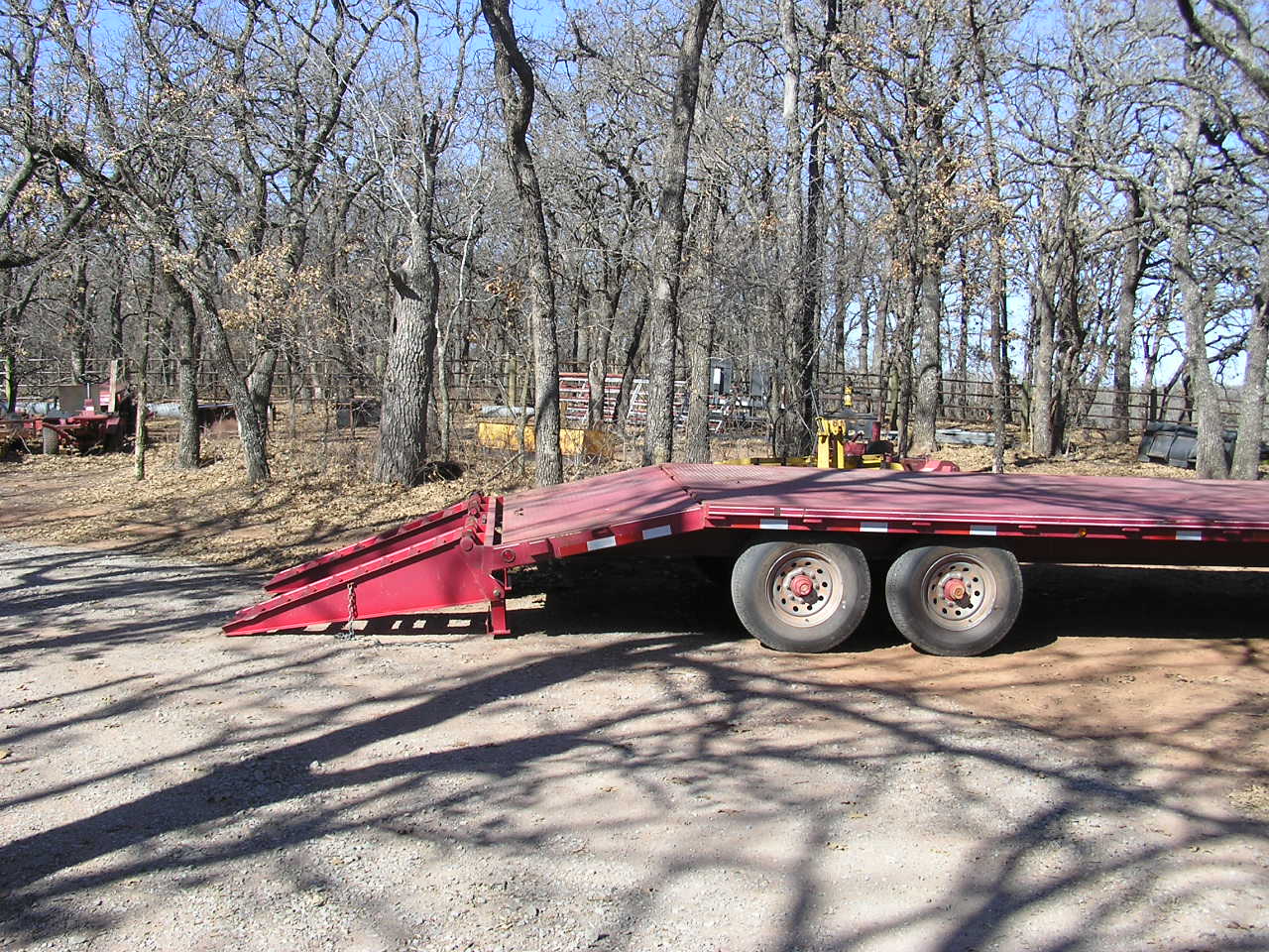

My ramps on my GN usually touch the ground long before anything bad happens if they aren't already into the dirt. This is exactly why I won't own a straight deck trailer with slide in ramps though. If you ever load anything with a decent weight, you have a good chance of picking the truck up off the ground.
