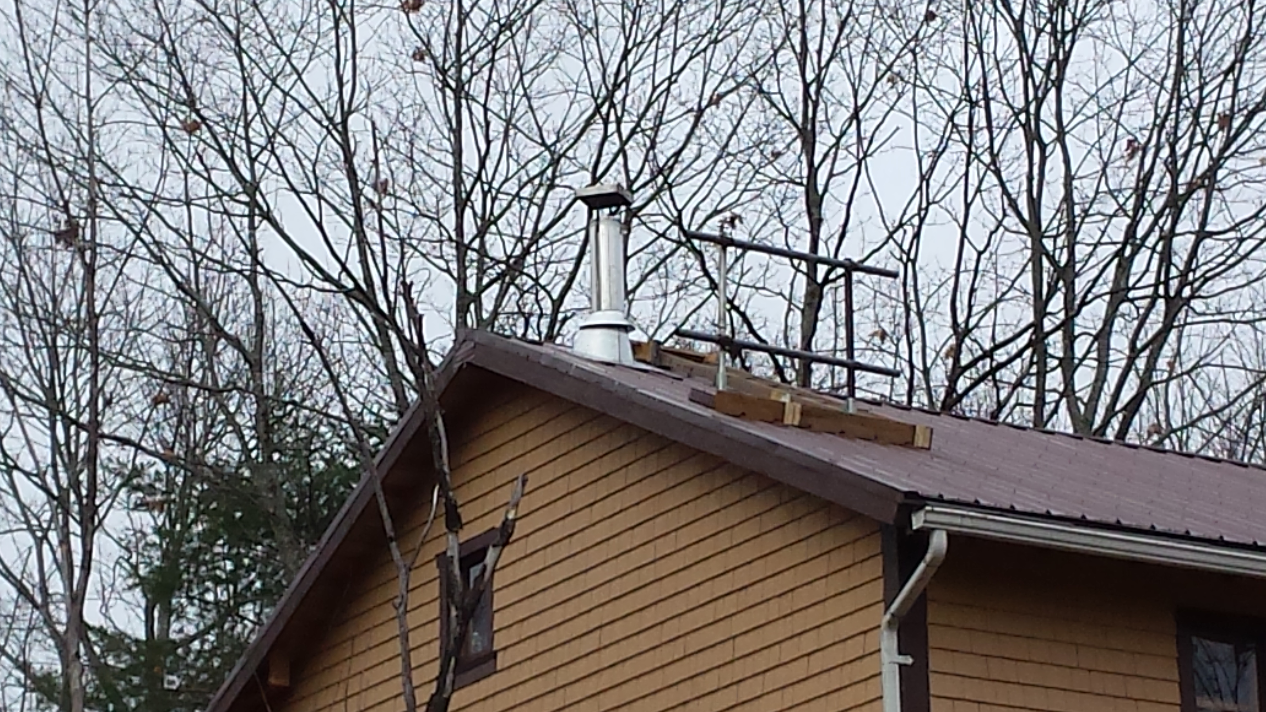

Your chimney should be reasonably close to the peak of the roof since it needs to extend about 3 feet above the peak. If your stove is not near the center of the building, run your pipe up and elbow horizontally under the ceiling (with proper clearances) to get nearer the peak. Chimneys close to the eaves are not good for several reasons.
I'm still thinking of living dangerously and going through the wall. Hate to put a hole in a perfect roof :) I did find this today. Chimney Height: The 2 foot, 1 foot, 3 foot Rule | Ask The Chimney Sweep
Good input here, thanks>"What is the 2 foot, 10 foot, 3 foot rule? This rule indicates that the chimney must be at least 2 feet taller than any structure within 10 feet of it and also at least 3 feet higher than the point at which it penetrates the roof"<<<Guess I have to add a little more length to my pipe, ended up with 28" above peak, pipe center is 16"ish below peak.

I'm scratching my head on this. We get an average snowfall of 6 to 7 feet per year and usually build up a maximum of about 3 feet on the ground. The pole barn roof gets less buildup because of more heating from the sun and it will slide off. My chimney sticks up about 5 feet above the roof surface. I never notice any snow piling up abnormally around it and I've never heard of a chimney affected by snow.
Head&shoulders works for me. I ended up with 5-1/2">>12" pitch on my steel roofing, enough so cant keep 4" of snow on it, like watching it slide off, first winter when it did, it folded back over my screens that cover the roof gutters, had to ladder up and wire those screens down.

My concern is snow accumulation taking out the chimney on the roof. My neighbor down the road had his taken off by snow last winter. He just installed a propane furnace and took the exhaust through the wall. Said he would never go through the roof again. He gave me his wood stove for my new pole barn so now I'm worried about a through the roof chimney. We do get an average of 3-4 foot of snow. Is this a valid concern?
Had to of been chimney pipe installed with Laurel and Hardy skills, cement block wont move. When I get another section on my chimney pipe, I'll add some roof chimney braces, right now the roof flashing cone is supporting my pipe that's 28" above peck, and that is glued and screwed down, I have to hook my tractor on it to pull it down. Snow taking my chimney down, that will be a cold day in hade's.........
