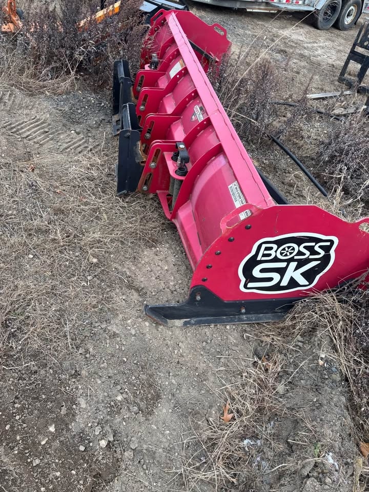

This pusher has a sprung trip edge

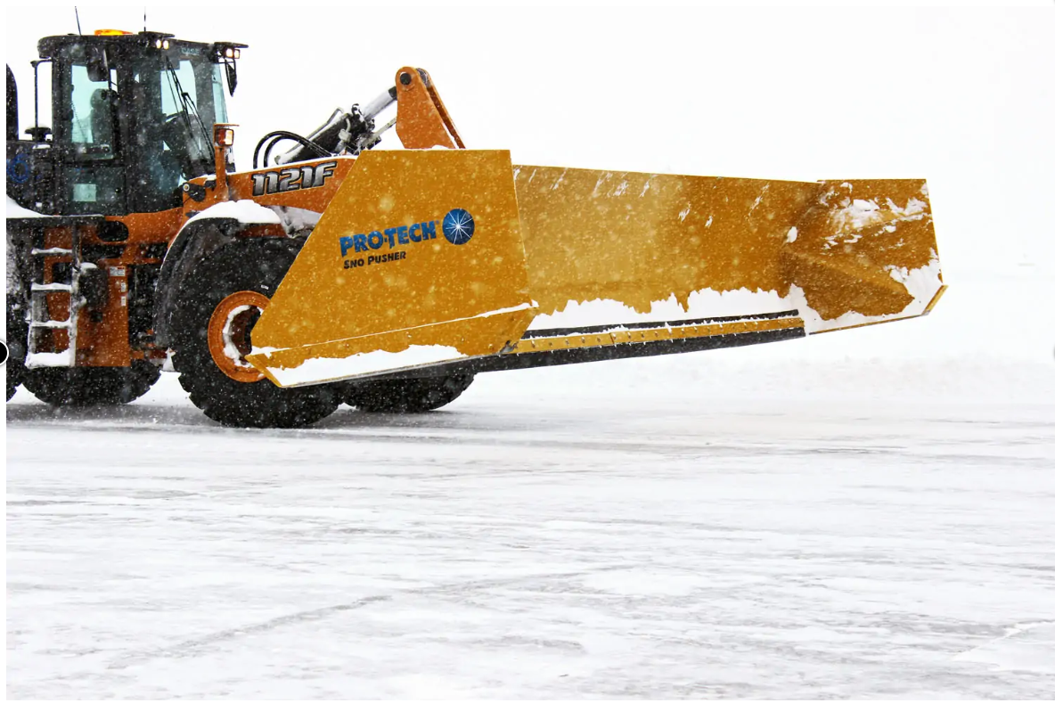

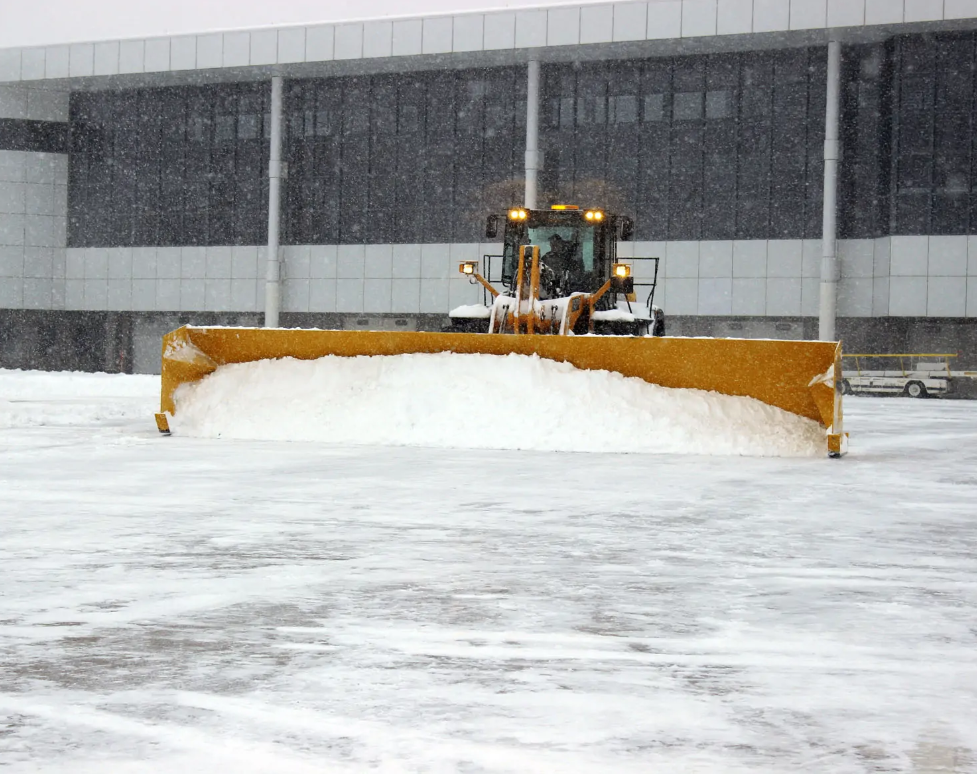

I wonder how they deal with surface obstructions on these monsters:
Looks like it may have a rubber scraper
They're mostly used on airport runways though, which don't have a lot of rough surfaces.
I'd hate to see what would happen if it hit a solid object on one side. If the surface were slick enough, hopefully it would just spin the loader around. Otherwise, some serious (and expensive) damage would occur.

Thats got a float position. It would just hop over it.
   / Do snow pushers fetch up on frozen rocks? #15
Probably would if it's small enough. I'm thinking of a pipe sticking up a foot or more that's solid enough to not just shear off. Hitting something like that on one side would cause major damage
