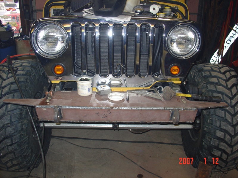

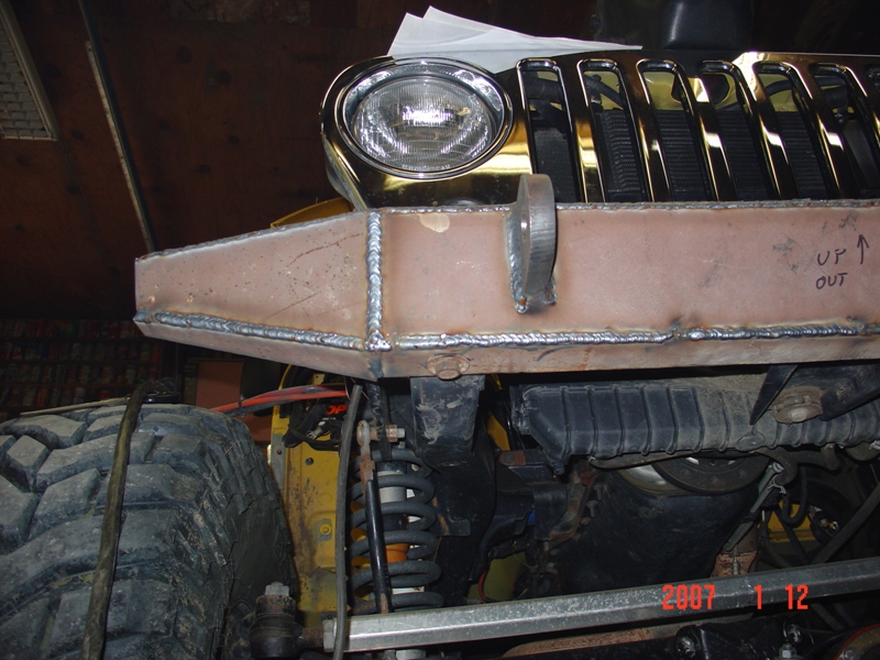

Rob,
I'm kinda surprised you don't have a Plasma Cutter. A man of your talent would certainly enjoy one. Using a guide you can cut a line amazingly smooth. Reguires a lot less grinding and best of all minimizes metal heat. All that's required is a good clean air supply. Consumables are minimal. I use a Miller 625. I think I paid around $1400. It's awesome on anything 3/8 thickness and under. Will cut thicker but slows down to get a clean cut. I don't have any pics of anything tractor oriented but here's a few of a Jeep bumper I cut from flat steel. I rarely use my OA torch anymore and probably burn more fuel thru it lighting the shop wood stove in winter than anything else. :)
Edit: Forgot to mention, consumables are extremely cheap!!!! I've used my cutter a LOT. I've replaced several tips and other consumables in the gun and haven't spent $50 yet.

Terrific bumper fabrication. Of course we'll have to take your word that a plasma cutter was involved.
That it the difficulty I have. Not much in the way of cut edges to show off.
Pat
