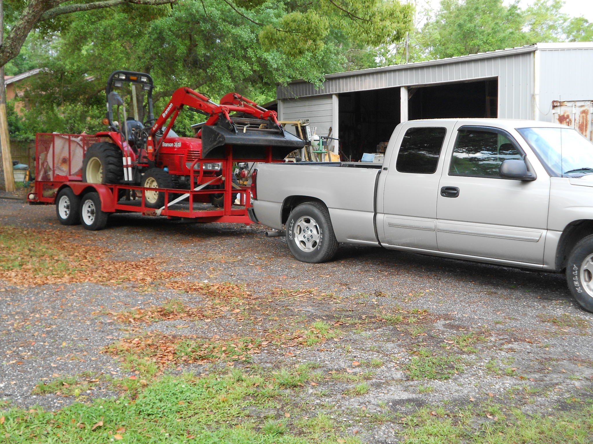

Even brakes on one axle makes a huge difference!
I always test my brakes when I hook up because I set them different when loaded or empty.
My Reese Controller has manual application lever, amount of braking pressure adjustment and slow-to fast application adjustment.
It really does feel a lot safer towing with the brakes.
This trailer has all 4 wheel brakes on it.
