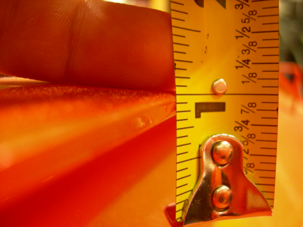

I've been looking at different grapples and I like The Thumb. The top edge of my bucket(50" LA354) appears to be to thin to handle this under loads imo. What kinds of solutions would be in order? Or will it be ok as is?

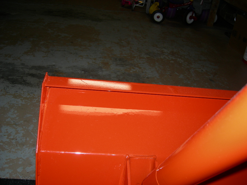

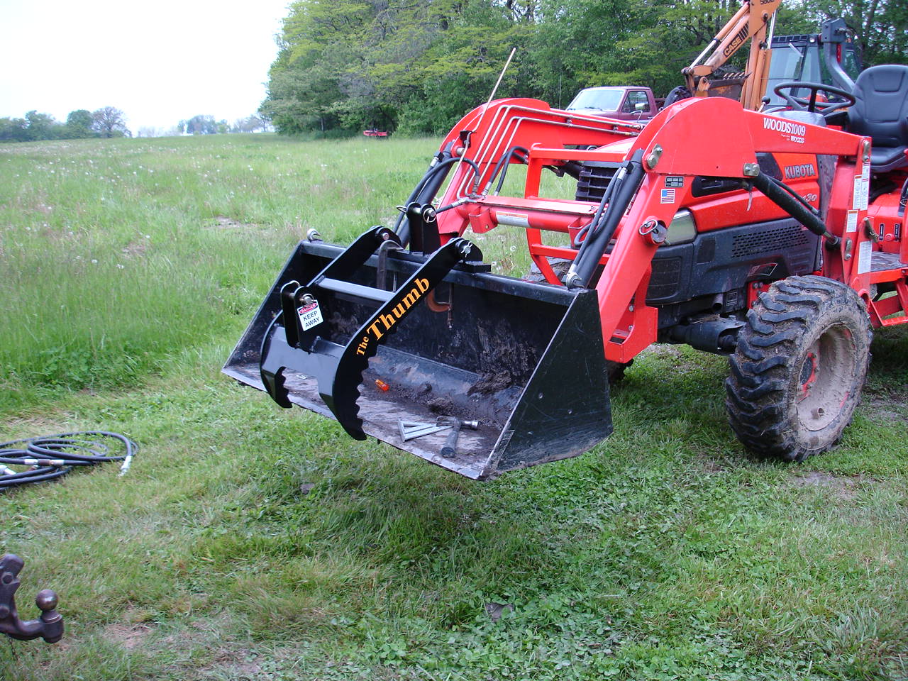

Here is a couple of pics. After looking at it again I think I certainly need it reinforced. I was drawn mostly to the thumb for the price and the fact I could buy it direct. $339 + shipping. I would still have to make some hoses and pay for material, someone to weld it up and paint.

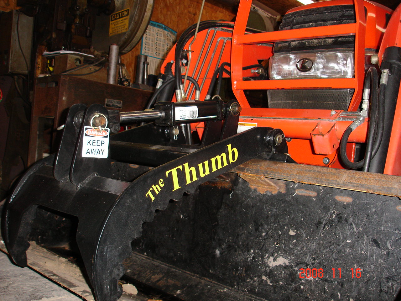

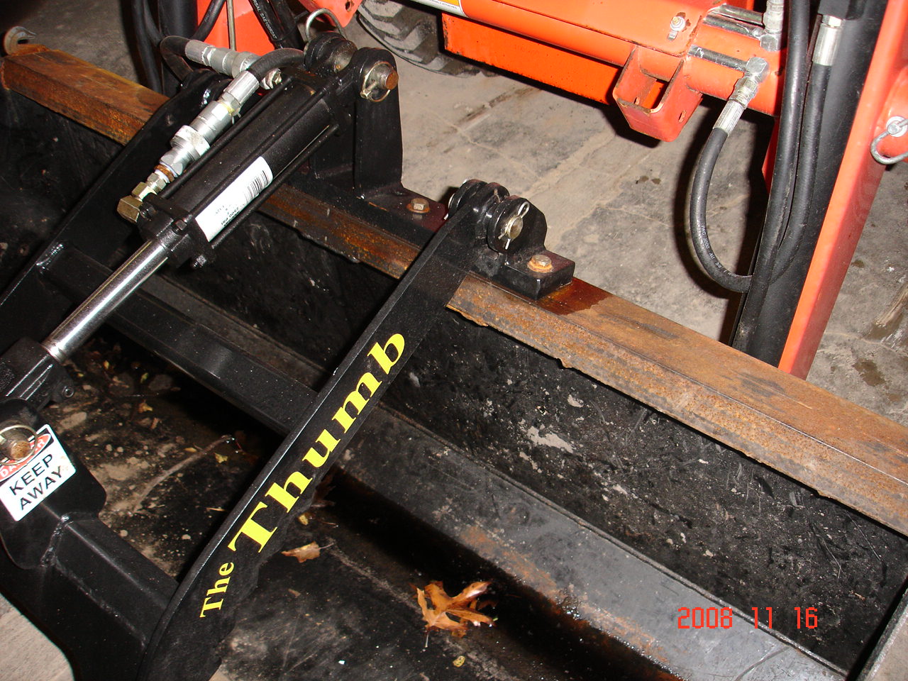

you can reinforce the top of your bucket like this.
Tim
/ Do I need reinforcement for "the thumb" #7

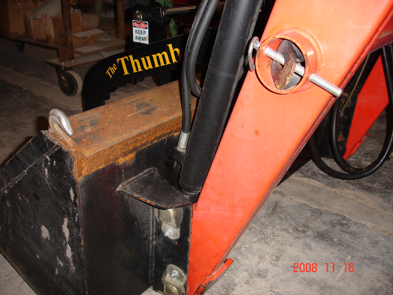

I have the 'THUMB' on my BX23 48" wide bucket. I reinforced the top of the bucket with a 2" x 3" x 1/4" angle, full width. It is holding up very well, no deflection of the bucket at all. I welded nuts to the underneath side of the angle before welding the angle to the bucket. This allows me to easley remove the thumb when it is not needed. I also added 5/16" grab hooks to each end of the angle iron.

I got the Thumb, great product, I twisted the crap out of my woods bucket!
I had to rework the bucket a bunch.
Sounds like your reinforcement is like the pic Hvytrkmech posted just above your post?

I have no idea what the price difference is in the claws you are looking at, but the reinforcement cost me 20 bucks to do it myself. Food for thought maybe.

I've need to reinforce the upper edge - and often the lower as well - of every bucket we've had. That's about a dozen so far. You have to do it anyway for mounting a grab hook and will certainly want that. Adding a grab hook or three is the single best thing you can do to make a bucket more usable. IMHO, a removeable tooth bar is the second thing. I've never used a loader grapple, but wouldn't be without the backhoe thumb. Reinforcing your loader bucket edges is lots easier, cheaper, and better looking if you do it before you bend the bucket....and you will. Best is to have your local welder do it. HvytrkMech's method looks good. Make it strong. Use high tensile alloy steel for reinforcement instead of hot rolled if you can get it. I've also used plate, interrupted angle (good for access), and heavy wall pipe.

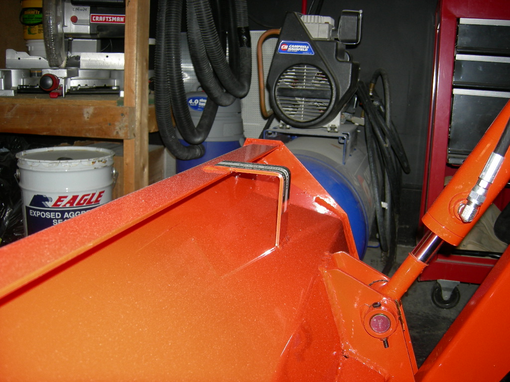

High strength steel is a very good idea.
I had this steel so thats what I used . Don't look at the welds, was in a bad mood and had to get it done fast.
Two pieces of angle, with three straps under to back of bucket where the angle iron attaches.

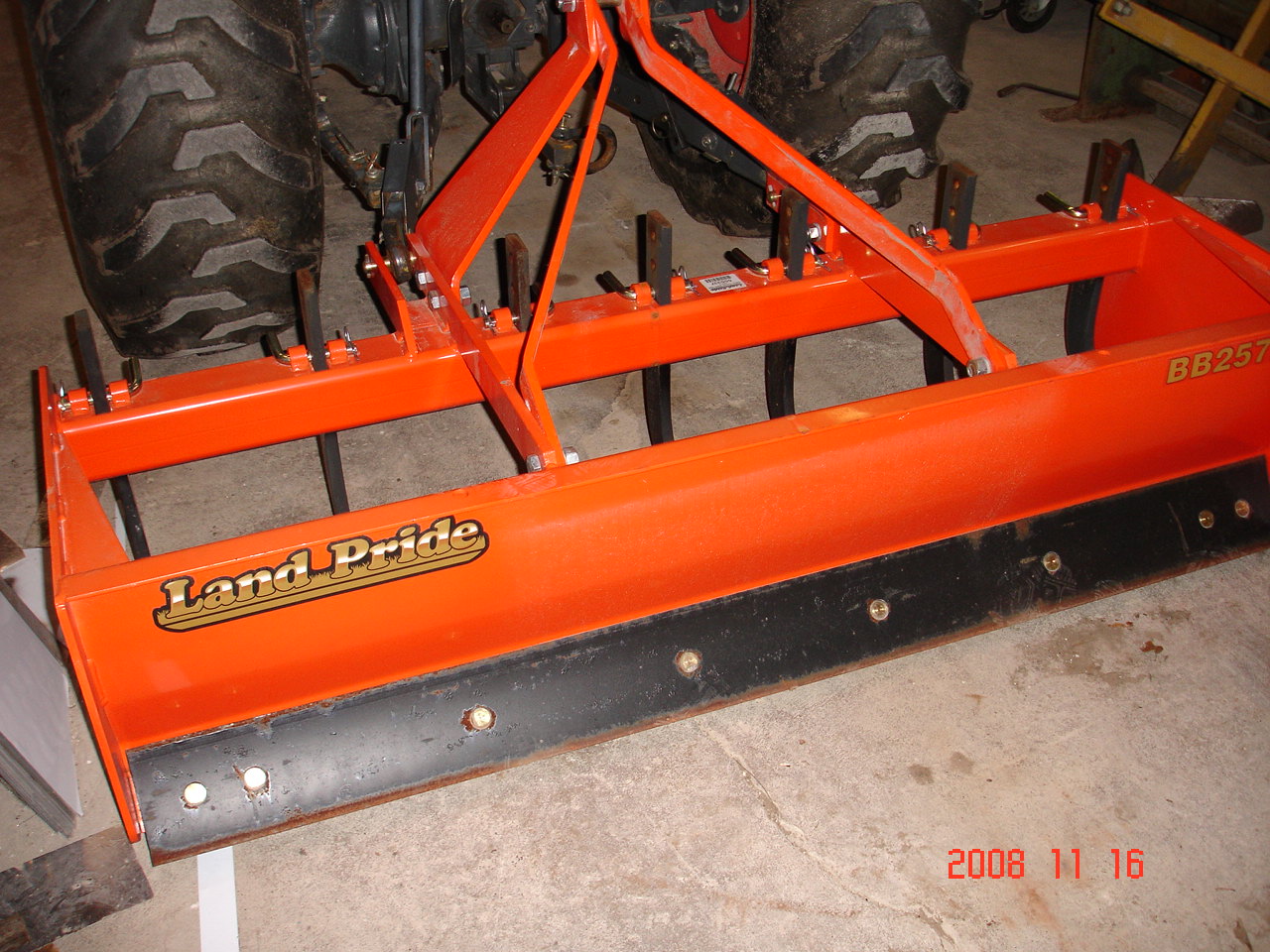

Also a pic of my new Land Pride box scraper, guess they are tied to Kubota Dealers, so you get the Kubota orange.
